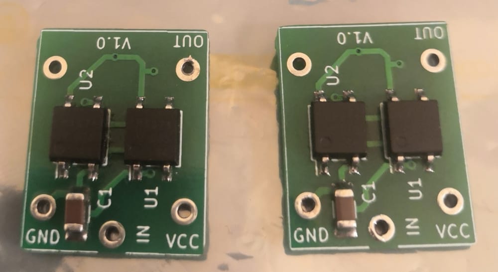

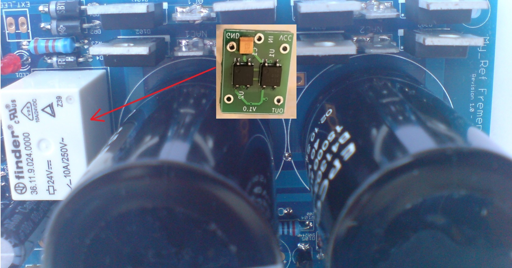

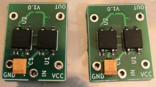

Finally, got the MOSFET SSR PCBs today, I assembled a couple and tested them, they are working fine 😀 tomorrow going to replace Finder relays in my My_Ref Fremen Edition LM3886, it will be a busy day!

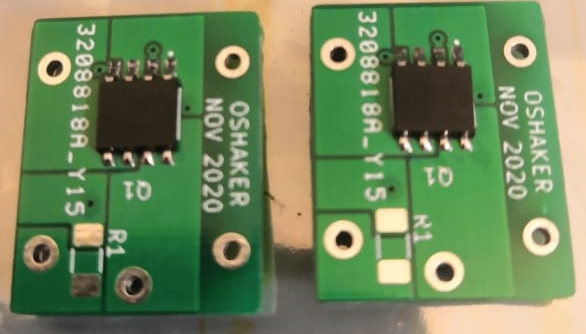

Thank you for the warm comments. Actually, without the advice of minek123 who is wise/practical, Mooly who is patient/literate, and Michael Bean who is experienced, this would not have been possible because I had no previous experience with such MOSFET implementation.

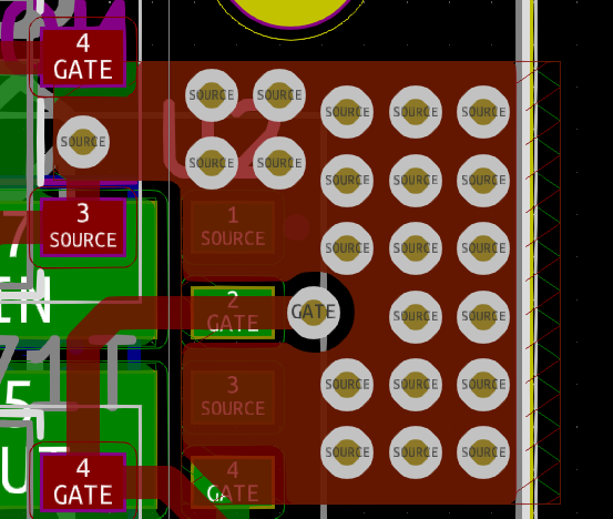

I have been refining the PCB in order to support 8.0A instead of 4.0A for a temperature rise of 8~10°C in copper temperature, I assume the latter is acceptable.
Duplicating the zone connecting the two SOURCE pins of the MOSFET enables higher current support, shifting the MOSFET to the left also allows for a larger zone as well, frankly more than 8.0A. The final PCB design is somewhat different compared to the prototypes, anyway, it doesn't really matter to me as I don't need higher current support for the LM3886.
Final prototypes assembly photo is attached, I salvaged those capacitors from an obsolete Aruba wireless controller 😀 Couldn't find better use of the board!
I have not decided whether I will publish the Gerbers for the public, or go for a group buy, may be it is too early to go for a group buy at the moment.
