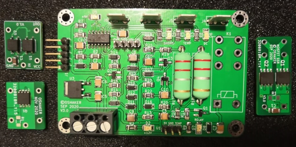

You’re (or anyone else) are welcome to the Gerbers - just download and use as you see fit.
Could someone point me to Eagle libraries ( I am on ver 7.7) for
the BUK9K29-100 and the VOM1271 ? TIA!

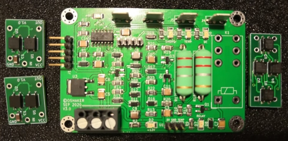

Here´s a more modern version:
Ready-to-Run (RTR) SSR DC Speaker Protection and Delay GB

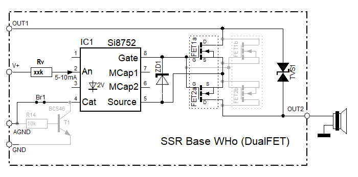

Thanks a lot for your explanations! Sorry for a maybe naive question:
The power supply rails of the Amp are symmetric +40V / -40V against Ground (Gnd connects to the speaker). BTW: I do have a DC protection mechanism in place at the Amp Output, and the Amp does not drive a passive XO. So, even if one supply rail is shorted to the Output, my understanding is that the MOSFET would see either + or - 40V Vds. So I guess I don't understand how the 60V Vdsmax may be insufficient in the design.

Hi wgh52, when a SSR disconnects a loudspeaker, a load far from pure resistive, the outer end of the SSR that the non-ground terminal of the loudspeaker connects to will not just go to ground potential and sit there. Instead, at the moment of current interruption, the back EMF often instantly kicks that terminal beyond ground potential towards the opposite power rail. This is the same back EMF mechanism, but perhaps to a lesser extent, that a relay coil when not fitted with a clamping diode can subject the driving transistor many times the supply voltage.
In post#674 I explained how people use a bi-directional TVS to protect SSR when the power rails are not close by, therefore, clamping diode protection is not a first choice. In TVS protection scheme, because the SSR never sees a voltage greater than the breakdown voltage of the TVS, by selecting a TVS that breaks down at the power rail voltage or thereabout, the VDSS requirement of a MOSFET is halfed.
the TVS protection is a smart design, but because it involves the output stage of the amplifier in the event of protection, I'm not sure it would work in all scenarios with all output stage topologies. So far clamping to power rails remains my choice of protection.
Thank you for the explanation nattawa. I am wondering how much current could to pass thru this TVS, can this be expectable or calculated.

As in my case the -40V Supplyrail is not nearby/available, I'm including a 58V TVS device across D-S-S-D connection of the 60V Vdsmax MOSFETs on the SSR module (being a 20x31mm piggy-back board on the existing Amp). My SSR module features an "Enable/V+" Input to supply 5mA into the Si8752 MOSFET driver, which is derived e.g. from the +40V Amp-Rail through a DC detection circuitry and a resistor. The Si8752 AGND pin connects to another switching transistor being controlled by the (existing) "power on/off" and "AC lost" muting circuitry. So the "high active - no DC" sensor output and the high active "unmute" are effectively AND gating the Si8752/SSR activation/deactivation.

@ metal, Hi! I don't have a model to predict that. But I would hazard a guesstimation that it would not be as large as the driving current at the moment of SSR cutoff, given the lossiness of the equivalent reactance of the loudspeaker system and the limited amount of kinetic energy storage within the driver unit's suspension system. We often see 1N4004 being used as clamping diode at output stage in amplifiers capable of 150W and higher, and that speaks a lot.

Your SSR module sounds like a feature rich design. I wish everything works out well for you. As far as the TVS selection goes I hope you not be annoyed by my opinion. When they spec a TVS as 58V, they often mean it will hold up against 58V, not breaking down but sort of on verge, the voltage that it really breaks down and conducts, or avalanche, is usually a few volts higher. Since your MOSFET has a 60V VDSmax, perhaps a slightly lower voltage rating TVS better suits your MOSFETs.

I see, I am lucky you mentioned this, then for a 100V MOSFET, I better use SMAJ90CA instead of SMAJ100CA.
@nattawa
Thanks for everything, I'll use a margin of safety based on the datasheet when selecting the TVS device

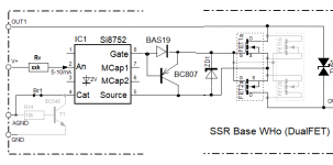

When looking at my parts depot another idea appeared to me as I do have a bunch of dual-NMOSFET devices with Rdson ~ 6mOhms & Vdsmax 90V in my drawer: What about connecting two double-FET devices in parallel per the attached schematic in order to lower the effective Rdson? This would be a handy because my PCB allows top and bottom FET mounting.

...... What about connecting two double-FET devices in parallel per the attached schematic in order to lower the effective Rdson? This would be a handy because my PCB allows top and bottom FET mounting.

That will work.

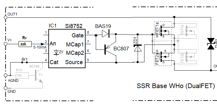

As of the Si8752, I noticed in the datasheet the turn on/off time of the gate drive is specified with a gate capacitance of 100pf. In our application the gate capacitance is far greater, so the turning on/off is not even remotely that fast. Not saying that would definitely be a concern, yet if possible, better get it simulated to see if the FETs are exposed to excessive power dissipation during turn on/off with load current. The SO-8 SMD package has a lot smaller thermal mass than bigger packages, might worth a close look at the odds.
If concerned, an additional diode and a PNP transistor can help greatly shorten the turn-off, not much can be done to help the turn-on though.
