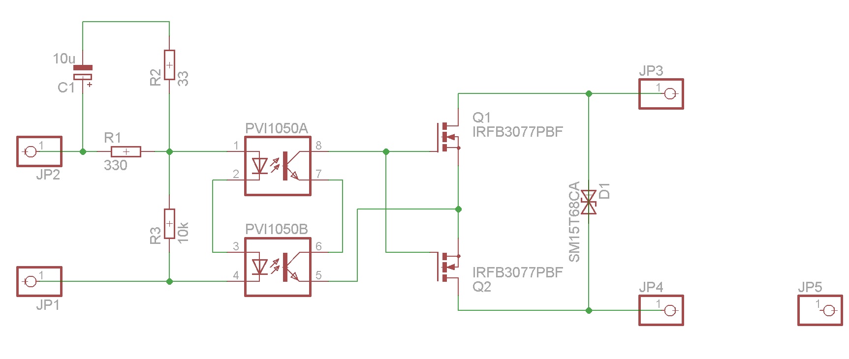

optocoupler output voltage (measured) is 7.5V@ 20mA, according datasheet IPI076N15N5 Rdson is 7mOhm@7V, measured value is 8-9 mOhm, I think it is quite good
Would go for series to speed things up and use ( see attached ) C1 ( reverse polarity) and R2 parallel to R7,8 and 9 ( is my R1) and calculate my R2 to limit max current to 70 mA or so . ( 80mA is Ic limit)
My circuit switches on in less than a mSec as I recall but have to look that up .

Hello, this is my first try to build a protection circuit by using solid state relay. I'm satisfied almost with all parameters but ON switch time is too slow due to LED circuit. If one does not plan to switch ON under heavy load everthing is superb. Question is, how to SPEED UP the circuit
- usable for 100-200W@4R amplifiers (one module per channel)
- resistance slightly less then 20 mOhm
- SSR ON time aprox 15 ms
- SSR OFF time aprox 5 us
- delay between overload detection and SSR OFF aprox 380us
See measurements
https://goo.gl/photos/3vb1LmGzPsKVRdWw9
I found out what causes SSR slow turn on. It is time delay provided by R6-C5 on pin 7. If I bypass R6, switch ON time is much faster.

Hi Bonsai, my SX amplifier still unprotectedI get <100 microseconds from the edge of the overcurrent step (which is > 60 Amps) to the mosfets switching OFF.
I am using a 2N7002 to switch the photo-couplers. The LED current is 12mA.
Can you share a generic mosfet based protection circuit suitable for this?
If Shhh its me moves the SS relay into the Return route, can the voltage rating of the mosFETs be lowered to: rail to ground plus a bit of spare?You must use a mosfet rated at twice the maximum rail voltage. so if your WORST CASE supply rails are +- 70V, you need to use a 150V mosfet.
Anything less than 10 milli-Ohm and >200 milli-joules should suffice. See ON (Fairchild), Toshiba.
Found suitable rated device: IRFB4115PbF

I don't think you can use a reed relay, or any other types of relay, to switch the MOSFET without involving an extra isolated voltage supply, one per channel. Bear in mind this supply rides over the amp output, so you want to keep it small as possible in parasitic parameters, where a photo-voltaic driver is the best suited in this regard.
You can get away with lower Vds rating devices - I am assuming the switch in this case is on the hot side of the speaker in which case you need the Vds rating as I described earlier.
Return switching is easy but if you short the return to chassis, you do not have the switch in circuit - I noted this in the nx-Amp write up - so you need to assess the risk in your particular application.
Indeed - that's why the photo-opto is the best solution for driving the mosfets for live side speaker switching.
Yes, now modified layout to use PV driver.
