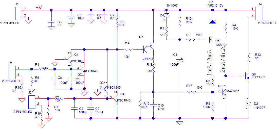

I'd suggest that you consider the circuit used in the "Speaker Turn On Delay and DC Protector Board Set (V3)". Even if you don't want to use the PCB, you could still benefit from the fact that by now the circuit should have been thoroughly debugged.
http://www.diyaudio.com/forums/diya...ker-turn-delay-dc-protector-board-set-v3.html
The circuit is shown in post #5 of that thread, and C3 in that circuit performs the same function as my C4.
Personally, I would also replace the mechanical relay in that circuit, with a solid state relay - which is, after all, the subject of this thread.
I feel even better of my design after looking at this. The frontend Q5 and Q6 is exactly the same as mine. Mine is better. That circuit use Q3 as emitter follower which has no voltage gain. Q3 drive directly to Q4 which is the relay driver already. The problem is worst on the -ve failure that Q5 is common base like mine. No gain from Q3 and drive Q4. This only has a single stage voltage gain of Q4. there is a big uncertainty window where the output can wander around. this is not even a good circuit. The circuit is very slow if the fault is only 1V DC. You need a lot of gain to speed it up once it crosses the threshold of 0.7V.
So far, yours the only one that I consider good. Just because someone actually selling does not mean it's good. You have to analyze the circuit, not just because others are selling it. This is DIY, the fun is designing it. Understanding it and take the best.
Your C4 is not the same as C3 in this circuit. C3 is for power up delay. C3 charge up slowly and it's not until the output of Q3 goes above the zener voltage of D2 that it turn on Q4 to power the relay. It is not for de-spike that junction.

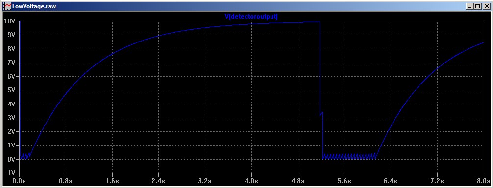

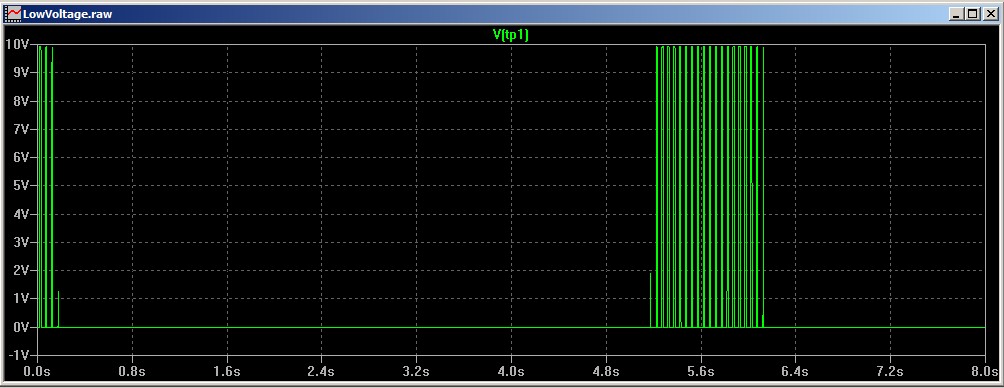

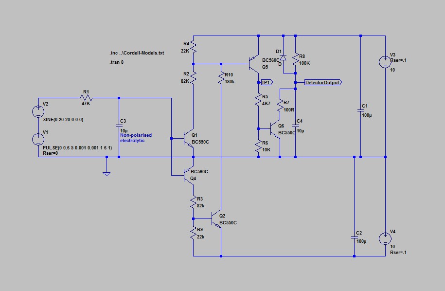

This illustrates the purpose of my C4 - it prevents the pulses from reaching the output.
In the attached sim of my circuit, I have adjusted the input voltage to be in the critical region where the detector generates pulses. You can see the pulses from the detector on "TP1", they have the same frequency as the sine wave in the input signal (20Hz). However the circuit around C4 prevents the 20Hz pulses from reaching the "DetectorOutput".
In the sim, the DC error is applied at 5 seconds, and removed 1 second later.
The attached images are: 1) the schematic, 2) the pulses on "TP1", 3) the signal at "DetectorOutput" where the pulses have been suppressed by C4. I'm also attaching the .asc and the referenced file containing Bob Cordell's models (this is available from his website).

I see what you are trying to show. I gave it a lot of thoughts. Basically, what you want is once it triggered, C4 will slow down the recovery. the 20V sine wave will to toggle the output back and fore.
I even changed my circuit to have that so once the circuit pull low, it will have a dead time before it can recover, so any frequency driving will be less likely to create oscillation like at the output.
BUT, this is a man made assumption. In real world, there won't be an offset of 0.6V if the amp is working. If you have fault condition that it has 0.6V DC, nothing will burn if the output is chopping off like this.
So it sounds funny, so what. More noticeable for you to stop and fix it!! It won't hurt the speaker. It might be even a good thing!!! So you know right away and take care of it before more things get burned.
Remember, this is a speaker protection, protecting the speaker from burning. People can come up with all different scenarios and make the circuit much more complicated. But the bottom line is whether it can protect the speaker.
I likely put in this feature for the hell of it. But I really don't think it's necessary. Attached is the .asc files, you can use the model I posted before, or just any Cordell's library. They are all there.

If you're using a solid state relay, then I agree the feature is not necessary, but if the relay is mechanical, and the relay chatters when the circuit is on the verge of triggering, this might increase the risk of the contacts welding together - as they could be carrying a high current at the time.
Don't add the feature unless you want it - my only motive was that you should understand the issue - and clearly you do.
Thanks for posting the .asc file, it all looks good to me - I can't see any problems.

Thanks for your time too. I am putting it in even though it increase the pcb size a little and might cost a little more. Yes, I already designed the SS relay into the OPS board( I separated OPS from IPS/VAS for convenience of changing configuration), I never thought about the mechanical relay contact at all, I never consider chattering issue. That makes the whole world of sense to have that for mechanical relay.

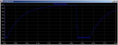

Even though it's not necessary, but your concern have a valid point, so, in it is!!! Since I posted the .asc, I looked for the PNP for that as the KSA992 cannot handle the large current of discharging the cap. I decided to use the ZTX704 PNP darlington404 | DigiKey, I since added another KSA992 into the simulation. It is even slightly better.
Attached is the .asc file with the original and the darlington modification. If you play around with the two signal generators like what you did, you'll find the darlington work slightly better with less chatter at the lower fault signal end. Also attached is my final schematic of my pcb.
Yes, I hadn't noticed, it's too much current for the KSA992. An alternative to using the darlington, would be to tweak the resistor values. Increasing R31 to 1K would reduce the current to about 40mA and be within KSA992's ability. Also increasing R20 to 47K, would increase the discharge time-constant, and ensure that (with a 10Hz input), C8 still has 20-25V on it when the next pulse comes along - thus ensuring Q10 is always held on between the pulses. But there's lots of way to do it, and it really comes down to personal preference.
