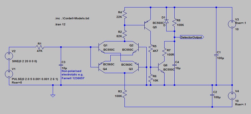

Design the circuit to use standard parts such as 33 or 47uf non polarised caps. Leakage has to be a non issue given the impedances involved.
Yet another detector configuration. The symmetry should provide equal sensitivity to +ve and -ve DC error signals, and a small change enables the circuit to work with bridged amplifiers. The filter cap is a low-voltage non-polarized electrolytic e.g. Farnell 1236657. This is just a sim, I haven't built it.
ThanksYet another detector configuration. The symmetry should provide equal sensitivity to +ve and -ve DC error signals, and a small change enables the circuit to work with bridged amplifiers. The filter cap is a low-voltage non-polarized electrolytic e.g. Farnell 1236657. This is just a sim, I haven't built it.
This is actually quite good!! I like the idea that the gain in both polarity is the same unlike mine that one side is common base that has no current gain.
The problem is that your circuit won't trigger until the DC is over 1.4V as you need to turn on the NPN/PNP pair before current will flow. I did it my way to ensure I trigger the speaker relay when it is over 0.7V. Simulation show reliable trigger at as low as 1V DC.
Yours is definitely faster, so that make up the higher trigger voltage as most dangerous is when the output drive a lot of voltage. At 1.4V into a 4 ohm speaker, the current through the speaker is 0.35A. I guess it's not going to burn the speaker. AND hopefully you know soon enough the amp is no longer working and turn it off.
Mine can take a little over 1 second to trip at 1V, but the current is lower to the speaker. I don't see a compelling reason to give up my design just yet.

If equal gain on both polarities is important enough, then it could be achieved with just one Vbe drop if you're willing to use dual supply voltage - see attached cct.
As far as the filter values are concerned, I didn't think too much about them and my values may be way out. My approach would be to design the PCB to accommodate a range of resistors and capacitors, and choose what works best during testing.
The other thing which may be worth considering is the behavior which AndrewT described in post #575, as oscillation. This type of detector is always going to produce an intermittent signal when the input is very close to the trigger point. If your relay is fast enough to follow it (a solid state relay definitely would), it would produce intermittent connection/disconnection of the speaker to the amp, and could be quite unpleasant.
You may consider that this will happen over a very small range of inputs, so it can be ignored or you may prefer to handle it in your design. In the attached circuit it's handled reasonably well by Q6, R7, R8 and C4. The capacitor can be discharged quickly by the transistor, but takes a relatively long time to charge through R8. A more robust approach might use a monostable.

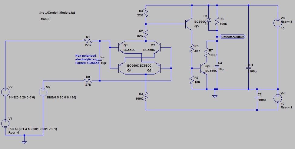

One thing I don't understand, we have two circuits here that shows the two voltage sources ( assuming they represent the output of the power amp to the speakers) stack in series. You cannot stack the output of the two power amps like this!!! They are all ground referenced!!! You have to have separate individual frontend to detect DC fault condition of each side of the stereo amp.

This is the best suggestion so far, I think this one and mine are very close, both trip at 0.7V. Both have about the same number of gain stage. We both have 3 gain stages on the low gain side and 4 gain stages on the high gain side. Plenty of gain.
I don't think it is avoidable for a certain window of uncertainty. I gave a lot of thoughts on using IC opamp, comparators, 555 etc. The idea you have to generate a low voltage supply( supplies) prevent me from pursue this route. Whether it produce an annoying sound is not the end of the world. when this happens, your amp is screwed. As long as it protect the speaker, it's all good.
The higher the gain of the circuit, the smaller the uncertainty window. As I said, both circuit have plenty of gain even though the gain is not the same for both polarity.
The two voltage sources represent a single (faulty) amp output. One is producing a sine wave and represents the intended output of the amplifier, the other produces a small DC offset. When the DC offset is active, the detector should trigger. So the two sources are just the way I chose to construct my test signal. I am a beginner at spice, and I expect there may be better ways to do it.One thing I don't understand, we have two circuits here that shows the two voltage sources ( assuming they represent the output of the power amp to the speakers) stack in series. You cannot stack the output of the two power amps like this!!! They are all ground referenced!!! You have to have separate individual frontend to detect DC fault condition of each side of the stereo amp.
No it's a better way. I never thought of this!! I just use the single voltage source and change it to DC to test speaker protection, then change to 10Hz 40V to test the low frequency. My bad.
I was expecting protection circuit for both channel as in my schematic.

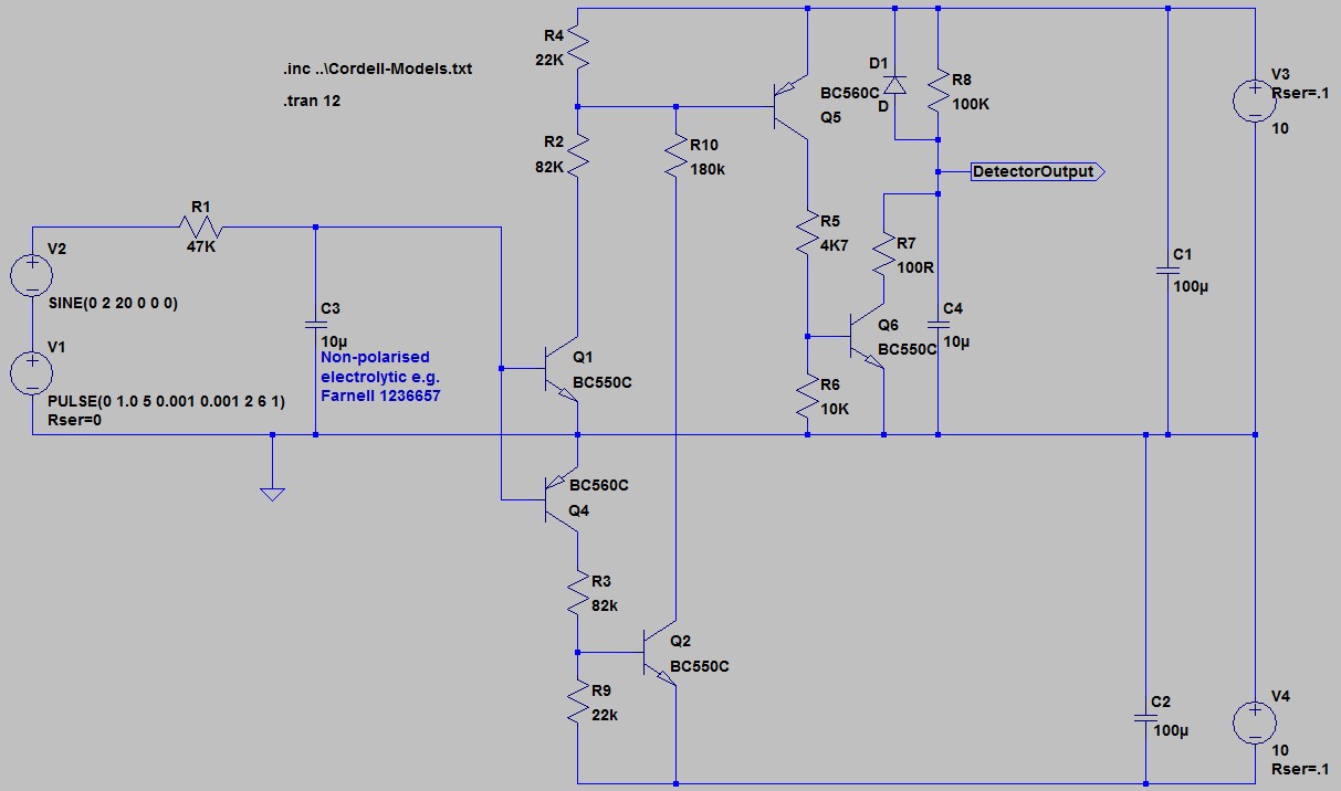

You design these? You got some good ideas. I actually like yours slightly better. I am debating back and fore. The back end is the same. You use one extra transistor and has to have the -ve rail supply. So it's more complicated. But you do buffer the input with a CE stage to achieve higher impedance. I already finished the pcb layout already, I am debating whether I want to incorporate your front end.
One thing I don't understand, why are you using C4? That will slow the response down.
I think I discover a potential problem of your circuit. You use the -ve supply. If the -ve supply fails, Q2 will never comes on and trigger the protection. But you can argue when -ve supply fails, the output likely drift +ve, the circuit should still works in protecting the speaker.
In my circuit, I don't depend on the -ve supply. And if the +ve supply fail, the relay will loss power and open and protect the speaker.

That is correct - the circuits I posted are not complete solutions. They only address the detector part of the circuit. There was no consideration of power-up delay, rail voltage failure, or mains failure.I think I discover a potential problem of your circuit. You use the -ve supply. If the -ve supply fails, Q2 will never comes on and trigger the protection. But you can argue when -ve supply fails, the output likely drift +ve, the circuit should still works in protecting the speaker.
The purpose of C4 is described in post #587, but it is intended to prevent the pulses, which the detector sometimes produces, from reaching the speaker relay. These pulses occur when the input signal is very near to the point where the detector discriminates between "DC on" and "DC off".
Here again, my circuits are incomplete, C4 produces a slow rising voltage when the detector state changes from "DC on" to "DC off". This slow rising voltage would not be suitable to operate the relay directly - it would need to be followed by circuitry which operates and releases the relay at chosen voltage(s).
