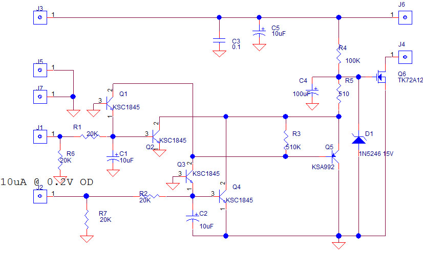

The photovoltaic couplers are imo the most elegant solution but if you don't want those then arranging an auxiliary high voltage rail is easy with a simple voltage doubler. The current requirement is miniscule.
Hi MoolyThe photovoltaic couplers are imo the most elegant solution but if you don't want those then arranging an auxiliary high voltage rail is easy with a simple voltage doubler. The current requirement is miniscule.
I already bought the V621 and layout into the pcb already. I am just reading through the thread getting info on the turn off time of the MOSFET and ran across this. I my opinion, photovoltaic coupler is much better, who wants to put in an extra supply just for the sake to be different!!
I know the spec said the MOSFET turn off time delay is 0.4mS, but I put two output of the V621 in series, that's the reason I am looking for the time delay for the MOSFET to turn off.

I am not doing it for testing, just want an amp that is better than my Acurus and enjoy. I already put into my pcb, I just want to get more info. I want to protect my speaker. Burning the amp is not even that big a deal.Hi,
Are you doing this to test or to you it must work this way and won't require testing?
I have been looking at such switches, both for rail and output muting, but I haven't tested, so I'd be interested in test results and what comes out of it, making perhaps different choices and why.
So this means as it is, this is considered a viable and fully functioning method that doesn't require any further tweaking. Is it?
On my part, I would want to try to protect both the speakers and the amp, if at all possible. With rail switches, there is a better chance for the amp to survive, or at least limit the damage.
Often the danger comes from what comes in the amp's input, so I would also add a muting on that amp's input.
Doing it all solid state and avoid mechanical relays is definitely a plus.

I was just raising questions when I read the other design that need an extra supply to do the job. To me, the argument of photovoltaic is slower doesn't hold water in my book. We are talking about power dissipation...that takes time. a few mS is not going to hurt. If they are worriers, do it just like me!!! I parallel two pairs of MOSFET that are 4.5mohm on resistance!!! The lower resistance, the less voltage drop across and less power. Two in parallel, you have double amount of bonding wires inside the MOSFET and it's like a bigger fuse inside.
But from reading the thread, I am starting to think about the power on "pop" that I should avoid. I have a circuit board to turn on the relay with the output voltage settle to 0V. I wonder whether this will cure the pop as the relay will not turn on until the output settle to less than 0.7V from ground.
0.7 volts isn't much per se but it will create a very loud pop from the speakers.
You need a fixed turn on delay at power on together with an instant disconnect at power off. The circuit must also reset instantly so that even a brief interruption enables the full start cycle to commence.

Would just controlling the speaker relay enough to avoid all these?
I have a separate pcb to drive the SS relay. If the output relay is good enough, I can add say a 555 timer or something to keep the relay from turning on for 5 seconds.
I have not stuff this board yet, just as easy to chuck this board and relayout a new one. It's less than $30, not even worth adding onto this.
