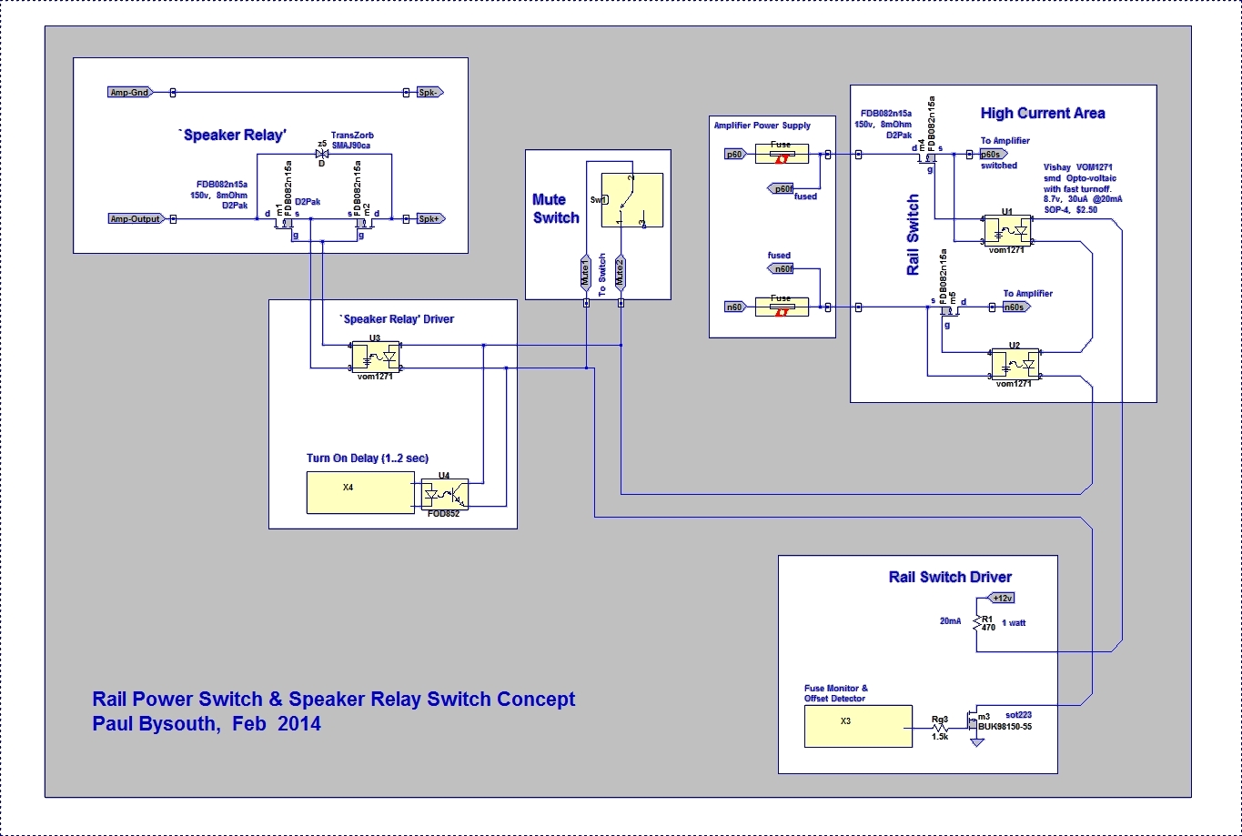

has anyone found a cheap way to trigger the mosFETs off?
All the photovoltaic driver chips seem to be too expensive.

If you want to switch off the supply rails you don't need to switch off the speaker line, just don't put to big caps after the mosfets. To switch off the supply rails you don't need a photovoltaic chip or an isolating transformer.

BTW, I want to use N channel mosFET on the +ve Rail, as well as the -ve rail.
I think switching the rails without transformers or optos is easy. You can also use all N channel to do it.

It's simple using N-channel MOSFET to switch the -Ve, not so to switch +Ve as you will need a boosted supply that rides about 10V above +Ve to provide the needed Vgs as the source of the MOSFET is at +Ve potential.

I want to use heatsink over temperature and/or output excess current and/or output excess IV and/or output excess DC to trigger and maybe a time delay.

That's why the photovoltaic driver is so good.It's simple using N-channel MOSFET to switch the -Ve, not so to switch +Ve as you will need a boosted supply that rides about 10V above +Ve to provide the needed Vgs as the source of the MOSFET is at +Ve potential.
It is isolated and it provides it's own drive voltage.

I suggest you use the following concept. All the fancy stuff goes in the boxes labelled X3 and X4. The vom1271 will be a bit slow to turn the mosfets on (10's of mSec), but will turn off very fast (a few uSec). Run them at 20 to 25mA LED current.
Note! If you use a speaker offset detector, then it must latch on! If it doesn't latch on, then the offset turns the rail switches off, the offset disappears, then the rail switches turn on and dump the full rail voltage onto the (faulty) amplifier. This will continue till the amp and/or speakers fail. An opto triac is useful here.

Thanks again Paul.
The wiring/interconnection of the modules looks similar to what I imagine I want to do. Except I plan to put the speaker relay in the Return route and avoid on photovoltaic.
And yes I agree on latching. two transistors is all it takes.
Fitted by Crimson in my amp modules from way back and in a more recent Cyrus output detector.
The Cyrus version switches off at crossover.
But you are using Photovoltaic drivers.
Why the transorb across the speaker relay?

Why not use the photo-voltaic drivers? The vom1271's are cheap ($2.50 aprox), available (Digikey have 22,678 at the moment, Mouser has 5,152), and save a large amount of PCB space. Also they are not likely to become obsolete in the near future.
The tranzsorb is to safeguard against exceeding the breakdown voltage of the mosfets - probably not really required unless using mosfets that have a breakdown voltage close to the rail to rail voltage.

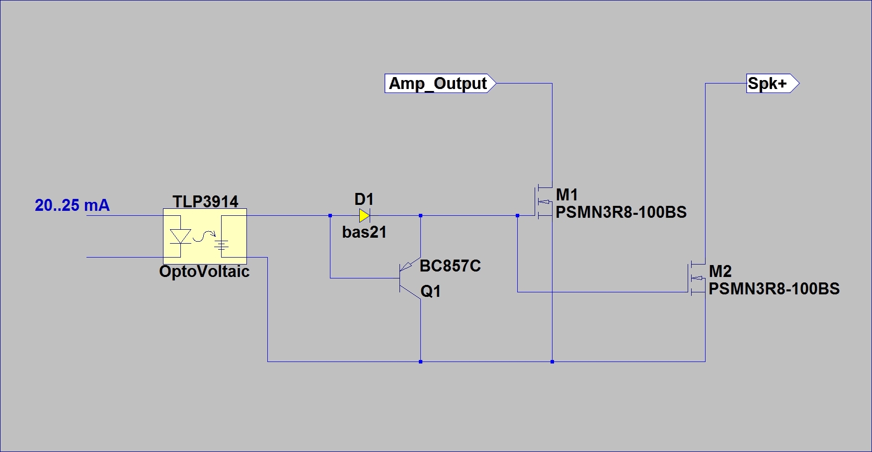

That makes sense................... not really required unless using mosfets that have a breakdown voltage close to the rail to rail voltage......
I have 80V mosFETs.
I have never used photo voltaic couplers.
Are these suitable, I can source them easily. Moose and Digikey is sadly not an option for me.
I'm sure about turn off of this one
http://docs-europe.electrocomponents.com/webdocs/0af4/0900766b80af4d0a.pdf

The Toshiba TLP3914 opto appears to be reasonable, but would require an external turn off circuit. See diagram for how to do this. I did a simple model to test the circuit with PSMN3r8-100bs mosfets (which have very low Rds-on, but very high input capacitance), and it appears to work as it should.
