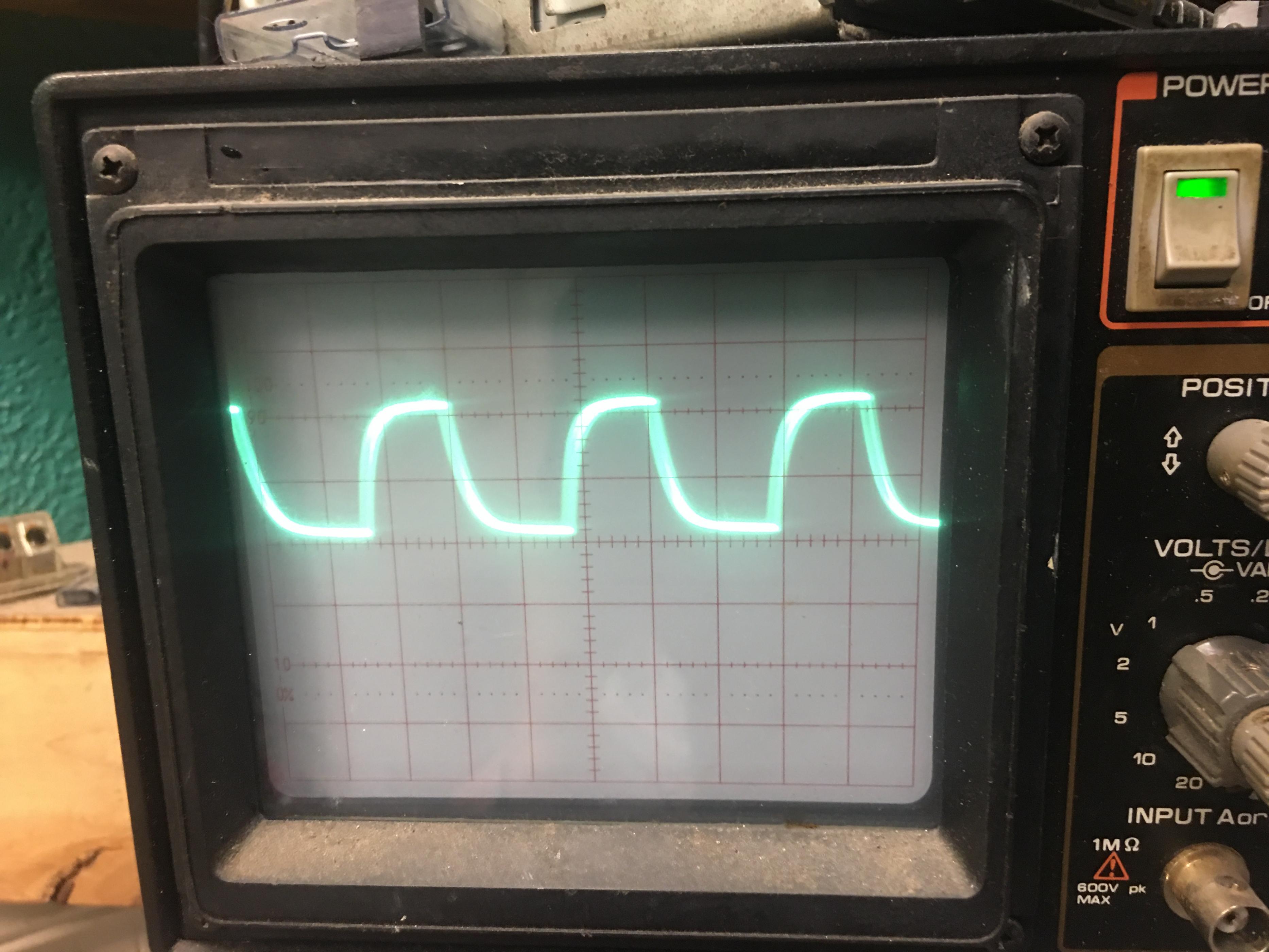

Is the drive signal on the gate pads going all of the way to ground (scope must be on DC coupling and the trace aligned to the reference line)?

Re-check all 4 banks and while watching the drive at the FETs (with the cap), move the driver board to see if the drive signals ever change.

I can’t get the drivers be signals to change while wiggling the driver board and pushing on various points of the board .

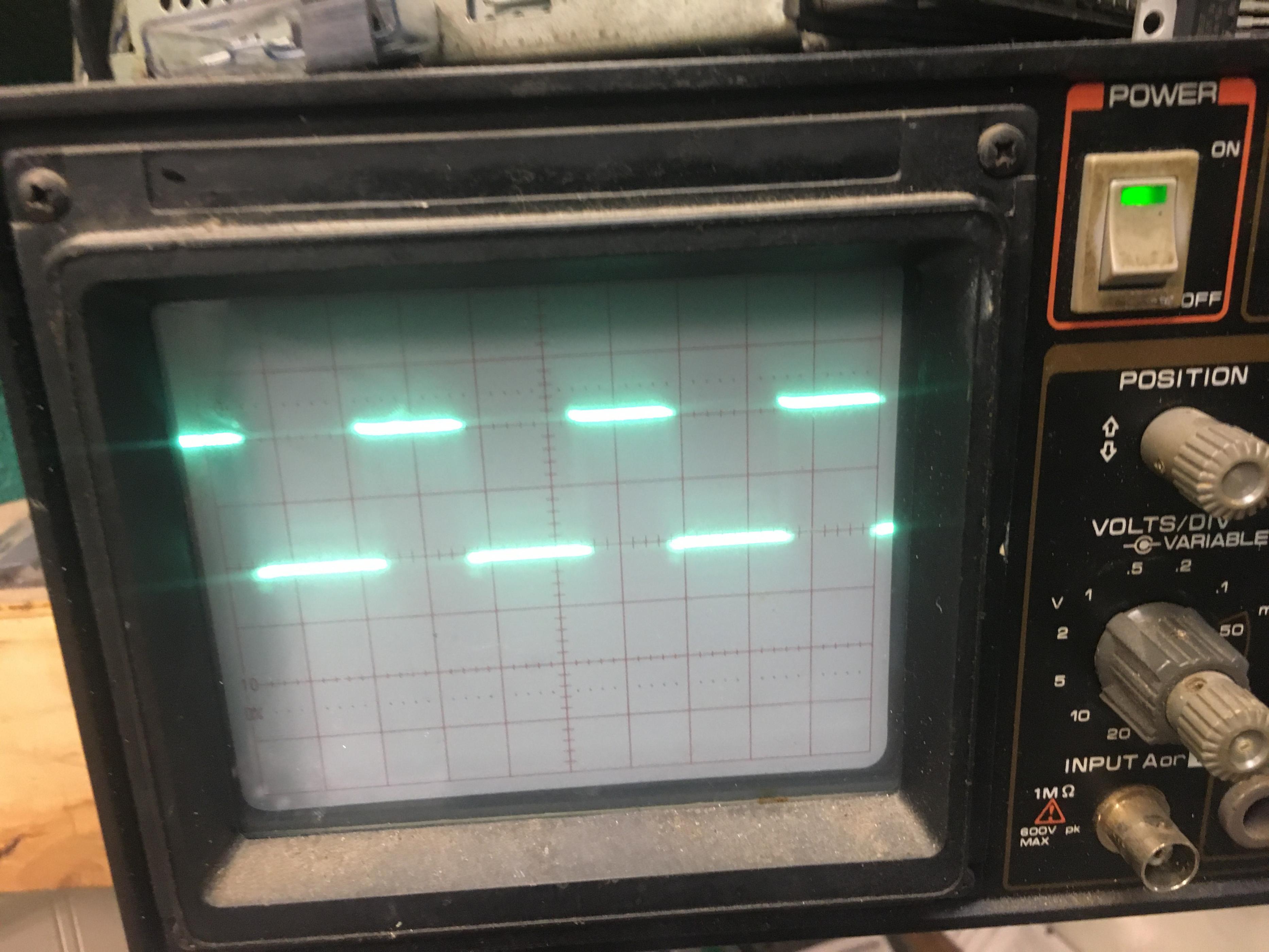

I checked the drive signals on the outputs all appear good .
