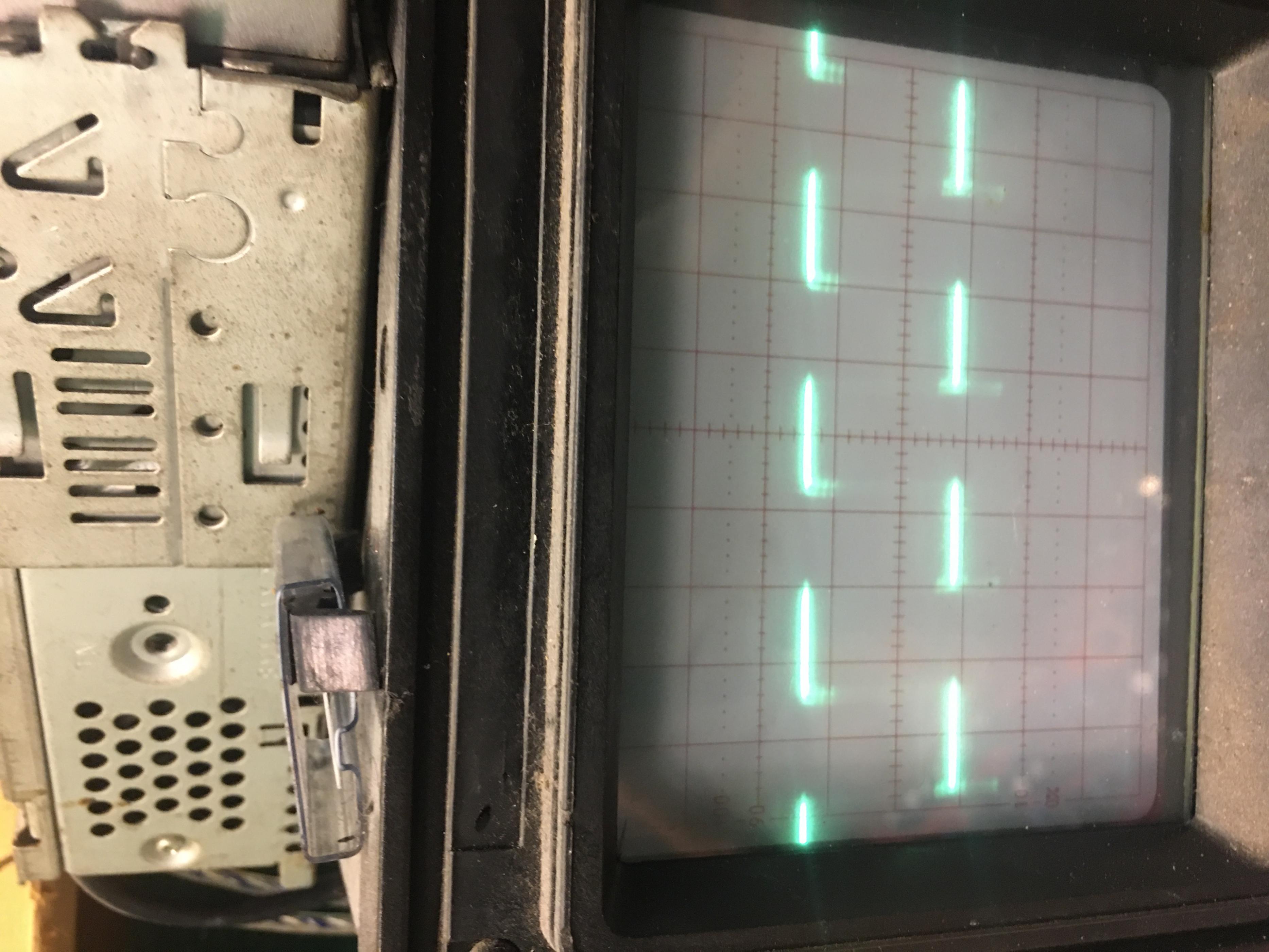

Connect a 1k resistor between the center terminal of 3-pin connector and the outer terminals. Does the signal look the same on each output?
Reinstall the driver boards one at a time, only soldering the 3-pin connector. Does one board load the drive differently than the other?
I replaced all of the drivers .
Here is what I get on the 3 pin connector now .
Do these drive waves look correct or do I still have a problem possibly a bad LM361?
Scope settings are 2us 2volts /div

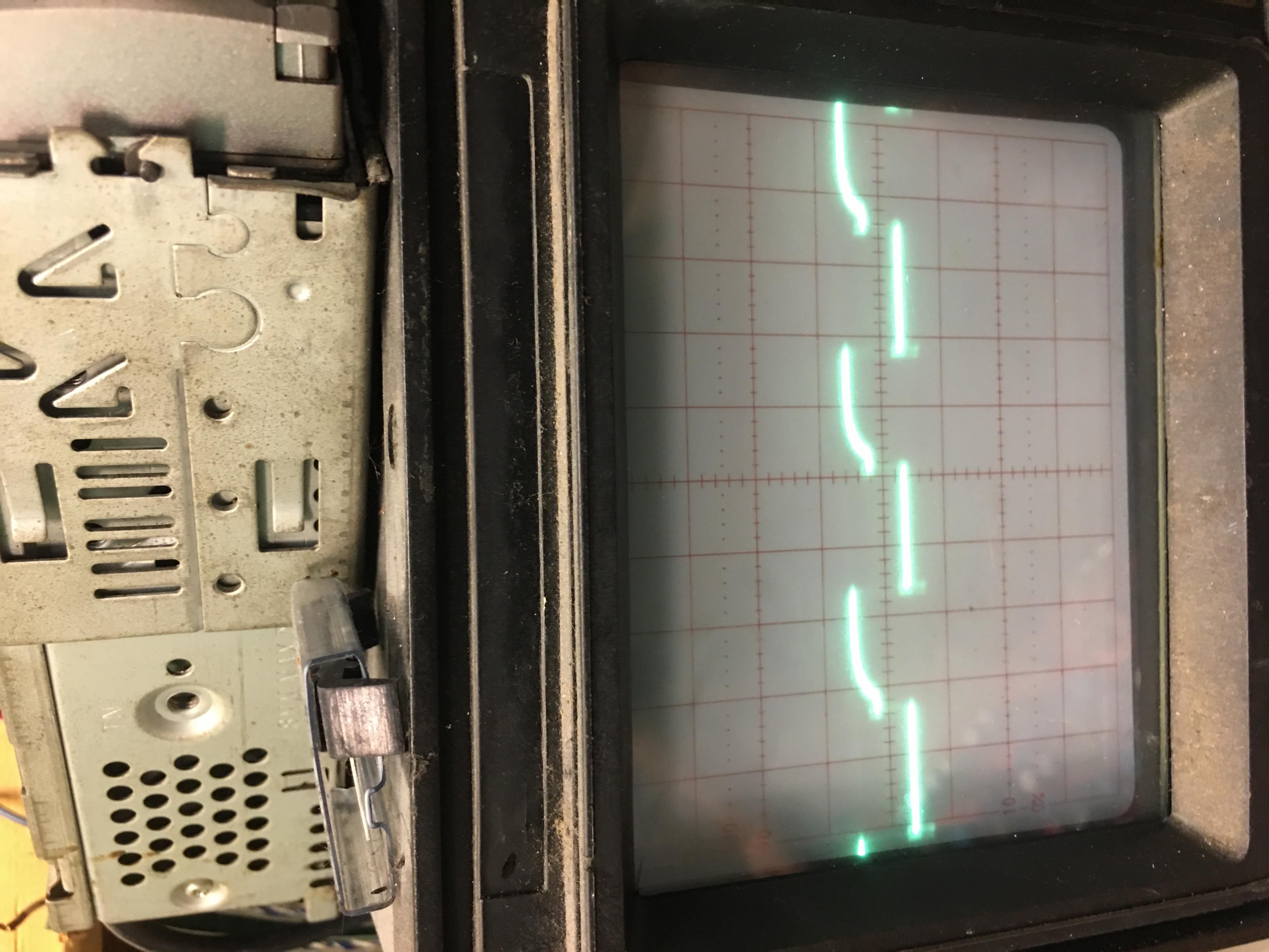

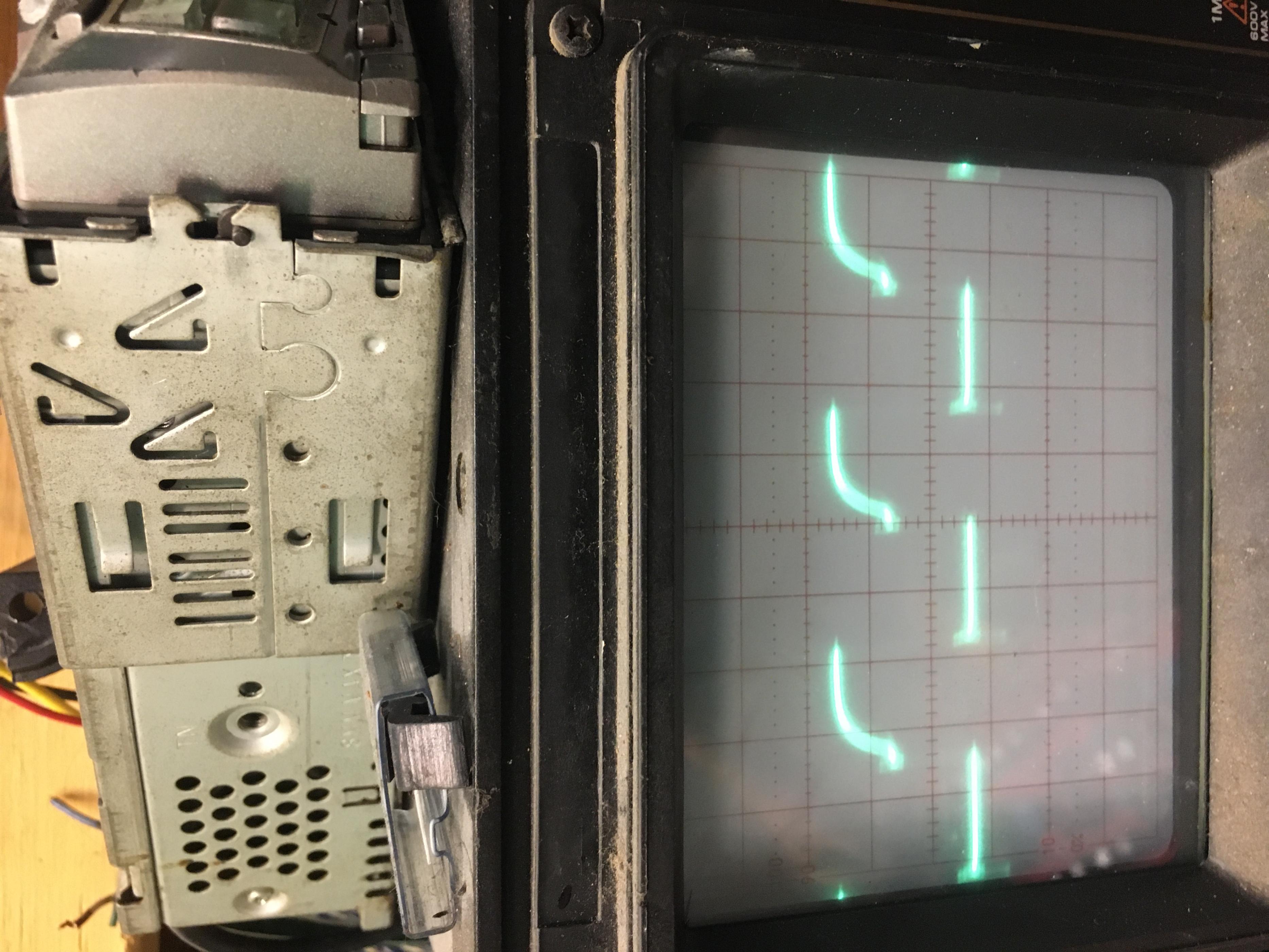

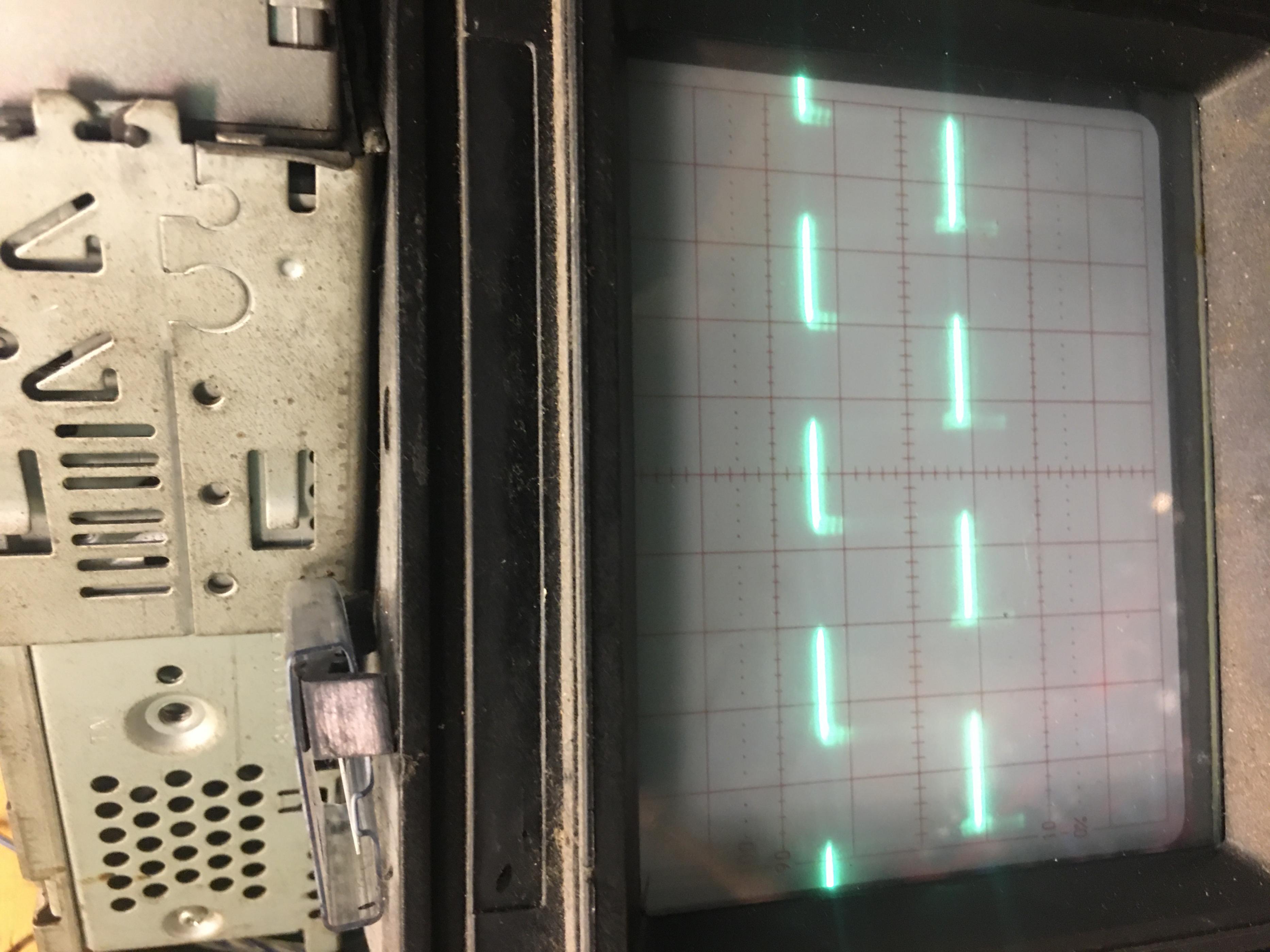

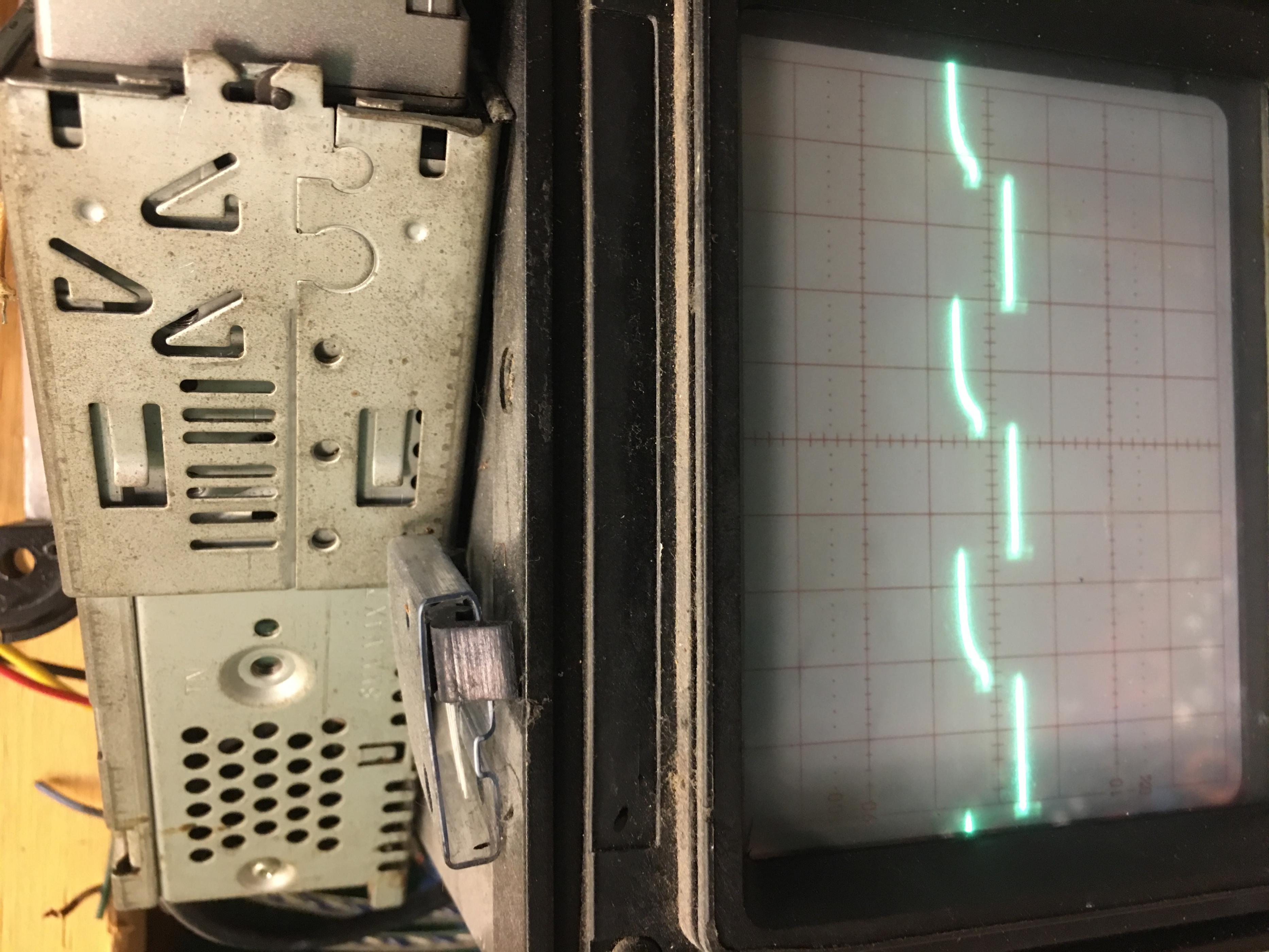

Going back to post 47. You stated that you got the same signal on both outputs. But did you get the same waveform as you had on post 45?
First pic is with the audio driverboards removed and the 2nd pic is with the audio driverboards installed.
Scope settings are 2us 2volts/div in both pics .
Post 45 the top edge of the waveform looked better with no audio boards installed post 47 appears to have a curve not sure if this is normal or not .
