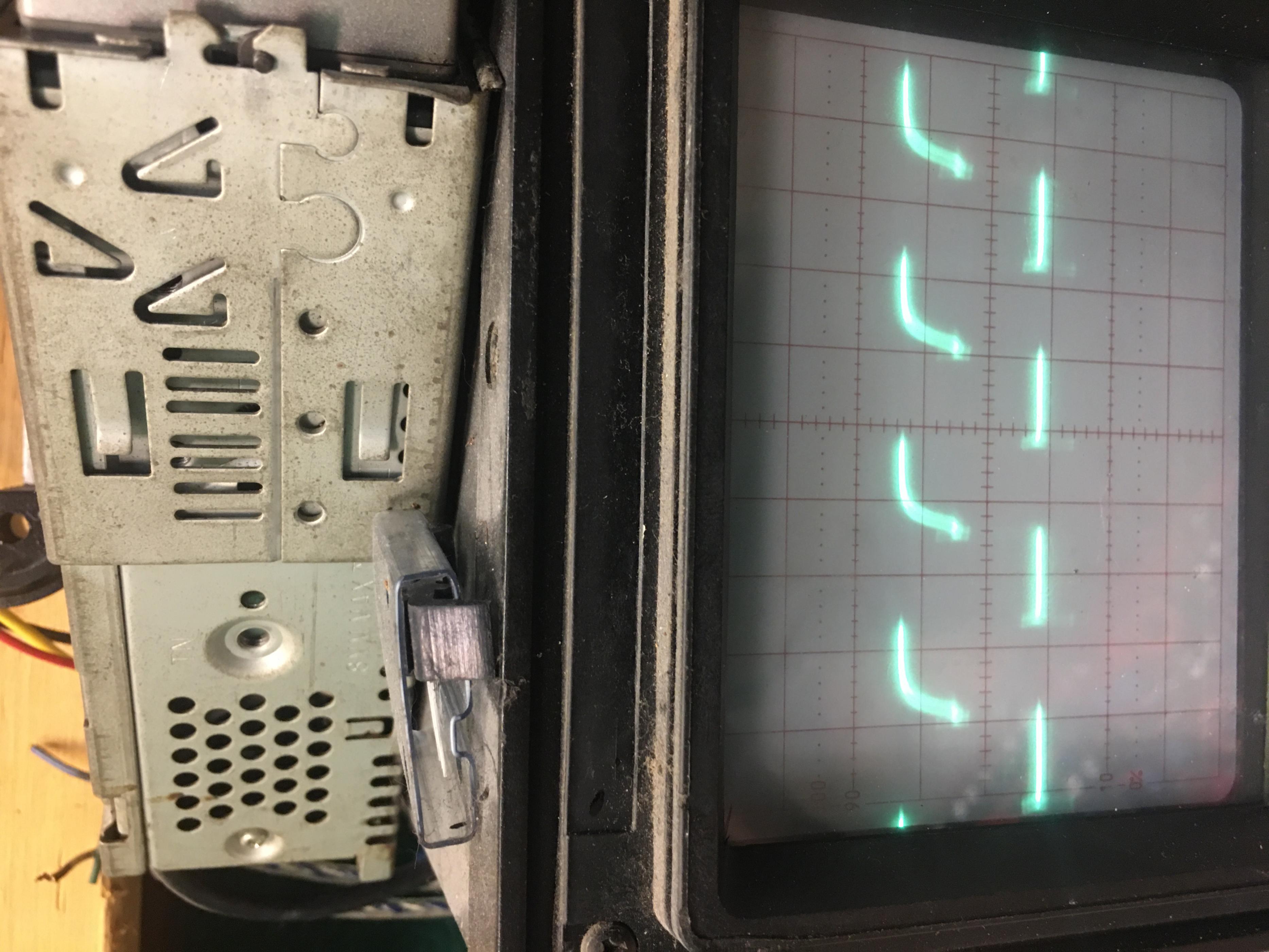

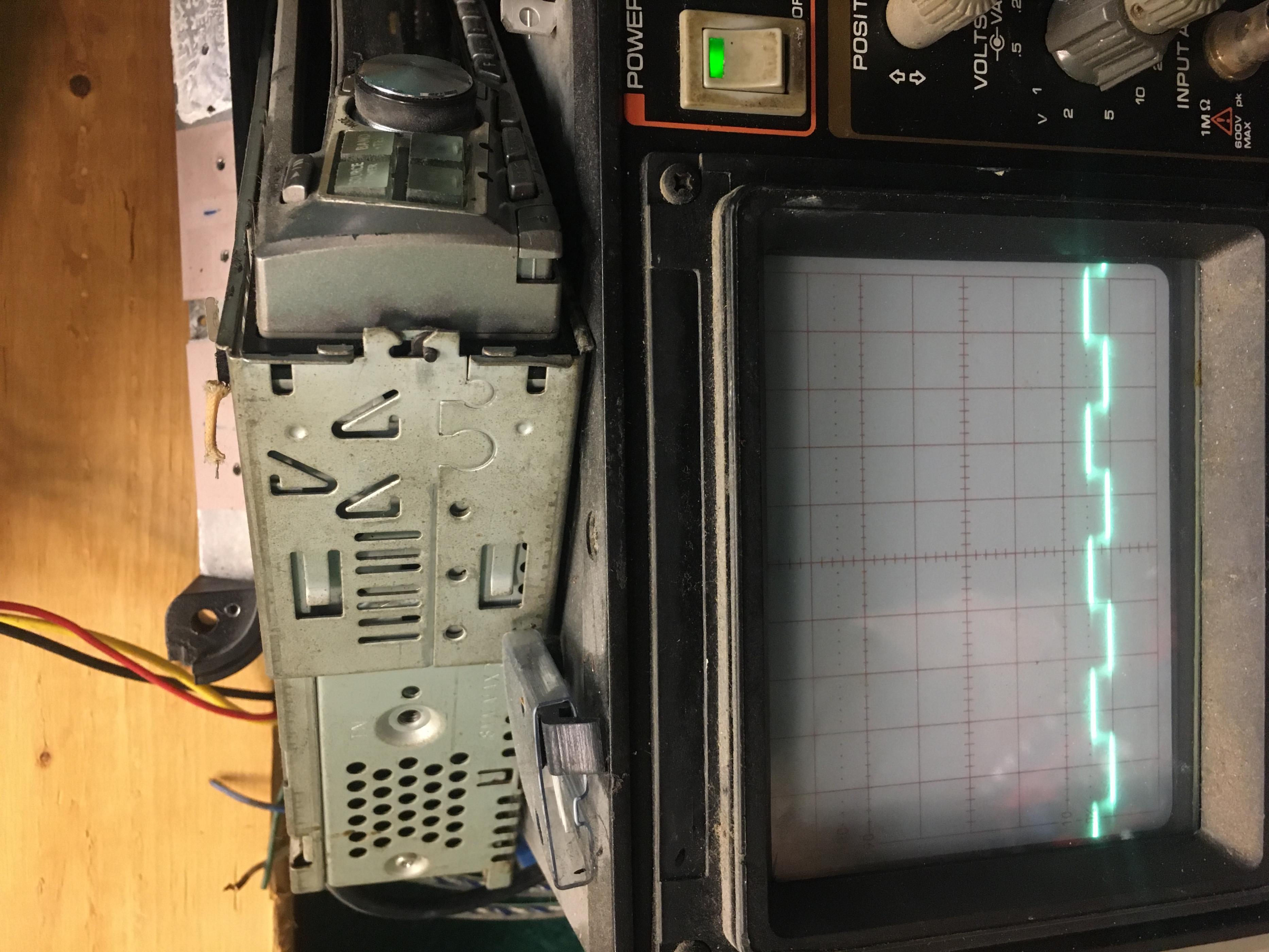

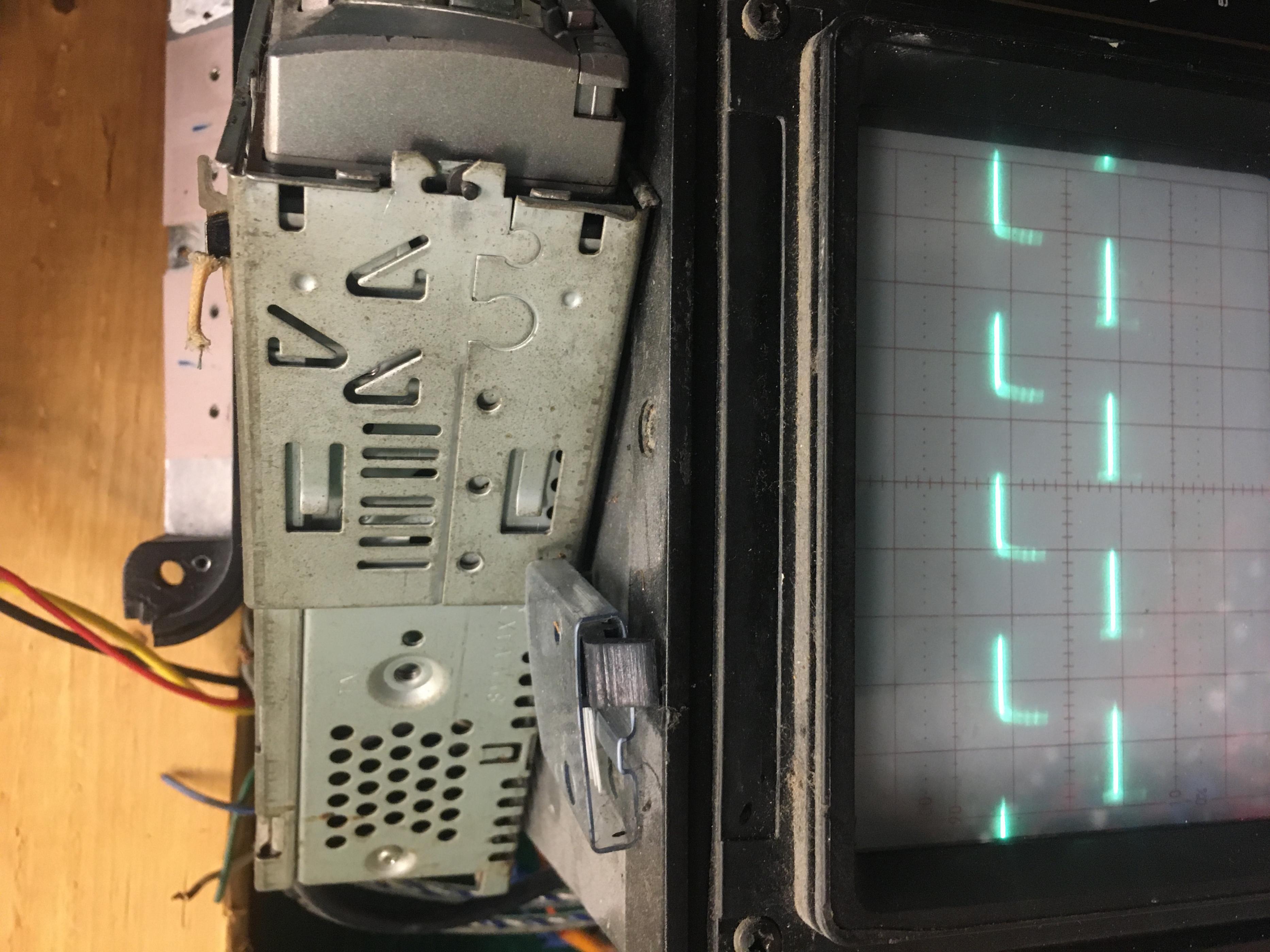

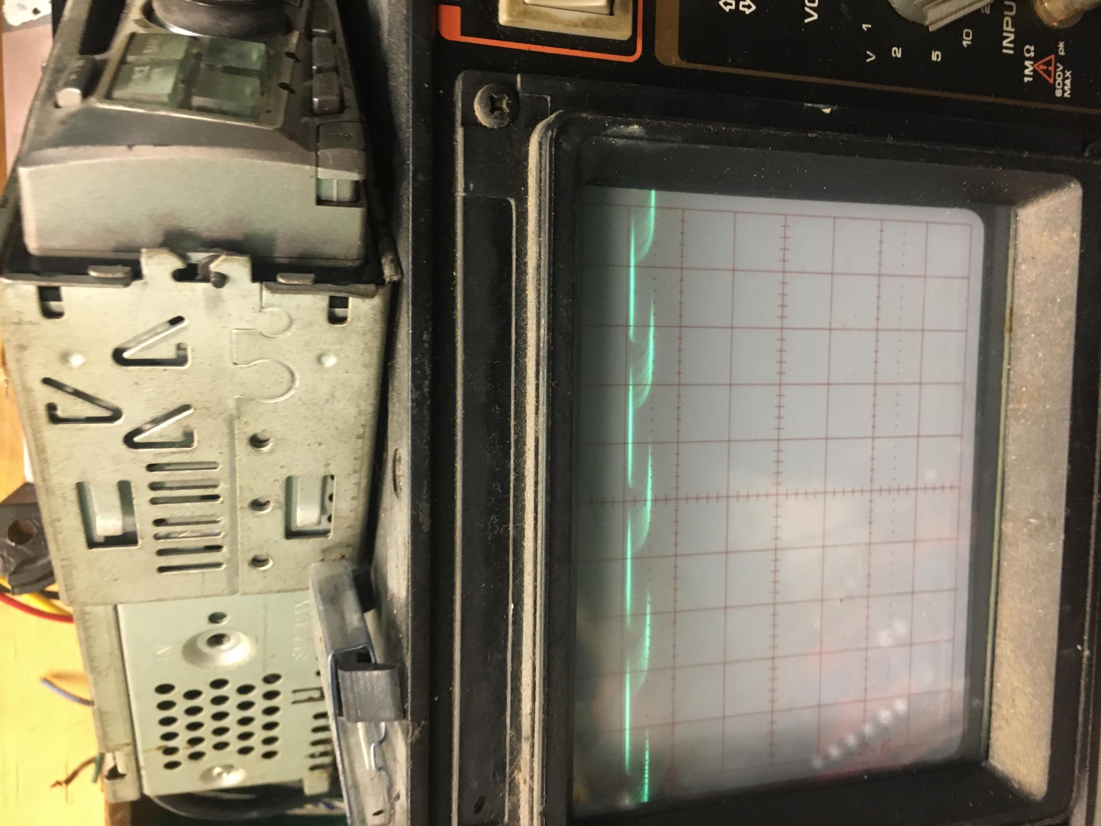

If I touch the gate pad for the output I don’t get any drive signal at all this is for all of the outputs .
And yes they all heat up at the same time
The high side has driver issues. It should be square like the low-side. Are all high-side banks the same?
There is a 3-pin connector on the board from post 20. What do the 2 drive signals look like there?
