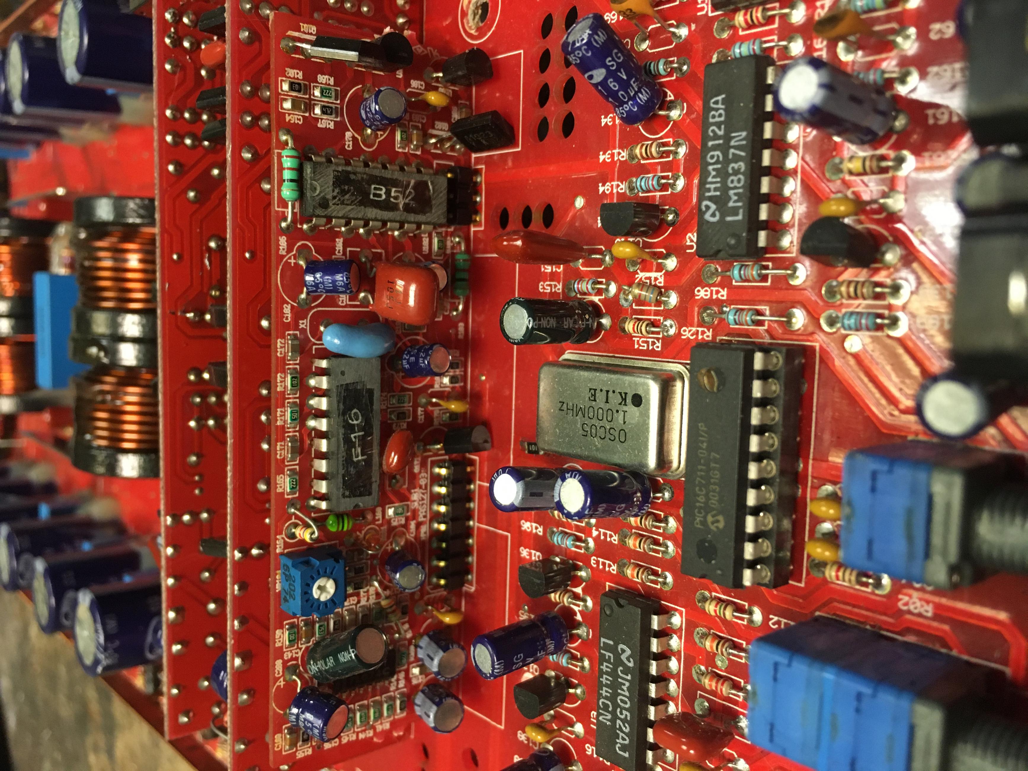

Here are the voltages that are on the LM361 and the other IC marked F16
Do these voltages appear to be correct ?

I ask this because everything else checks ok
