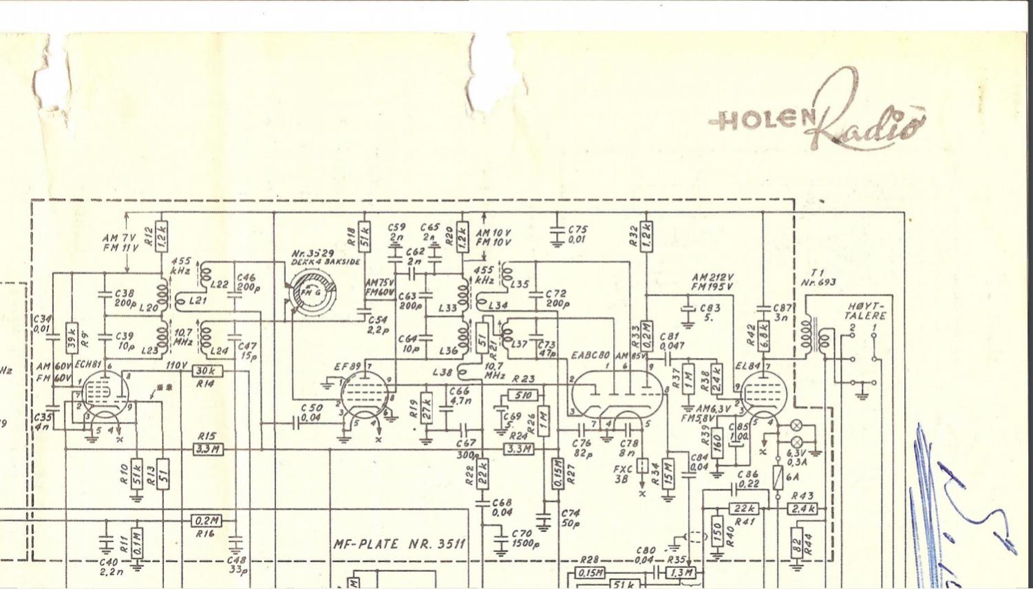

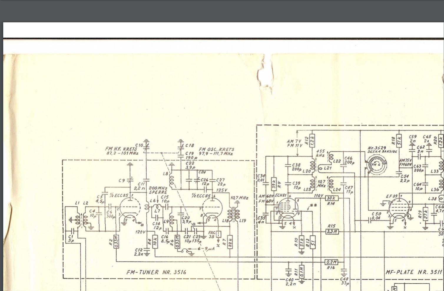

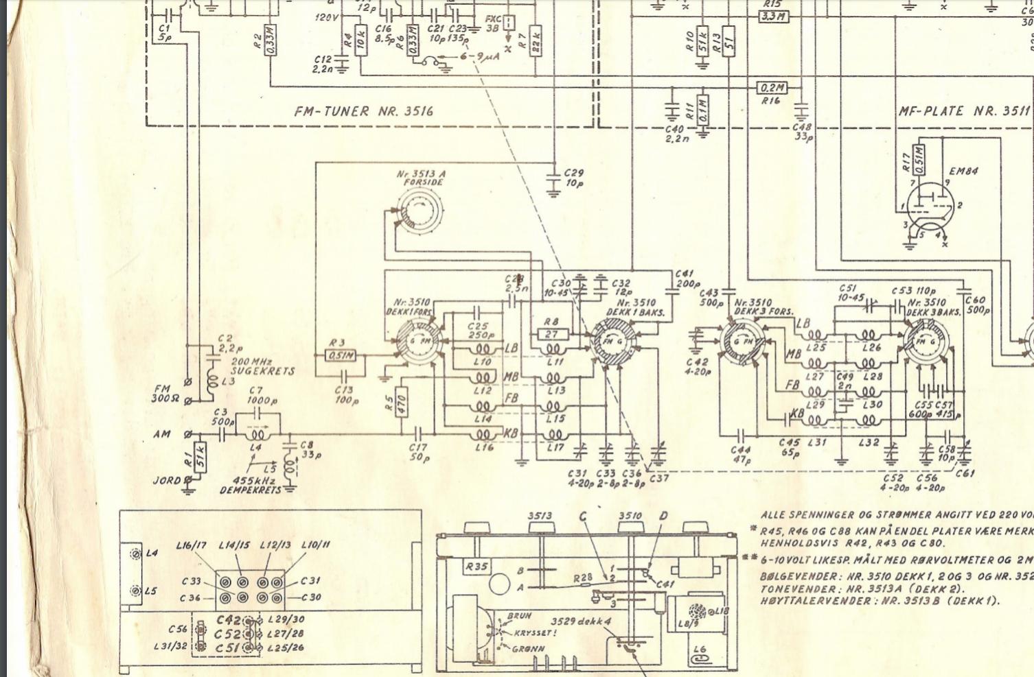

and here is the rest of the schematic sorry i cant post the pdf but this website is really outdated it can only post pdf files with a max size of 1,91MB.

In that case they must be early diode rectifiers not selenium what shape and material is it made out of ?
The combined capacitor is bad news I had to replace every one due to leakage between them.
The tubes are standard British type B9A based I have them all in my spares box usually quite reliable
Thanks TG---If it is it is recommended that a surge protection resistor be fitted --not my words but the original manufacturers of selenium rectifiers backed up by electronic hardware engineers of the time.
If you check up that type needs a current limiter as without it its normal working life is shortened and/or efficiency is affected .
That would then mean you should not go much above the recommended reservoir / smoothing capacitor value.
I couldn't find that rectifier in my equivalents book.
