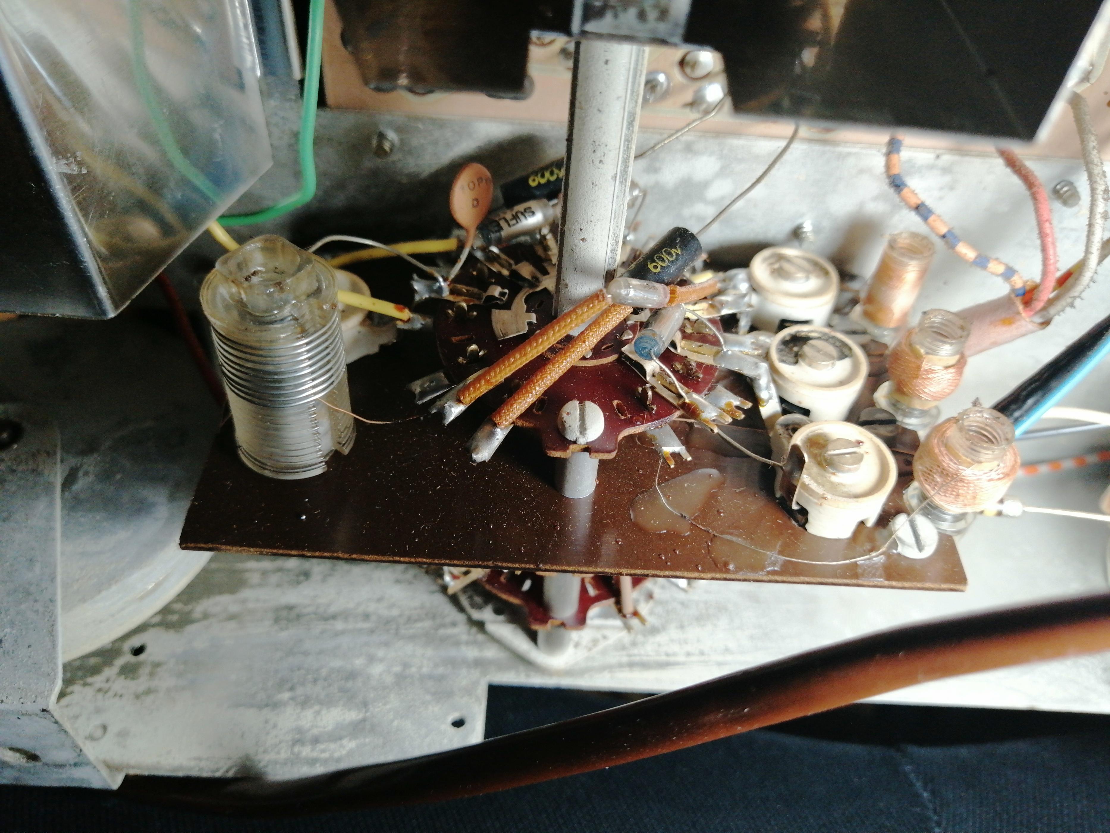

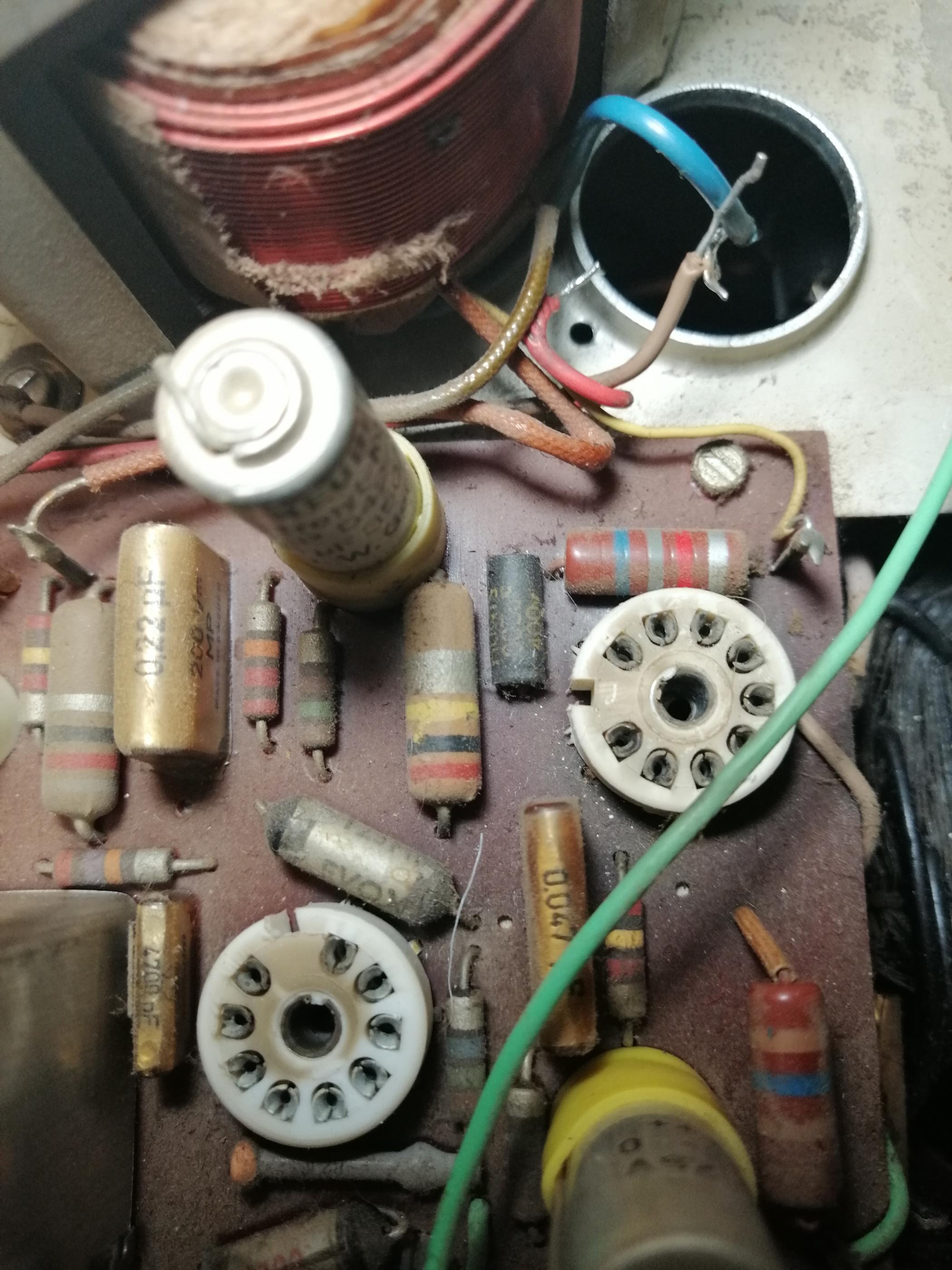

Im not picky its Just that i want something that works a while i dont want use silver mica capacitors in the rf stage Just to be as reliable as the original capacitors, and also too bad you cant open the link it has every tandberg schematic that exist. And also by small Round black capacitors i meant these. From what i have heard these small black capacitors are unreliable. Also what is the name of these small black capacitors. The reason i wanted to replace them with mica capacitors is that i have heard they are more reliable and they are the same values you know for example 600pf.

I recognise the ceramic semi variable capacitors your circuit looks 1960,s .
Your right those tubular black capacitors weren't meant to last a lifetime I think they were Mylar capacitors usually used in interconnection of tubes in early stages ( IF etc ) of radios --
Just for you here they are ( second down )-
UK Vintage Radio Repair and Restoration - Capacitors
Even give you their recommended replacements --scroll down .
I hope you are not attempting to stock a single type of cap to replace all non electrolytic caps in antique radios. This is bad practice. So is wholesale recapping. Ordinary modern film caps be they tubular or gumdrop will suffice to replace paper caps in electronic radios but for the various non paper types you need an understanding of why that type of cap was used to begin with and when/if they should be replaced. No disrespect intended to any individual here but for antique radio work you should take advantage of the body of knowledge available at another fantastic site, the antique radio forum at Antique Radios - The Collector's Resource
