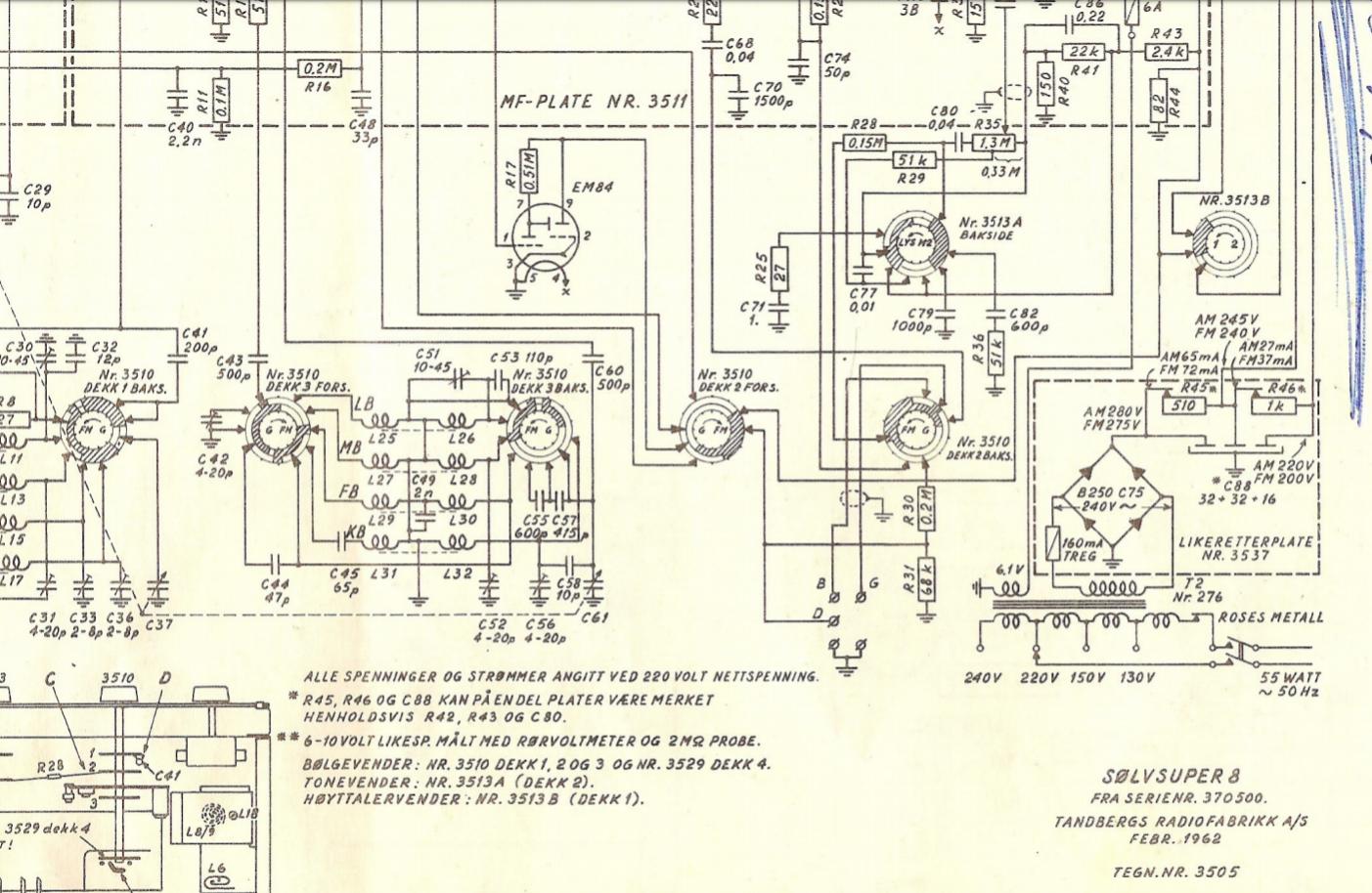

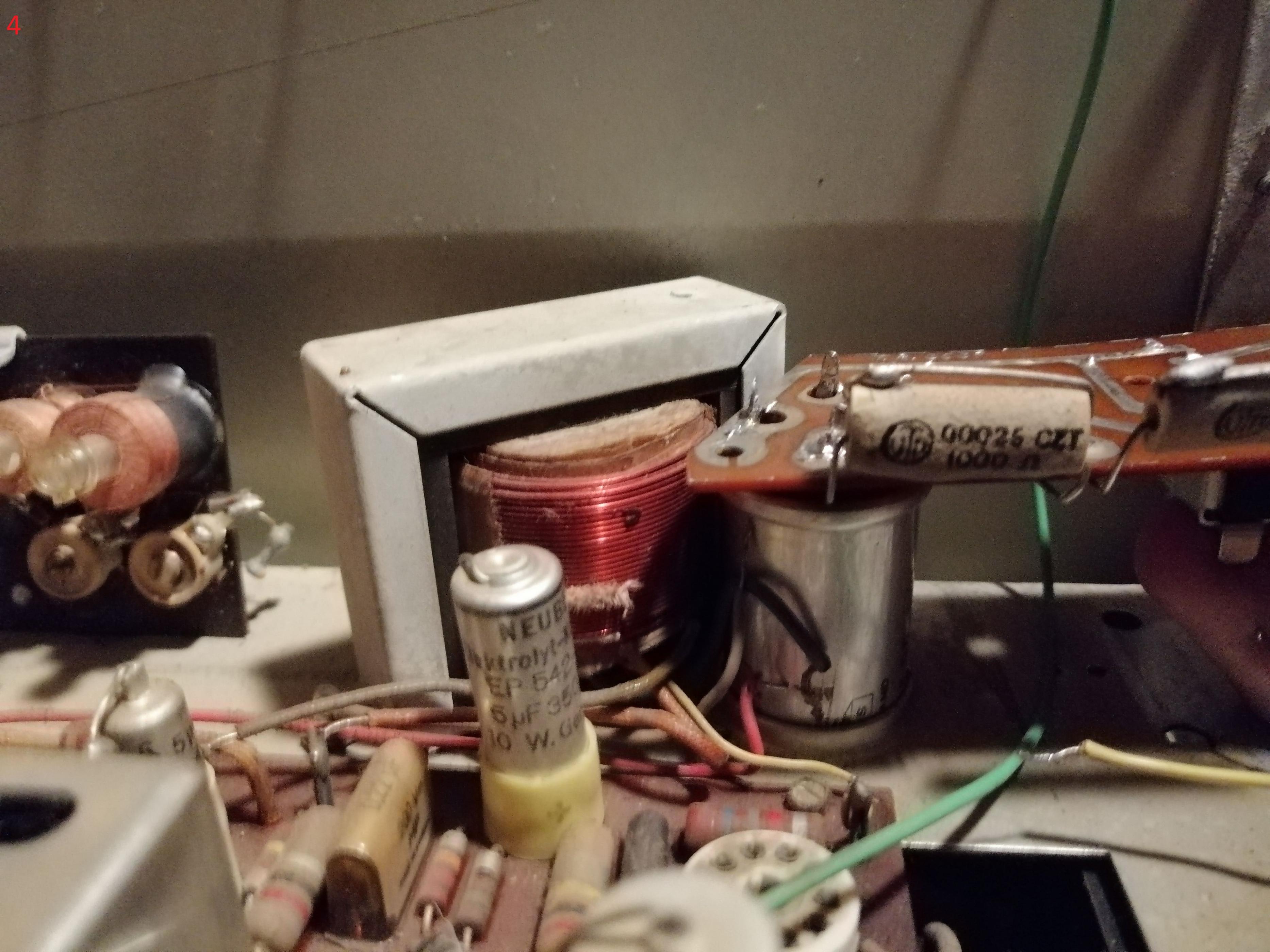

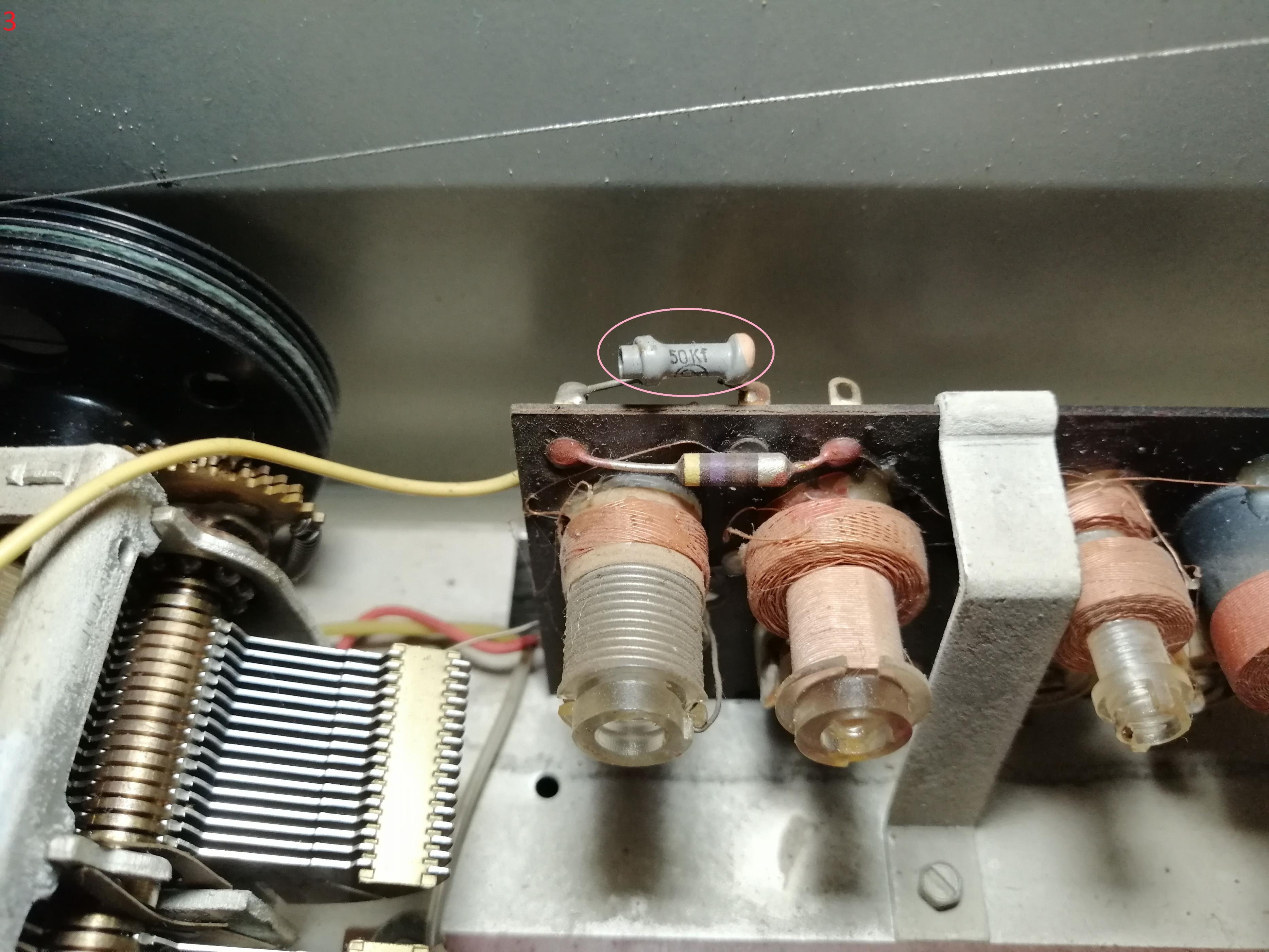

i have put a colored circle on every component i want to know the name of them and if they need to be replaced. there`s also a number on every picture.anyway on
the fourth picture there`s a big capacitor holding the rectifier board in place can i replace it with a dc motor where i have taken out the all the components and then put rubber on the motor so it fits and then solder it to the rectifier board.i am aware that a broken dc motor cant be used as a capacitor but i think it should work good enough to hold the rectifier board in place.and yes you are right i am from Scandinavia i was born in Norway and my username means mountain fox.yeah and also thanks for all the help this is the first tube radio i have attempted to recap.and don`t worry i am not doing wholesale recapping.and also you have to open the pictures to see the circles.

Get you -
No 3- old school ceramic capacitor
No 1- 60,s film capacitor
No 4- power resistor
No 2- RED=polystyrene capacitor---Orange looks like another polystyrene capacitor OR film capacitor --- Yellow- 61K -1 watt 10% resistor
No colored circle on picture 4 so guess you are talking about the resistor top right.

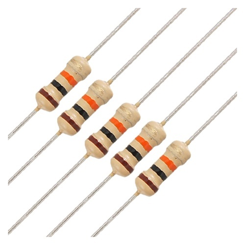

I though the yellow was maybe a color coded capacitor because it doesnt look like the other regular resistors in the circuit. BY normal resistors i mean this.and also are the capacitors i marked still reliable.

No already knew it was a Power resistor, what i wanted to know on the fourth picture is whether or not i can use a modified dc motor with some rubber attached to it to hold the rectifier in Place. i can't find a 32/33uf 350v capacitor that is so big it can hold the rectifier board. And what i meant with modified is that the motor parts are removed Basically making it a tin can with two isolated leads.
That 1 watt resistor was normal in the 60,s ,its carbon and 1 watt metal film were not used then which are much smaller.
32/32uf in one can were standard for a power supply in those days for a tube rectifier , one acts as the reservoir and the other smoothing for the HT+ (plate ) .
What you want is a tube (valve ) holder used in portable tube equipment . The tube base had a metal ring round it and a steel wire clip to hold the tubes in place.-

If that transformer is a mains transformer then the output went to the rectifier .
If its an output transformer then you have a direct mains feed to the rectifier see-
Using Selenium Rectifiers, October 1947 QST - RF Cafe
Of course the old rectifier can be replaced with modern diodes ---BUT-- you will have to fit series high wattage limiting resistors as the new diodes will give a higher output than the selenium rectifier.
As with tube rectifiers that's down to WHAT selenium rectifier is fitted .
In that type of rectifier --a "radio type " no vanes a surge limiting resistor MUST be included - eg- 5ohms--7ohms .
This is fitted BEFORE the rectifier NOT after and the total capacitance --AFTER the rectifier unlike a tube rectifier.
Do NOT neglect to fit the surge resistor without it you can blow the rectifier .
