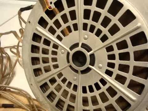

Can i use 4 ohm speakers with tube amps. I want to use tandberg speakers with tandberg tube radio's and almost all of the tandberg speakers are rated 4 ohm.

The old original standard was 3 ohms and 15 ohms with some variation .
The old radios I have worked on were all lower than 8 ohms which is a comparatively "modern " impedance compared to very old radios and amplifiers .
Look Fjellreven only one thing counts the OUTPUT impedance of the output transformer not "what some guy told you " they obviously are referring to modern era amplifiers not old tube radios .
Even if it is 4 ohms a 3 ohm speaker will still work with it .

Those are still speakers designed for AM radios in the 60s. An appreciation for vintage tube radios does not mean you are required to consider them some kind of high fidelity device. The 6.5" full range driver in the Hifi System 3 would be better than the tiny speakers in a table radio, but still not all that great. 60-16000 sure, maybe +/-20dB 😉

This isn't a matter of adding hi-fi speakers and getting hi-fi out that wont work the whole circuit of the radio its attached to is the arbiter of how it will sound.

I can see compensation components in the Huldra 7 that indicate rolloff will be pretty severe above 5kHz.
I had assumed the 165BK would be 165mm, perhaps the cone is?
Wrong then the tandberg type 150 would be 150mm but it isnt.
