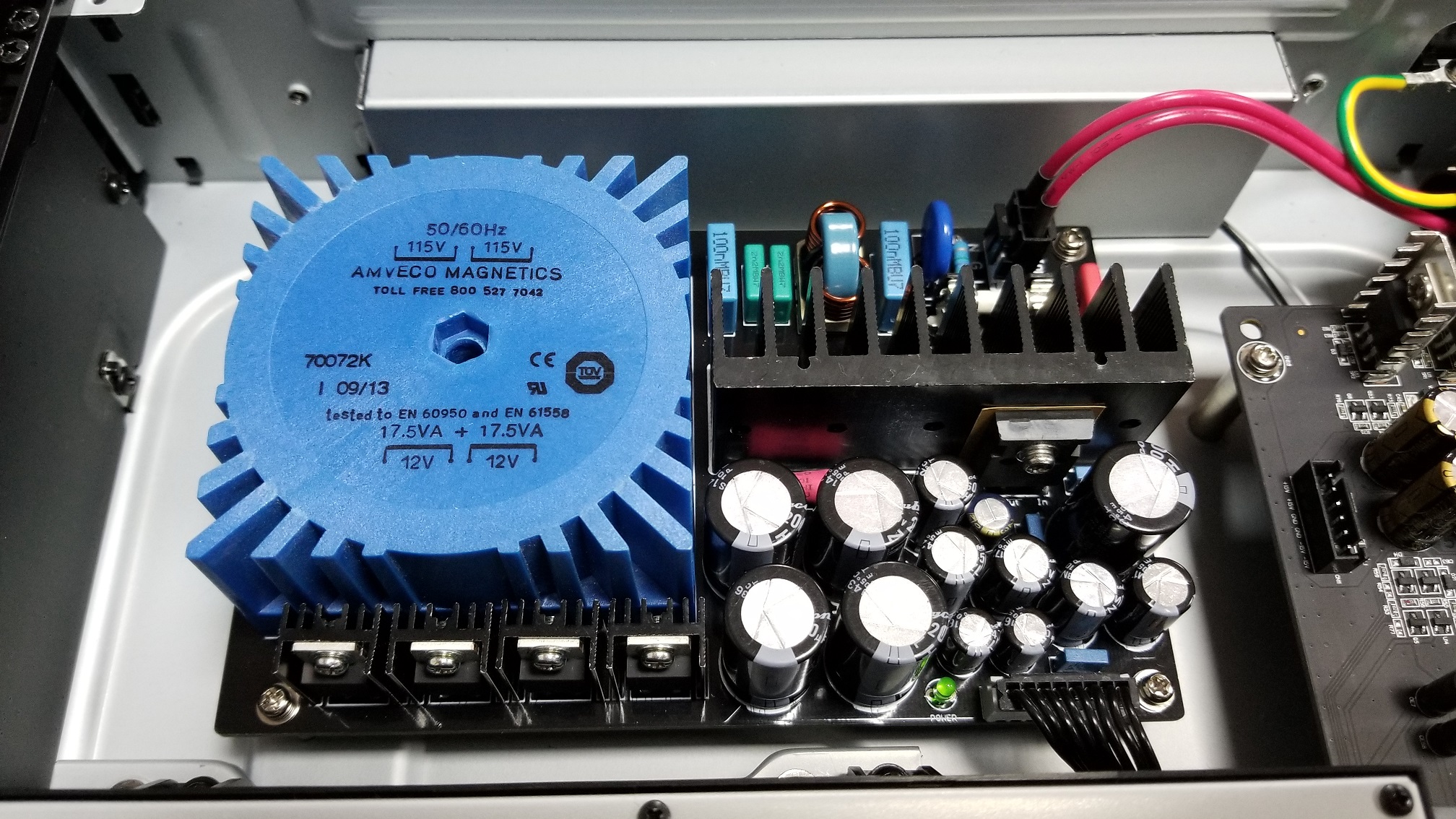

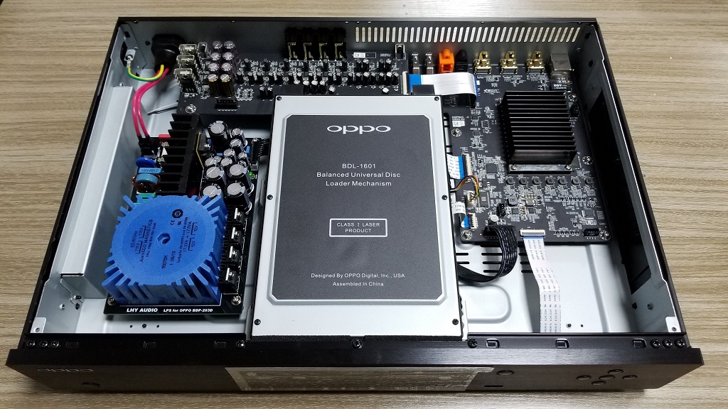

LPS board for OPPO UDP-203
I just finished developing the LPS board for UDP-203.
It is working nicely , perfectly replaced the orig swtching ps.
I use a Nuvotem 35VA onboard trans, opamp + mos reg circuit.
This LPS is suppling a DC12V to the main board only. No power to the DAC board, which I will never use.
Nice design.
I would like to point out that in case of not using (powering) the DAC board (203), the flat cable in between main board and audio board it should be disconnected, preventing so possible randomly functional issues (sections of audio board partially powered through the flat cable).

Looks neat. I have a question, how much more heat does it produce and also, can you feel the case being warmer?

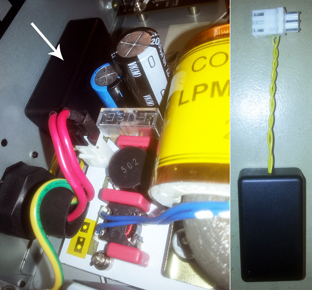

I think is a good idea using transformers. I thought at the same approach of using it to output from AKM DAC in 203. Not implemented yet as I intended to use Lundahls, and these are quite big for the available place inside (after modifications). I have also obtained very good results with my own post DAC analogue balanced stage (opamps). I already mounted Lundahl transformers in 205, and it is well working so far. I am still working in this field...
I may only say that using a linear power supply for digital stage is just a must and primary step to be done, improving everything dramatically. The original SMPS it will not affect the DAC output transformer in itself, but it inject lot of large spectre noises in the whole system. This is the main issue of the SMPS. I realised my LPM so to dissipate minimum heat (barely noticeable).

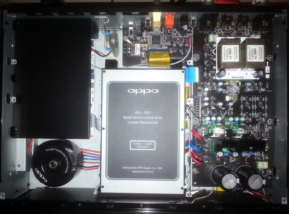

my 205...
Here is my (finished???) 205. Well, I can say that all the improvements are now in place, even thought some improvements it can be even more... improved.
I could chose very well the original post DAC analogue processing (improved of course), because the original opamps are very good quality components. However, I chosen to experiment with Lundahl transformers, and for moment I will let it so. Next step is to use another type Lundahls.
The DAC two available output channels are tied together. I use balanced output, but the existent transformers it allow simultaneous unbalanced outputs as well. DAC chip clocked by a 108Mhz SAW oscillator.
Very surprisingly for me, using the improved device, I noticed as the best by far quality signal, through USB in. Then I powered the digital input stage from linear power (from LPM dedicated section). A even more surprise: a really new sound. Astonishing details, dynamics, sound scene and resolution.
Quite nice so far....🙂
