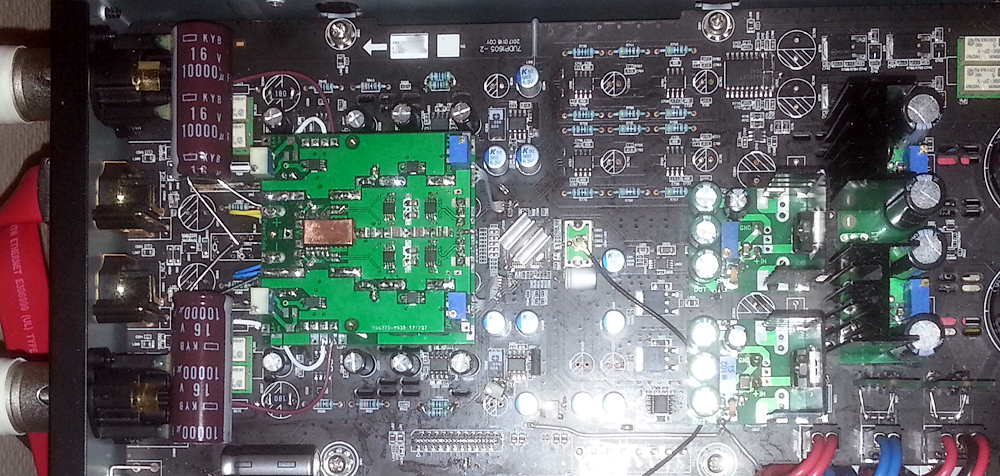

205 - active output module (stereo)
Finally, I could finish also the active stereo output modul for 205. Is based on OPA1632, and it sum two of the DAC output channels. DC coupled.
Now the ESS9038Pro it reveal indeed, its extraordinary dynamic...
