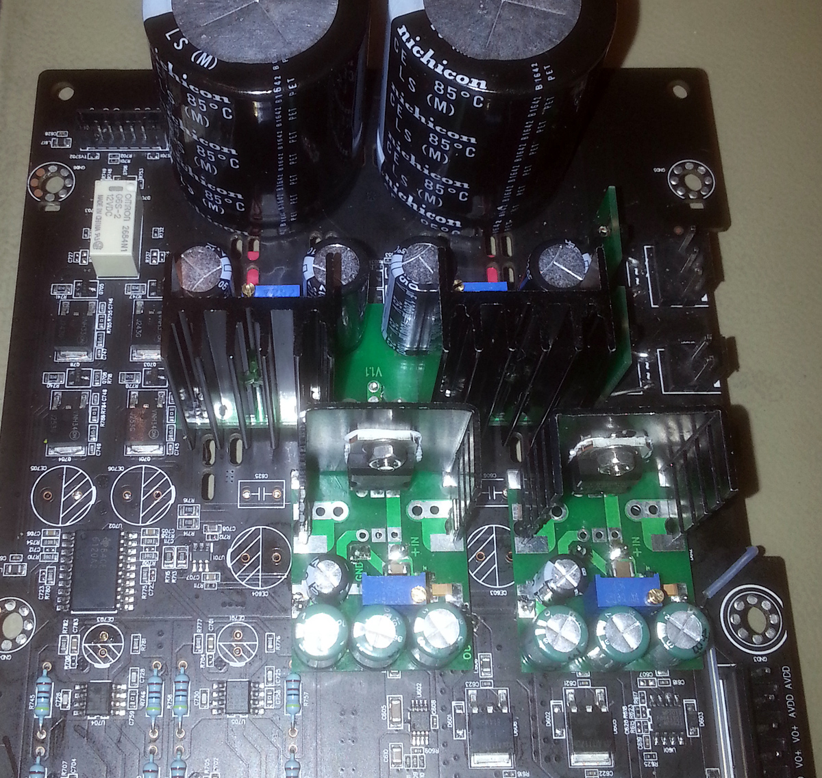

The analogue power system of 205 it suffer seriously by the wrong design. The ripple before low noise regulators is huge, as the loading of the main regulators, and therefore quite important heat generating.
Mainly, the device problems are related to its power system. The used SMPS for digital board it introduce lot of noises in the whole system. Oppo have found out a clever design solution, reducing the jitter on HDMI audio out. Well, the processor involved in this solution is clocked by a chip resonator... and everything is powered by a noisy SMPS system...
A dramatically reducing of the HF/large spectre noises into the system, is removing the SMPS (replacing it by a linear PSU). This is the first big step in improving the device overall performances. The second step is improving the clock system quality. The third improvement step is the analogue power quality (minimising the ripple and noises generated by the linear regulators).
I use with good results my concept for linear power module (LPM), based on very large filtering capacities. Also my clock system is unified powered by battery, and consist for 205 model of a 108Mhz master clock, which it clock directly the DAC chip. Then divided frequency to 27Mhz it goes to the main processor and HDMI audio dedicated processor. So, a synchronised clock signal is provided to the whole system. Well, a different oscillator it have to be used for optical drive decoder (25Mhz - not dividable from the master oscillator), but powered from the same clean battery power.
I completely improved the analogue power system (on stereo board) for 205, by adding two pre regulators for DAC power rails, and improved the regulation for differential power for opamps. Well, a much different output quality for both picture and sound...

Thanks Coris, for the detailed comments. It is not surprising that Oppo has taken some shortcuts to get this mass market device out at a reasonable price. Some of them definitely affect audible and measurable quality of results.
If your analysis is based on objective measurements and subjective keen listening, then maybe 205 is not really a great device just out of the box.
But the tweaks you suggest are quite advanced. One might have better outcome to start from scratch and design a 9038 based solution. Obviously if competence, time, money and other resources are abundantly available.

As I pointed out previously, there is not the DAC system in itself which is wrong designed in 205, but the implementation and realisation of the analogue main power system. The Sabre Pro chip it have all power rails treated by the (standard) book, two regulators on each L/R output DAC stages, and these it provide identical voltages, which is quite a performance for a production line. The problem (in my opinion) is that the AVCC DAC regulators (3,3v) are feed it from 12v, instead of under 5v for best noise figures. This it mean also unnecessary heat dissipation. Not talking more about the huge ripple presented at these low noise AVCC regulators input, because wrong design (poor filtering) of the main analogue power source (this for sure for economical/production prices reasons).
Well, redesigning the whole analogue stage for this device it may be a reasonable argument, but practically and financial it is not (both sides consumer - designer, if not the case of a mass production target). It is more convenient, cheaper, and less time consuming only modifying the original design...
Pictured hereby is my solution for replacing the original +/- regulators and adding two pre regulators for DAC power system.

.....Thanks very much for your very informative posts. Am I right that you've replaced the ELNA AUDIO 6800mf capacitors with Nichicon 22000mf? Also, why not Nichicon UKW series as they are specifically for audio applications? ThanksThe jitter improvement mechanism it refer only to the dedicated audio through HDMI output.
Can you tell us how much improvement after the mod? Thanks
Well, such impressions are strongly subjective... There is obvious improvement for both picture and sound.
Yes, I have replaced the original caps with Nichicon 22000µF. An important factor in choosing the caps are the dimensions, as it have to fit well in that place. Here is about filtering caps for raw power (after bridges). It is less important that "audio grade" specification for these caps in that place. Their are followed by low noise regulators, then decoupling caps. These caps are quite far from the audio active circuits.
One bridge on board is used for differential power rails (+/-), then the two others are used for the two DACs power systems. If the multi-channel board is not used, then one bridge it become available.
