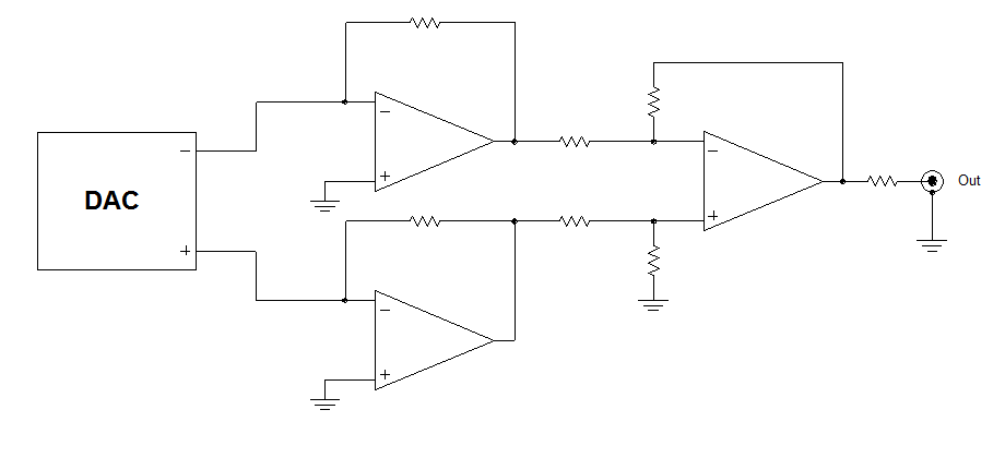

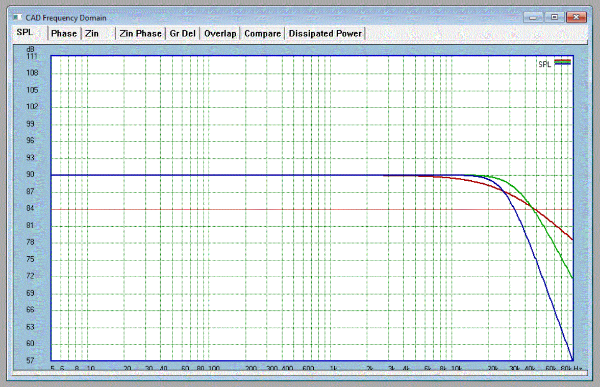

So here is a comparison, it will take a few posts to intermingle the comments as I am unable to link to them online.
But below is the first one, the difference between the 3 orders:
So the first is a bog standard 'Virtual Earth' I/V converter.

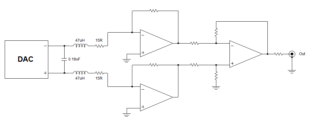

The second shows the added components, five per channel: Two resistors, two small chokes/inductors and a single capacitor.
I would recommend trimming the 0.18uF (or 180nF) down in value and aim for the flattest response at 20KHz. You might find that with 0.18uF it will be down a negligible 0.25dB, hardly a bad result, but some like 0.17uF or 170nF combination of parallel caps, will tweak the circuit.
But just try it with 0.18uF to get you started and if you like what it does, then tweak it.
The 47uH coils, we used some that was rated at 3A, so saturation is not going to be a problem.
We also unwrapped the wire and much less than a metre, we remade them with better wire, so that can also be a later tweak, but the coils did work standard quite well.
OK, up to you to try it. Cheers, Joe.

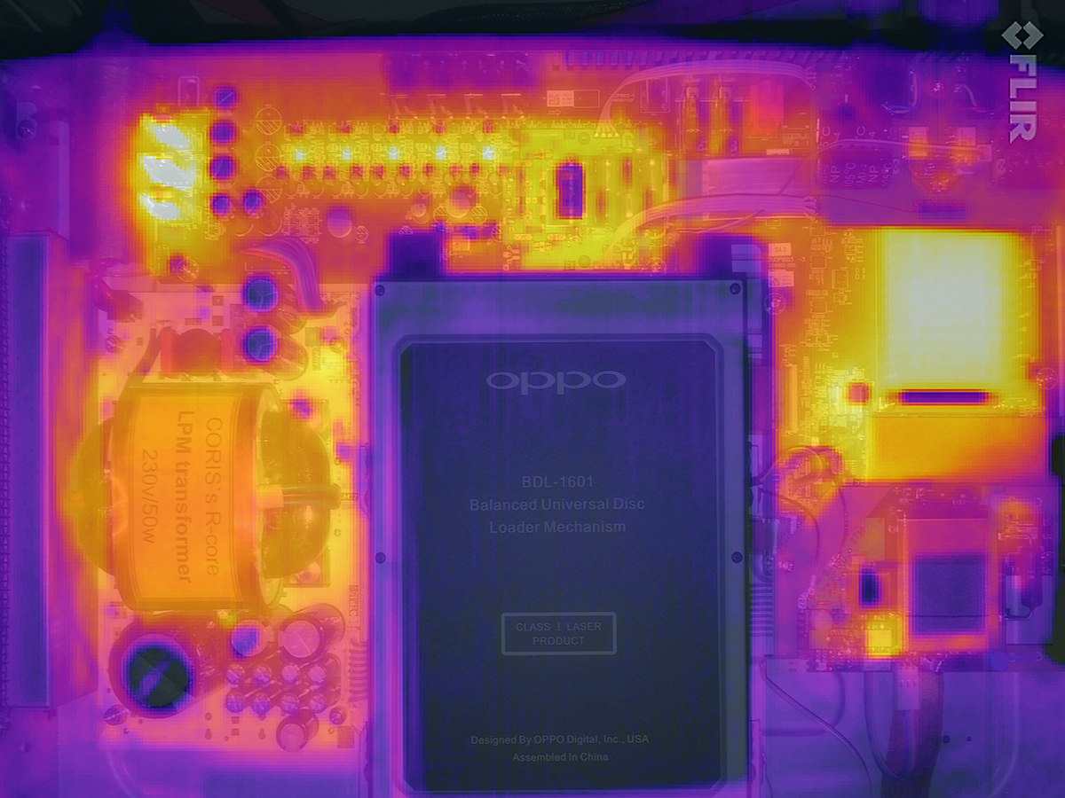

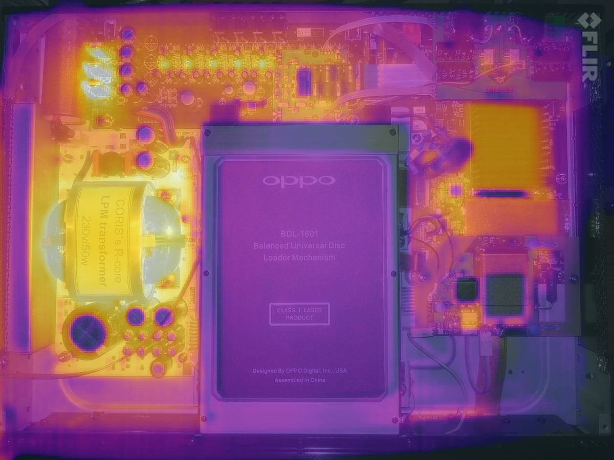

That's one way to put a cool toy to use Great Pic!
A "thermal" picture of my modified 203...

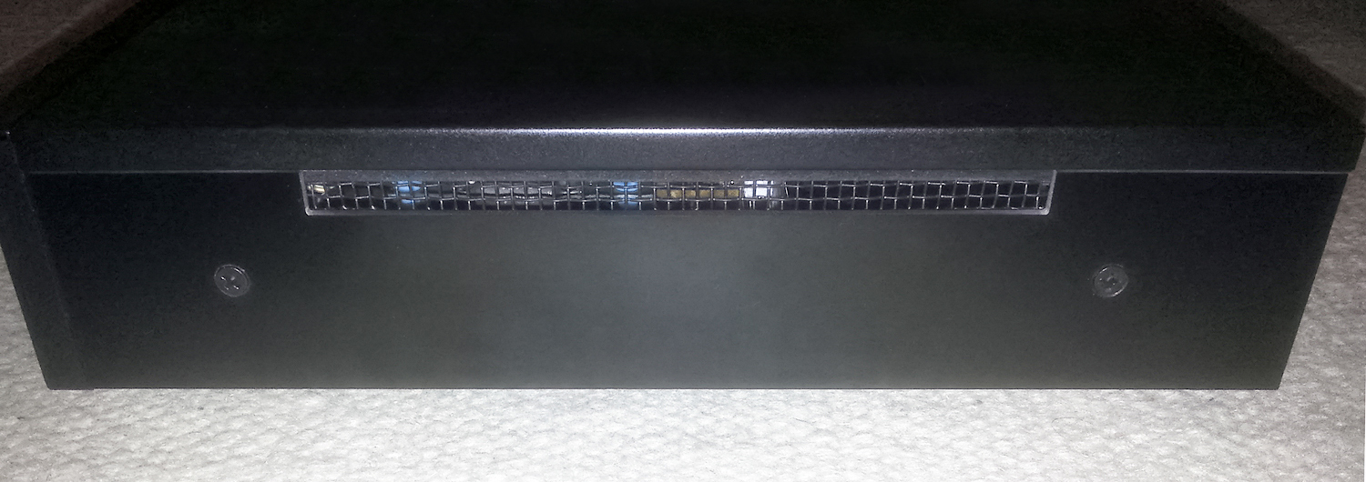

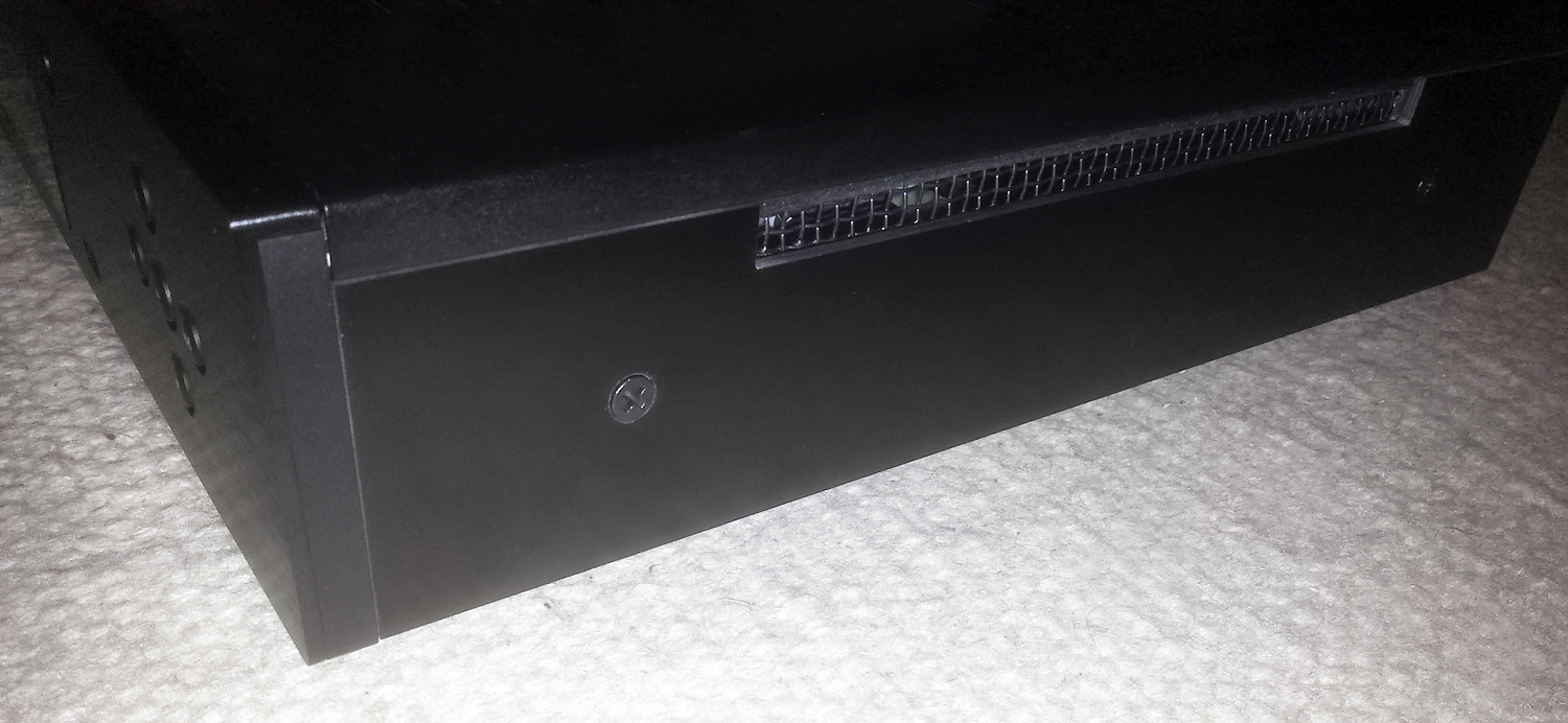

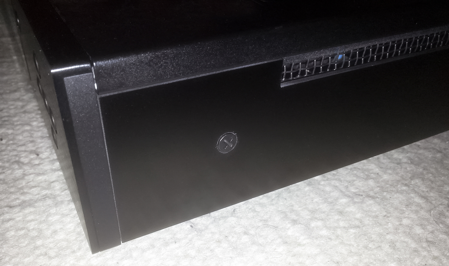

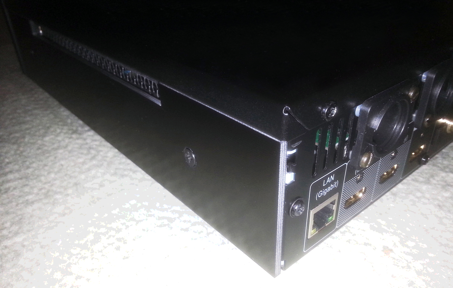

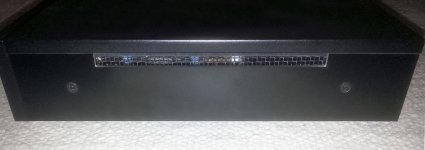

In the last time I redesigned and produced new side panels for 203. A better version of the improved ventilation approach for this device (with the linear PSU inside)...
