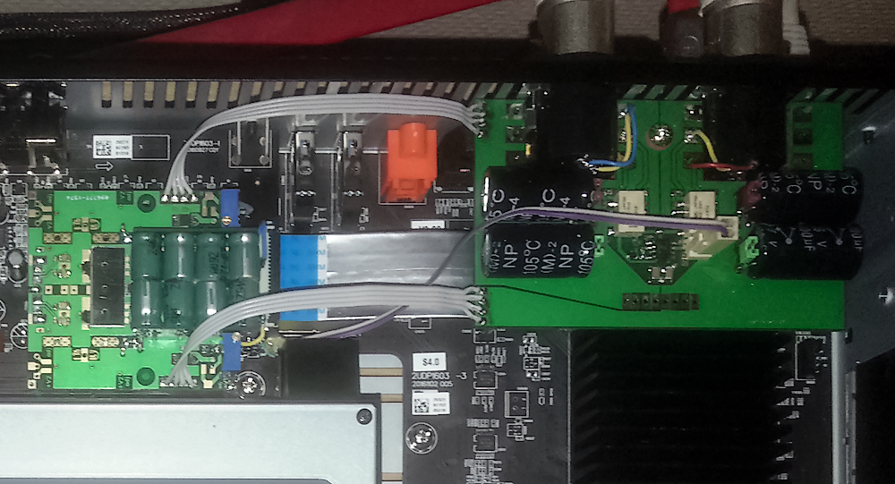

This is my solution for the AC/DC coupling selector. It fit for both 205 as 105 models. Here in picture, it is not yet connected to the output caps.
Oppo could very easy (and simple) implement a such selector into the stereo board design, giving the option to the interested user to chose the output type, for his particular configuration.
The Easiest solution is just to solder a wire across the output coupling capacitors. This is what we did on the 105, and there was no significant DC offset.
Why not just do this again for the 205?
E
Yes, of course this is the easiest way. Especially when one do it only once for himself. If one may want to experiment different configurations, or gears connected to an such player, then it could be fine to have a (more convenient) option to change/revert the AC coupling, to an direct. However, my proposed solution it is not a must. A simple wire it solve it as well.

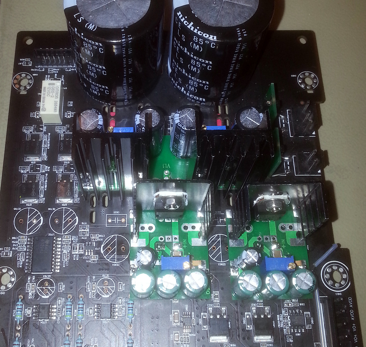

My improvements so far, for the analogue power stage of 205.
Massive primary filtering capacity. Replaced the original rectifier diodes, with Schottky. Replaced the original +/- regulators with LM2991/2941, mounted on a new designed module. Added pre regulators for DAC power rails: one regulator for the digital DAC power rails, and one regulator dedicated to the analogue power rails (AvccL/R). This last pre regulator it use the multi-channel board DAC power, which it became available, as I will not use that board/outputs. In case the multi-channel board should be used, then there is a solution, by keeping this pre regulator in same place.
I kept the original regulators for DAC in place for moment. BTW, the DAC AVCC power is original done by the book (ESS9038Pro datasheet). Oppo used a dedicated ADM7151 for each of the L/R rails, and it succeed the production line performance to have two precise equal voltages for these rails. So, I appreciate there is no reason to replace these very good regulators, but only I improved their filtering capacities in/out.
The main problem for the original analogue power stage is the very high ripple at the low noise regulators inputs, because a wrong dimensioned power source as poor filtering. Now is corrected and improved.

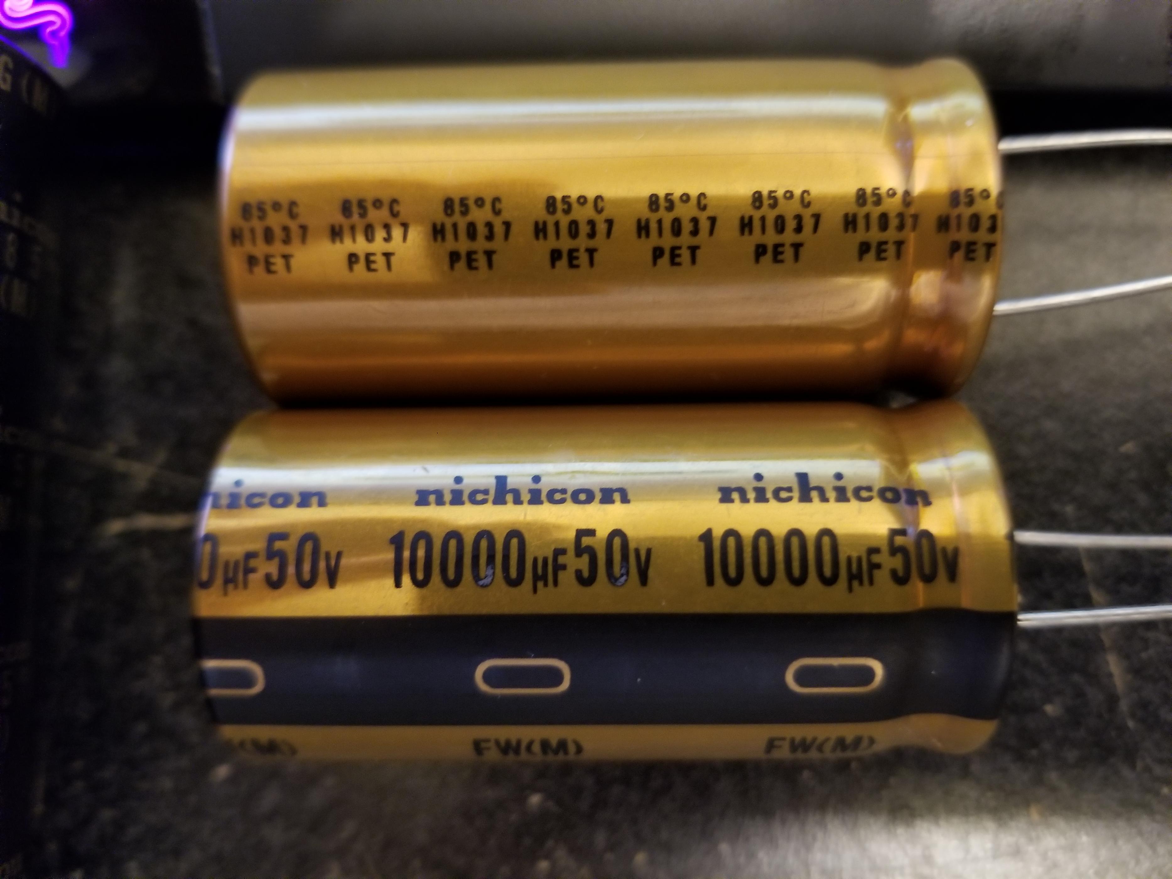

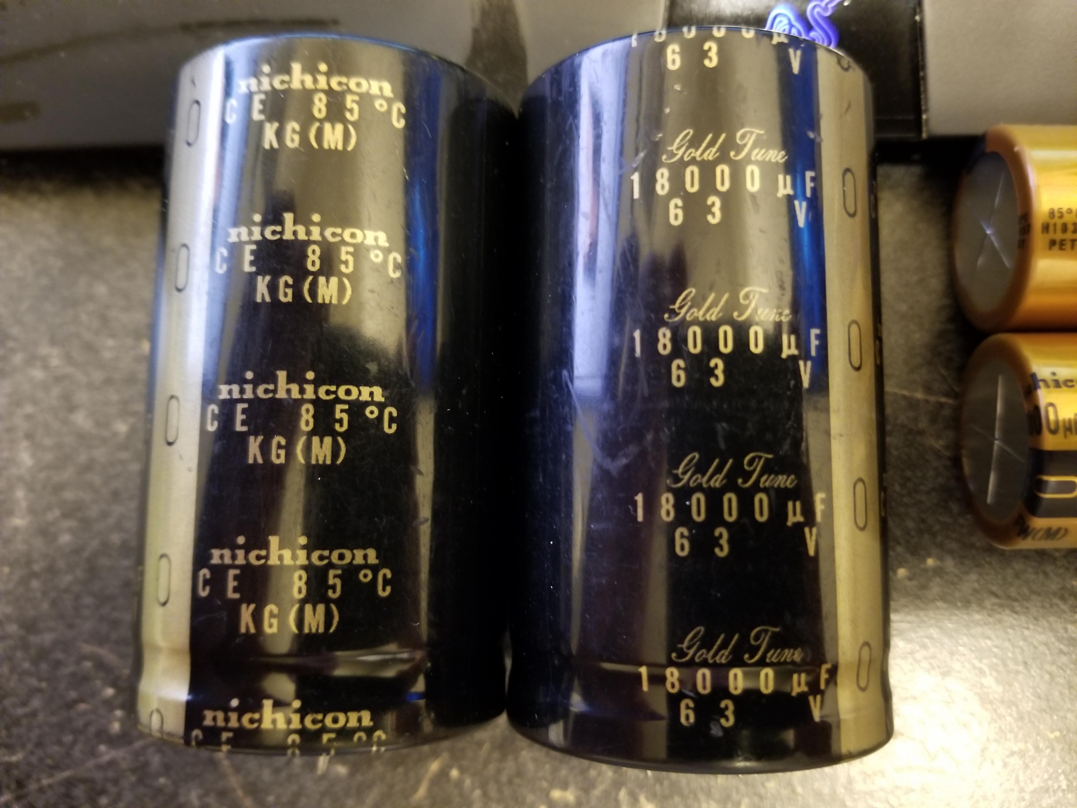

Hi Coris, I had these caps left over from a project I did not complete, would I be able to use one of the pair of caps in the pictures to upgrade the Primary Filtering on the Analog board, providing I have enough room? Which one would be better if so, and again providing they fit.
I suspect the caps you have it may be too high to fit into the available place. These caps should be into 40mm high, and max 35mm diameter to fit so as it are original mounted. Else it should be mounted on the board downside.
Also a 10000µ is not a big deal to have in that place, and definitely not necessary 50v rating. As lower the voltage rating, as smaller the dimensions. In that place 25v is perfect. The value should be chosen as high as the dimensions it allow....
However, only replacing these main filtering caps, it may not solve completely the ripple problem, but only for +/- 12v rails. DAC chip power it suffer for the same issue (much too low filtering capacity).

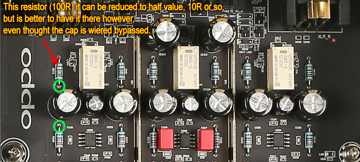

Concerning the resistor on the signal path after the AC coupling caps, I recommend to keep it in place, even thought its value it can be reduced.
For those who may want to try (wire) bypassing the AC coupling caps, without removing the caps, or even not dismounting the board, I suggest connecting together the marked points (green circles) on the picture hereby. The same for those who may want using my selector.
For a quality AC coupling, the original caps it should be replaced with non polarised ones, as bypassed with some film 1-2µF caps. If you are sure your preamp/amp it is AC coupled on its inputs (caps or transformer), then wire bypassing is the best choice.
