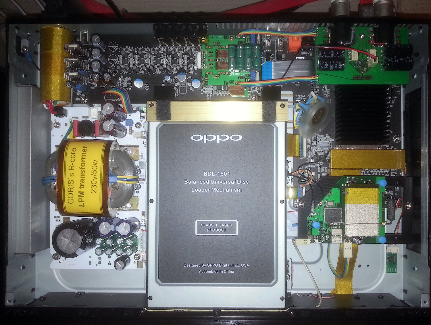

Coris, are you offering upgrade solutions for the 203?
Yes, I do. You have an example for the last version of my full 203 upgrade in the post nr. 246.
In your case, using 203 only as digital transport, there are the linear PSU (LPM), and the clock system to be in place. Well, some other small improvements as well. Please PM for more details.

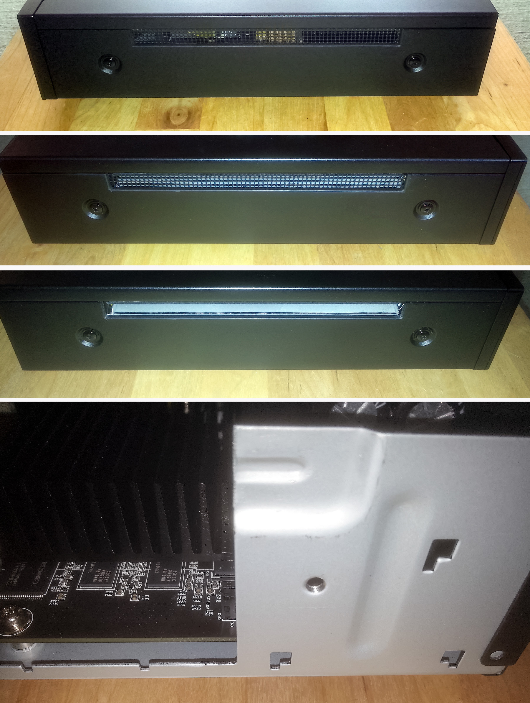

Improved ventilation 203
A solution for ventilation improvement in 203. Especially when the device is powered by a linear PSU. In addition to these windows in lateral sides of the enclosure, I use a fan inside, which it create a airflow from one to another of the cutted windows (admission right side, exhausting left side).
The windows are quite easy to be created, as the lateral sides are made of plastic. With adequate tools one can get a very aesthetically result. The metal chassis upper parts should be catted out, as shown in pictures.

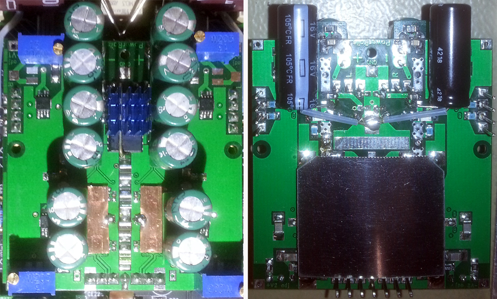

Improving analogue audio outputs for all Oppo models
My new version fully differential XLR/RCA output module. Now with TPA6120 as buffer for RCA out. Ultra low noise regulators for each differential stage (OPA1632), with huge decoupling capacities.

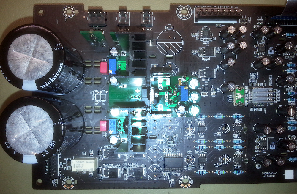

Mods Analogue Power system - 205
Well, finally I started the improvement process for the analogue power system on 205. Replaced the stock rectifier diodes with Schottky bridges. Replaced the +/- regulators, with an adjustable LM2991/41 regulators module, as added pre regulator module for DAC power rails.
Also first step in improving the clock system - soldering in place the UFL connector for stereo DAC new clock input...😉.
Quite much more to be done further...
