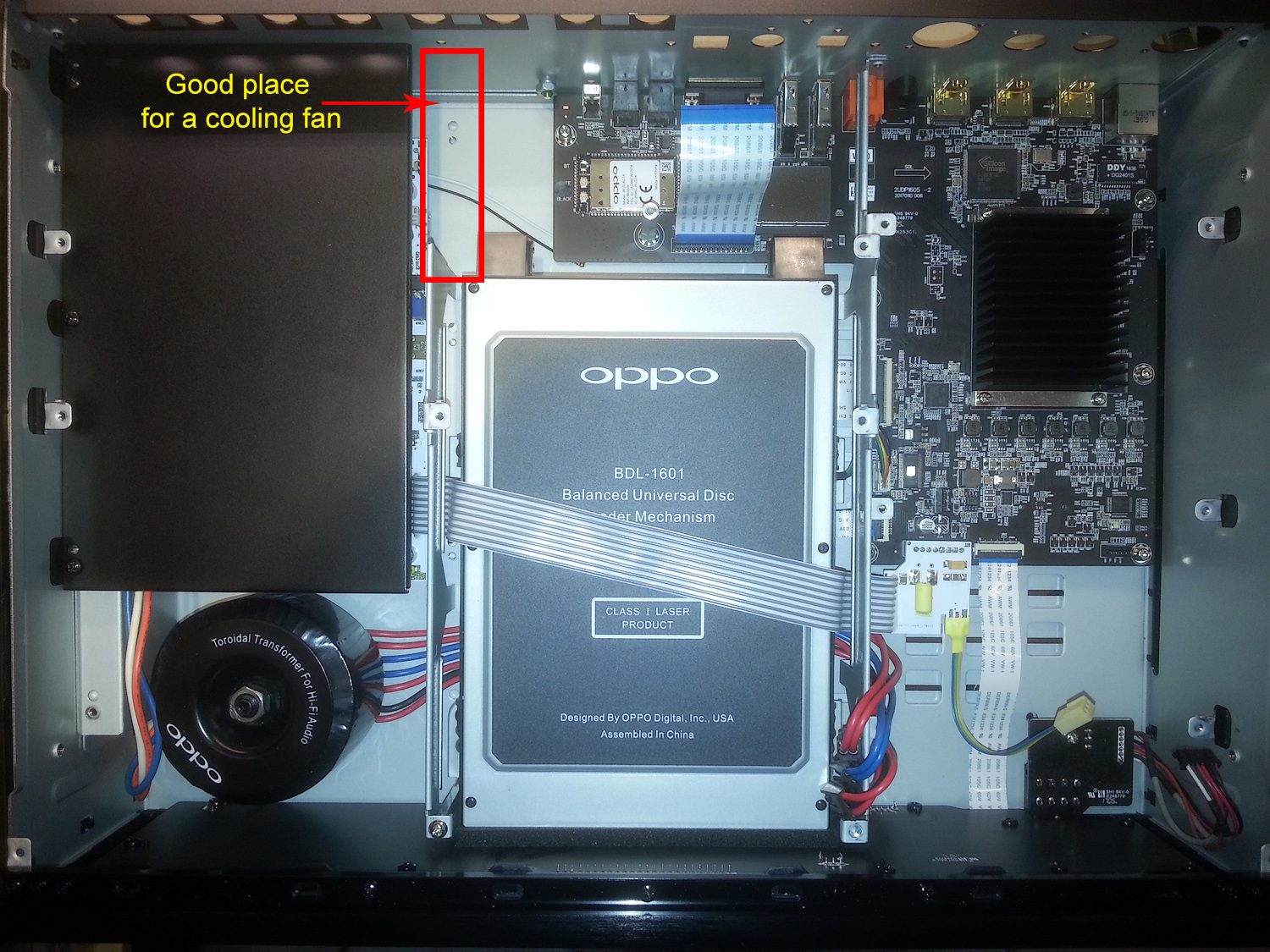

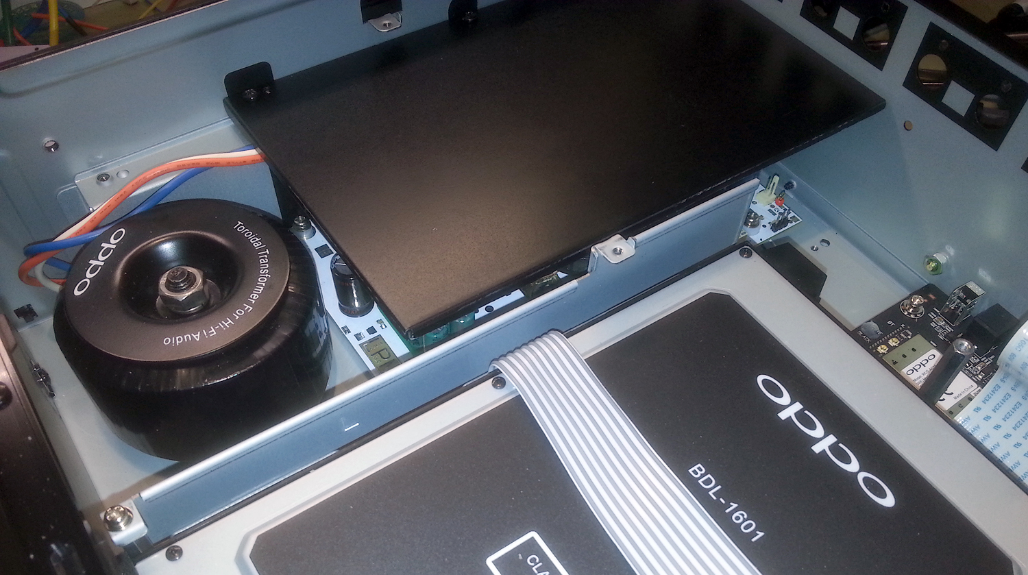

My (latest version) linear power supply for Oppo 203 & 205...
Received my order of Coris' LPM for 205 yesterday and found some time to install it today.
Build quality is superb! I'm not a technical guru but I managed to install it in about 1.5 hours, taking my time to make sure that it was done correctly.
Let the burn in fun begin! I'll report back with my impression after some burn in.
Joined 2009
I can say now that the LPM approach is finished for my 205.
Accordingly to a pertinent observation, the transformer in this LPM it may be too close to the multi-channel board. As this linear type of PSU is not recommended to be covered (it need ventilation), even the original cover for former SMPS it may fit in its place, it should not be installed as it is.
I appreciate as a good solution, the cutting of the lateral sides of the steel cover (without distorted its shape). You can see in the pictures hereby how it was done the steel cover processed, and the final result. Also, another steel plate could be used for the same dimensions, or even smaller, to cover only the transformer, and magnetically shield it against the multi-channel board above it.
I installed the original modified PSU cover using 2mm spacers on the original fixing places, so to have it a little bit higher.

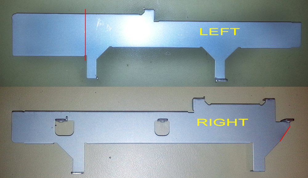

I found necessary that the bracket beside the optical driver (on the LPM side) to be cutted so as the pictures shows. This bracket modification it improve the LPM ventilation and it make the available space good and ready for placing a fan into it. This fan it will help a lot for the LPM ventilation, as for the “first floor” of the whole device too.

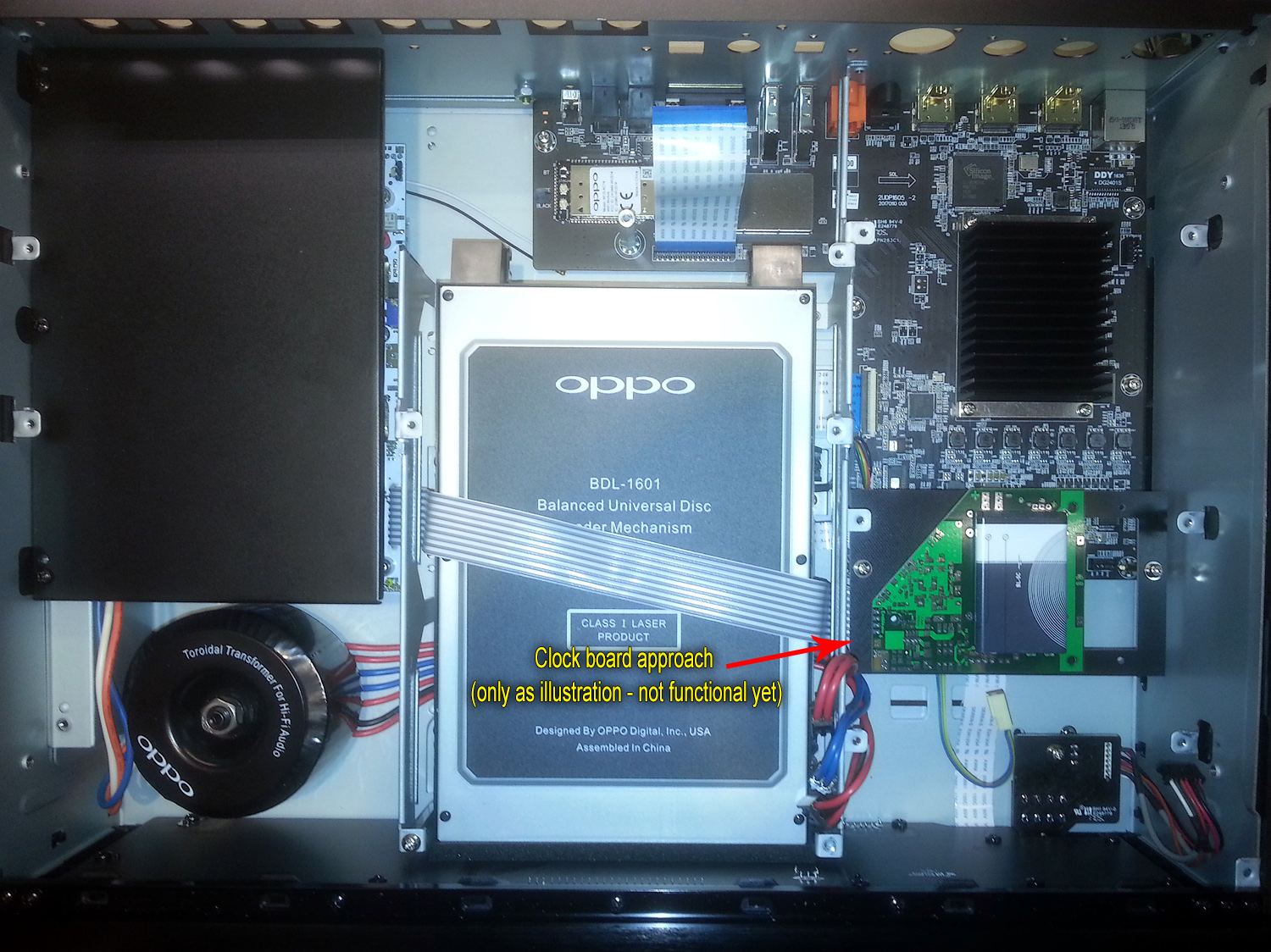

Next step it will be modifying the clock system, implementing my new version clock board, which is also modified mainly for the use of a smaller battery. The whole clock board it became smaller so, the smaller battery it charge faster; there is a better air circulation around it, and so on. The picture here it only illustrate the approach.

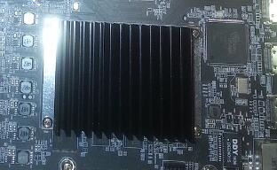

Any photos of below the heat sink?
Joined 2009
I see... I do not have such picture, as I did not removed this heatsink (yet). I had not so far the reason doing so. I must say that is not very easy to remove this heatsink, as it is soldered on the PCB. I could see that this heatsink it have thermal contact only with the processor, through a thermal pad. Not very good solution for best thermal transfer, but a convenient solution for the production line. My appreciation is that this section is not very important to focus on, at least in fist instances...

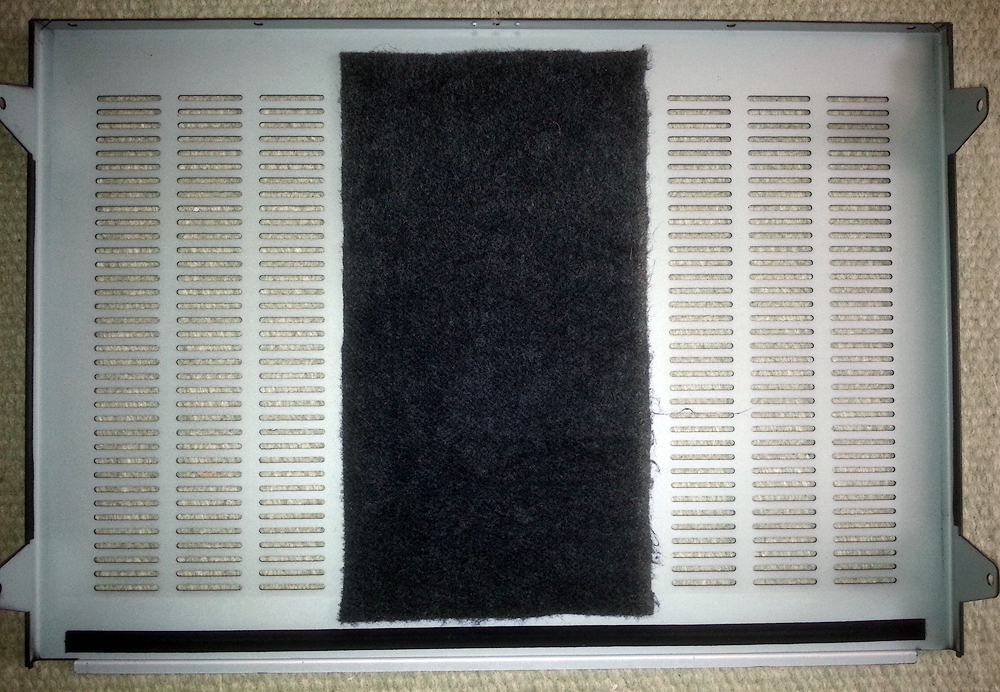

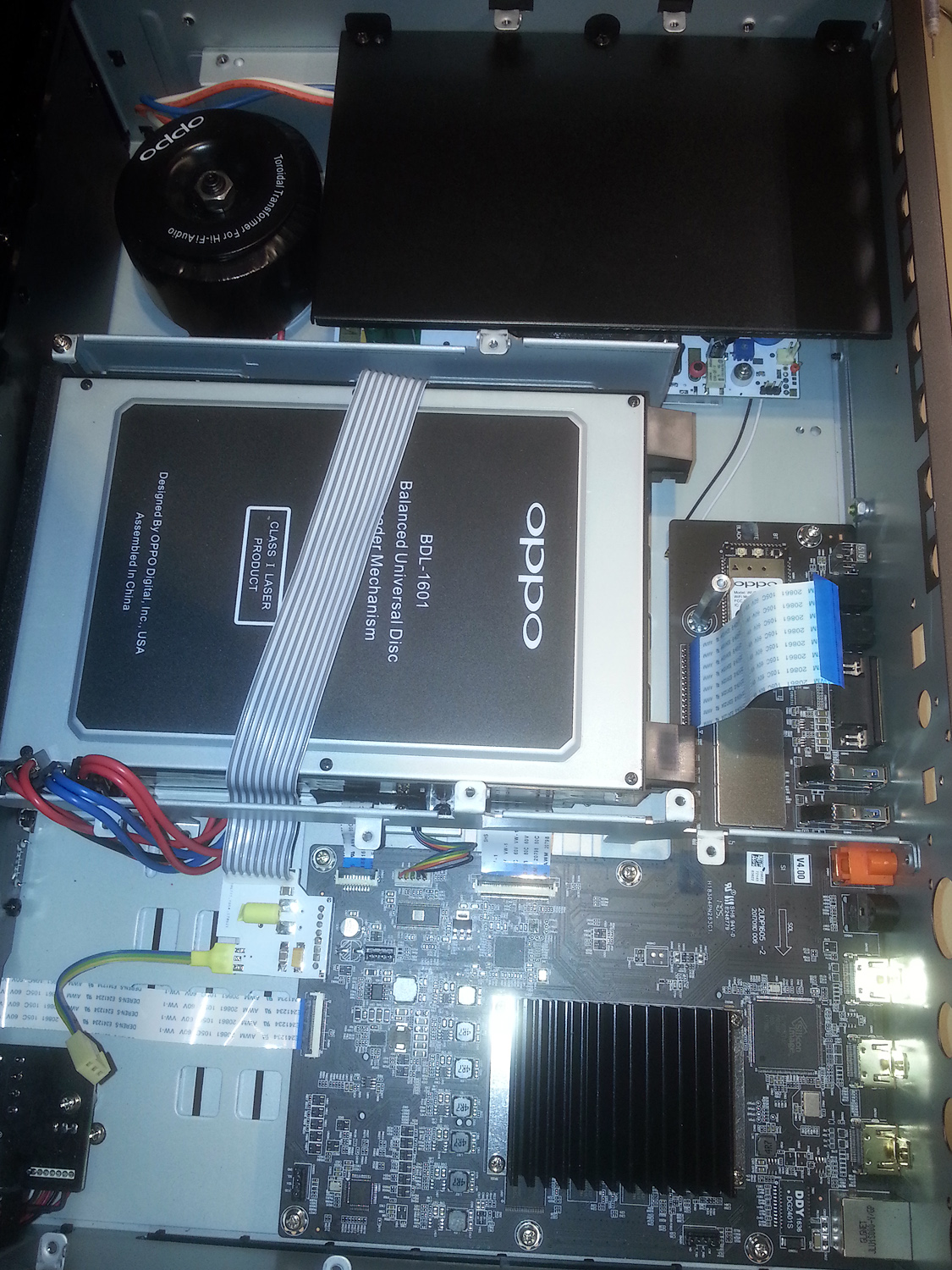

Well, the first step in modifying/improving the 205 model is finished now (I presume...), and it looks like in the picture hereby.
LPM in place, as the forced ventilation too. To create an efficient ventilation airflow, I covered the central perforations area of the cover, as you see in picture. So, the airflow is directed somehow by the fan, from the right side of the enclosure, to the left one, and out. For this approach to work properly, there is necessary cutting the chassis brackets as also shown in picture.
BTW, I still use the headphone out as line out, which it provide (in my appreciation) the best signal quality so far...

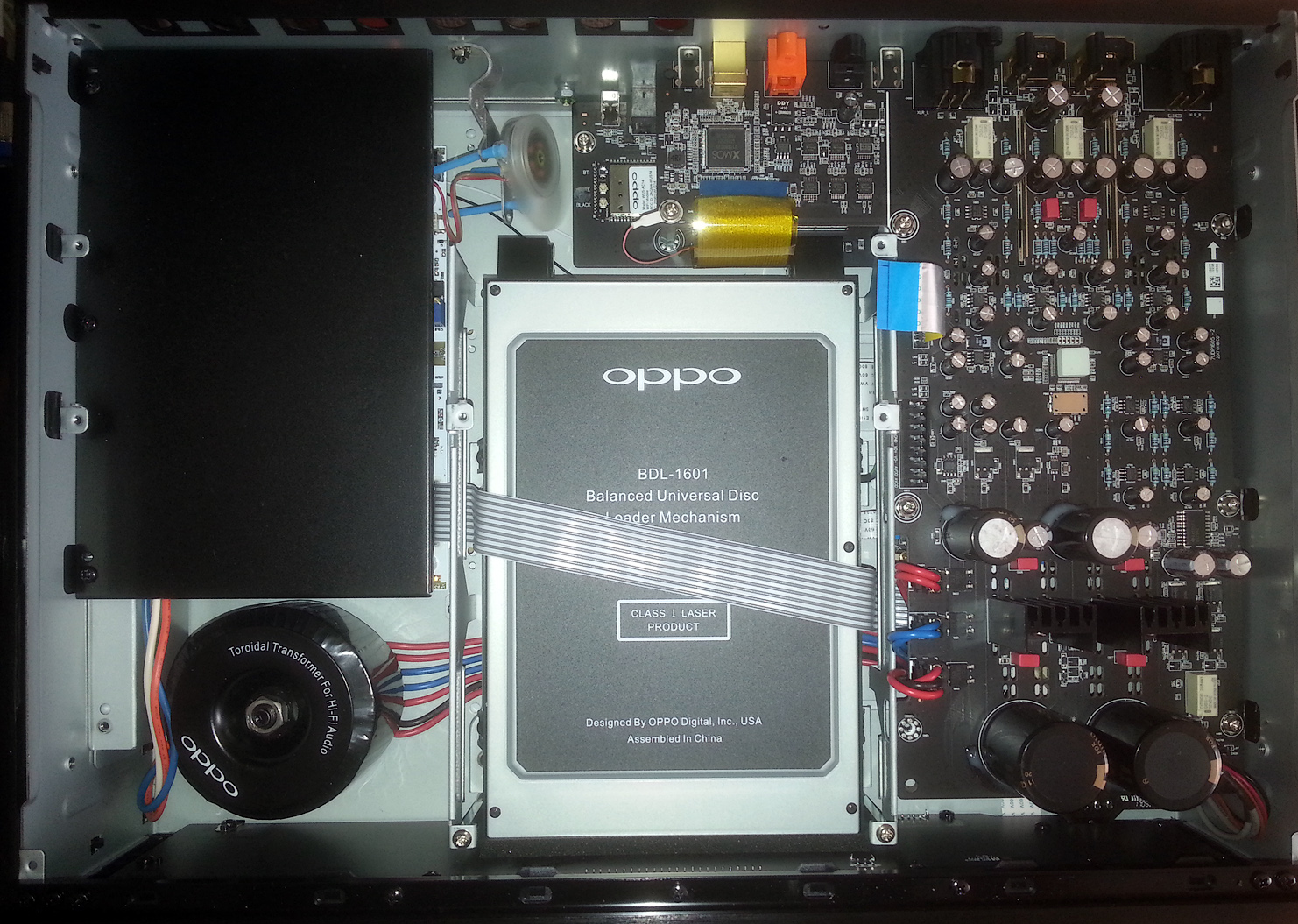

Finally, I had the opportunity to take a closer look at the power system on stereo board of the 205. What I found? Not something very pleasant, I can say…
The positive regulator for opamps +/- power rails is a LM2940 (fixed 12v). The negative regulator is just an ordinary 7912… The toroïdal transformer it provide 2x14vAC for these +/- rails, which in DC it result (on load) 2x18v. Well, regulating from 18v to 12v, it mean that are at least 4v per rail, which it goes into the heat generation only… It could be enough 15v here to produce a well-regulated 12v, reducing so the heat generating… Not done it so, as Oppo designers may like the heat inside, or they does not know how to reduce it…
Most surprisingly is not this wrong energy balance of this section, but the ripple level, which is around 200mV at the regulators input… This is mainly because insufficient filtering capacity…The +/- 12v regulators outputs, are filtered by 1000µ…
The toroïdal transformer it deliver also 2x 6v AC, one for the stereo DAC power, and the second for multi-channel DAC power.
I have measured (on load) 6vAC before the rectifier bridge, and 6,3vDC after the bridge (filter cap – 3300µ/50v). Here is the big surprise! It have to be something quite wrong when a transformer it deliver 6v AC and in DC (after rectifying and filtering) one can find only 6,3v. There is obvious that the transformer it not fit with the necessary current required by the further circuits, and the filtering for these rails is very bad. There is a mystery how Oppo designers, have accepted a such wrong power approach for the analogue stage of a (advertised) high quality and performant model as UDP205. But this is not enough…
The ripple I have measured on this main 6,3V DC rail for stereo DAC power system is as high as 350mV! A very nice 100Hz saw shaped frequency over the DC power at the inputs of the “low noise” regulators for the DAC chip power rails… By the way, the 100Mhz oscillator which it clock the DAC, it is powered by the same 6,3v DC rail with this 350mV ripple on it… It is good so? NOT definitely!
I just started the extended improvement procedure for this stage…
