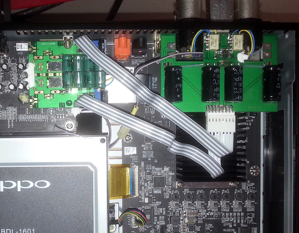

I added now (on my list) a new improvement for 203 model: the stereo XLR output. The result is quite spectacular. I never thought the AKM4458 it can sounds so well, with so good dynamic. A revelation!
For the first time I could hear the differences in between the digital filters available in the device menu.
I added a modified version of my fully differential output module, based on OPA1632, and powered by ultra low noise regulators for both +/- rails. Then relays mute circuit. Of course the whole power system on audio board is improved, included the DAC chip power system. All the unbalanced original outputs are still working, while the XLR modul it parallel the stereo channels connected directly to the the chip outputs.

101 it have a AKM DAC inside. I have to admit that the AKM (used in 203) it sounds very pleasant and well, when the post DAC processing it is do it right. Not the cases with stock Oppo 101 and 203, where the sound stage is meant more as an accessory, and not as a main high quality function (as it was meant by Oppo for 205).
My last appreciation is that a improved audio bord in 203 it can sounds much better than a stock 205. However, the logic says that the Sabre Pro DAC inside the 205, it have to sounds accordingly better, as it is an another quality class DAC chip, than AKM it is. I had not the time yet to proceed to the 205 extended improvements, so I can not say more at the moment.
Also you may know that applying improvements for all 8 channels in 203, and maybe all XLR is just not possible, because the available space does not allow such approach. The audio board should first be designed different, but I`m still be sceptic about the available space inside the actual enclosure. At least there is no place for 16 XLR connectors on back panel...
Almost the same for 205 about XLR approach. One is limited to the use of RCA approach for multi channels. Of course even unbalanced, it will sounds different with the accordingly improvements...
I will tend to say that is more worth to invest and improve an 205, even thought the 203 is surprisingly good on sound with an improved audio board. However, the XLR approach implementing is limited to two channels for 203. Also for 205 as well, but we may keep in mind that the two channels stage in 205 it have a dedicated DAC, as the multi channel stage too.

This is my XLR mod for 203...
