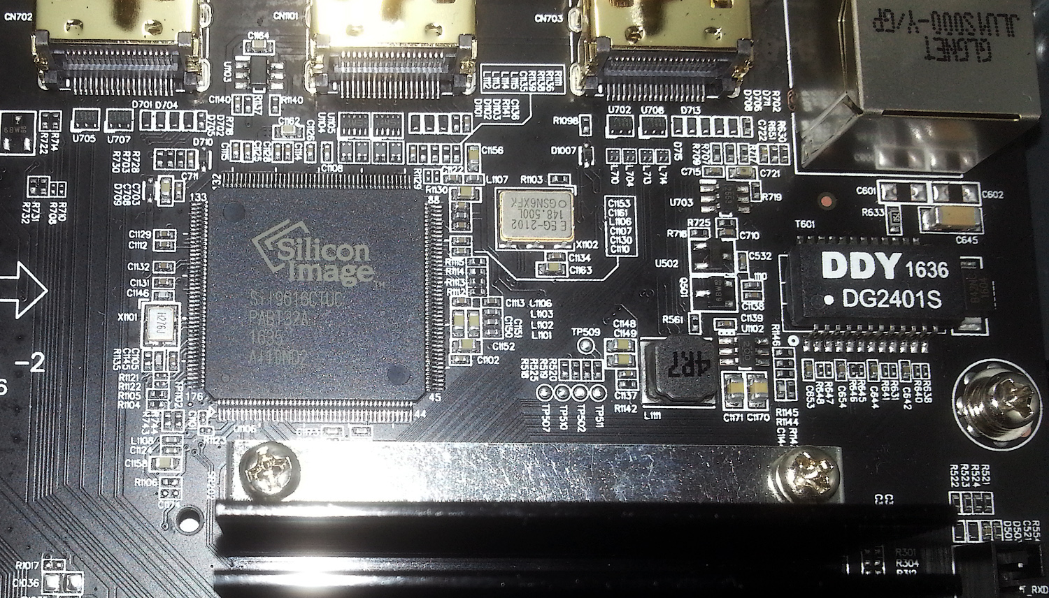

I had (finally) the opportunity to get a little bit more into my 205. Some considerations about the digital board.
The board is mounted a little bit higher than in the old model, to allow a better ventilation. The main processor it have a very thick thermal pad under the board, to help it dissipating better the heat. The digital board it can not be taken out from its place, without dismounting the back panel. I noticed that the very short flat cable connecting the stereo board with the multi channel one, is carefully shielded. The larger and longer flat cable connecting the digital board with the stereo board is not shielded at all. Bad!
I examined a little bit closer the clock system on digital board (pictured here the clocks around main chips). The Silicone Image chip is run it by two clocks: a 27Mhz one, and a 148,5Mhz SAW (see the Oppo description about this clock approach). The SAW oscillator is outputting in differential/balanced, which then is converted to unbalanced by a dedicated chip placed on the board downside. The unbalanced clock signal it goes into the Silicone Image chip, doing its job as Oppo described. The main processor it still have its own 27Mhz clock (resonator) on the board downside.
The same clock approach for the optical drive processor (25Mhz) as in 203.
My first conclusion is that clock system in 205 is a little bit more complicated than in 203 model, and the work to improve it it will be accordingly bigger.
The 148,5 Mhz clock it can not be touched, as the frequency value is customised and that`s it. I would like to improve the power supply for this oscillator, and maybe the one for the Silicone Image chip (right beside it as you see in picture).
The 27Mhz resonator for the same SI processor it have to be replaced, and I have already an output free on my clock board for this one. The same for the 27Mhz resonator for main processor, and the 25Mhz for the disc drive processor.

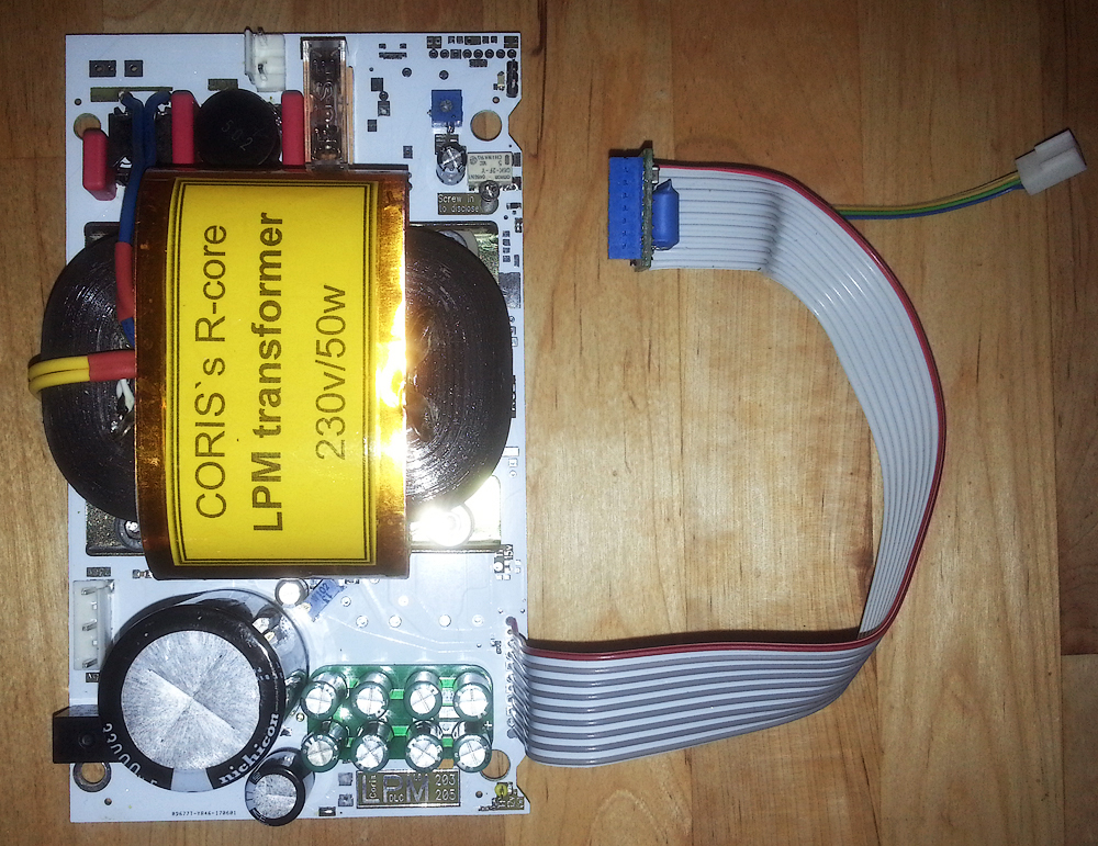

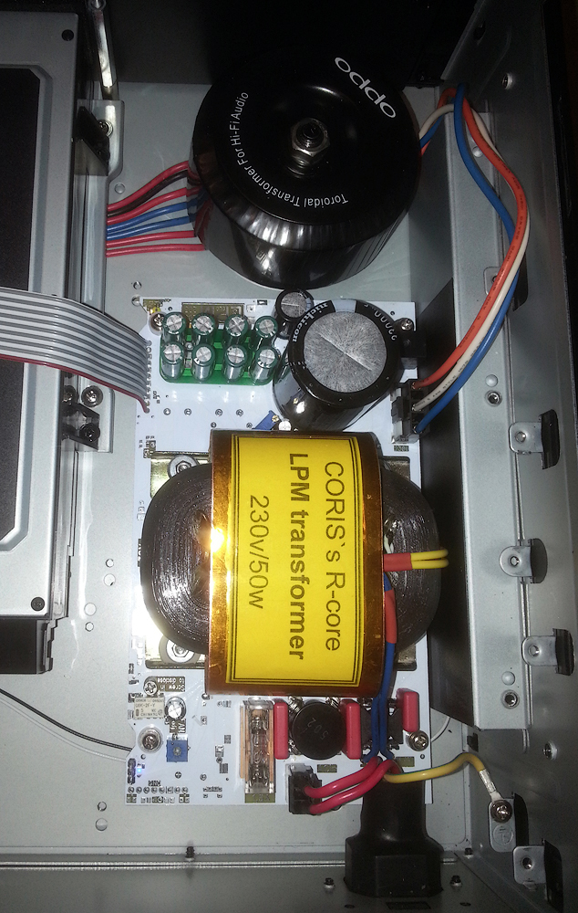

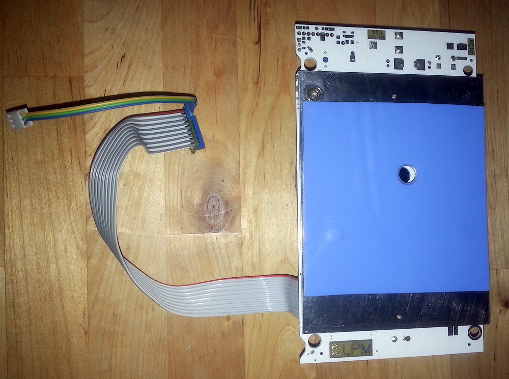

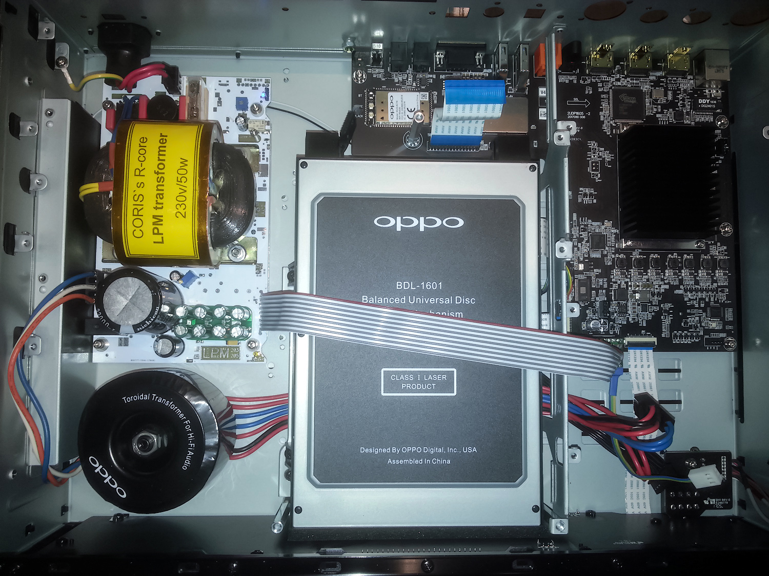

Well, my LPM for 205 model is finished and at work...
I added an approach for much easier detach from the chassis (if necessary), as now the thermal pad it have a larger surface, and the adhesive force is very strong.
The older (original power cable) it seems is placed under the optical drive before mounting it as for this model (optical drive very low), it is not possible to pull that cable out, but only cutting out one of its end connectors.

You know, I haven`t yet the available time for this simple test. I have only tested it with the main board connected, but not yet any functional test for the whole device.
It looks to me that you will have the opportunity heaving such impressions before mine...😀
So far I`m very impress about how a 203 device it behave and perform for both sound and picture, with this LPM in place, as other improvements as well...
However, soon I will start to work on 205...🙂 I assume 205 it have to be better...

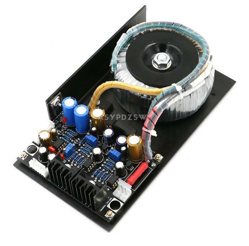

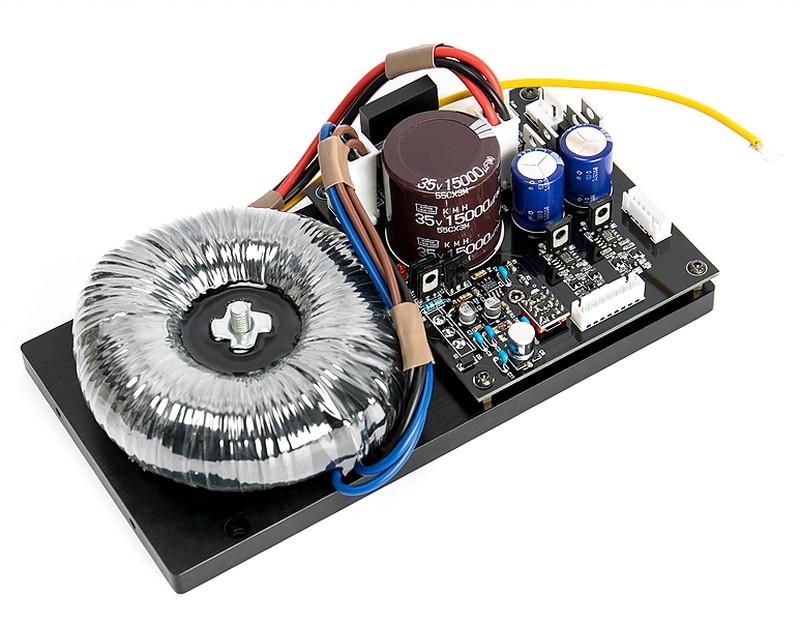

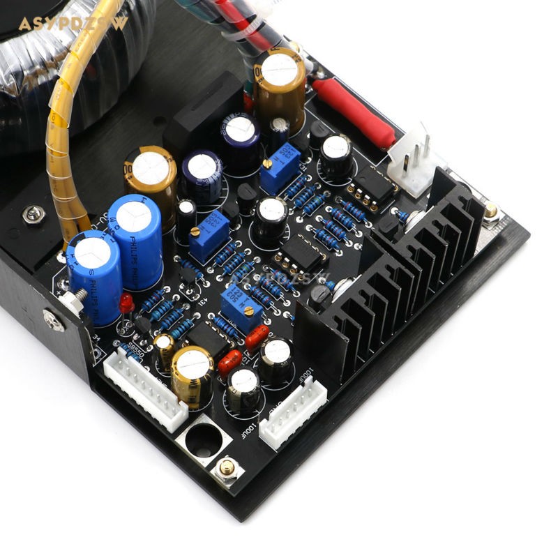

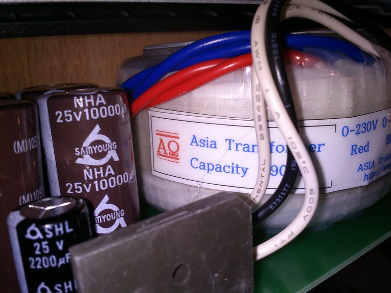

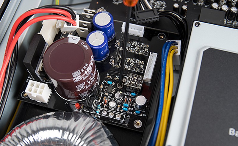

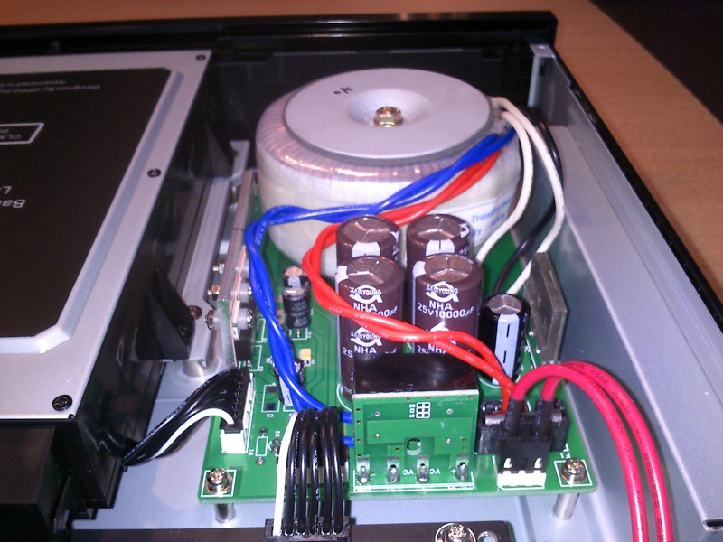

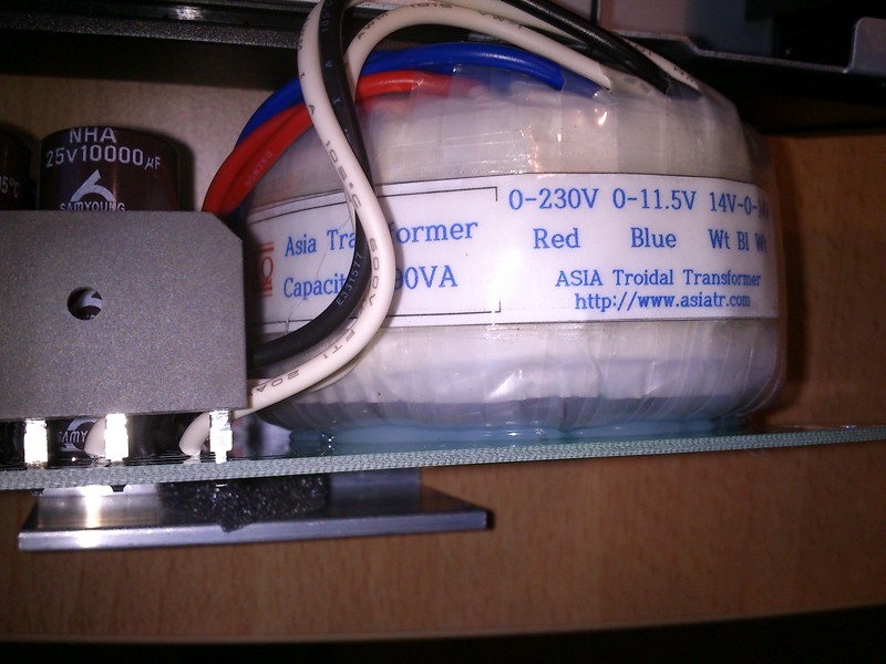

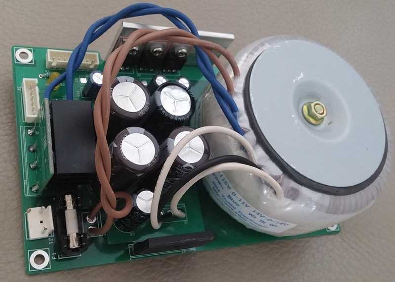

Which LPM MOD is best?
Dear Members......
For these 3 Linear Power Module MOD's (for the Oppo UDP-203) there are no detailed spec's available(at least I can't find them).
Is it possible, just on sight, to predict which of the 3 would produce the "cleanest" power. Two seems to have more, and a some "smaller", components on them. The other one has a bigger transformer and seems to have less components.
If I would buy one..... which one should I choose....😕
(price is not the issue here, just which one would gives the cleanest power)
Jack
Option 1: picture 1,2,3,4
Option 2: picture 5,6
Option 3: picture 7,8
