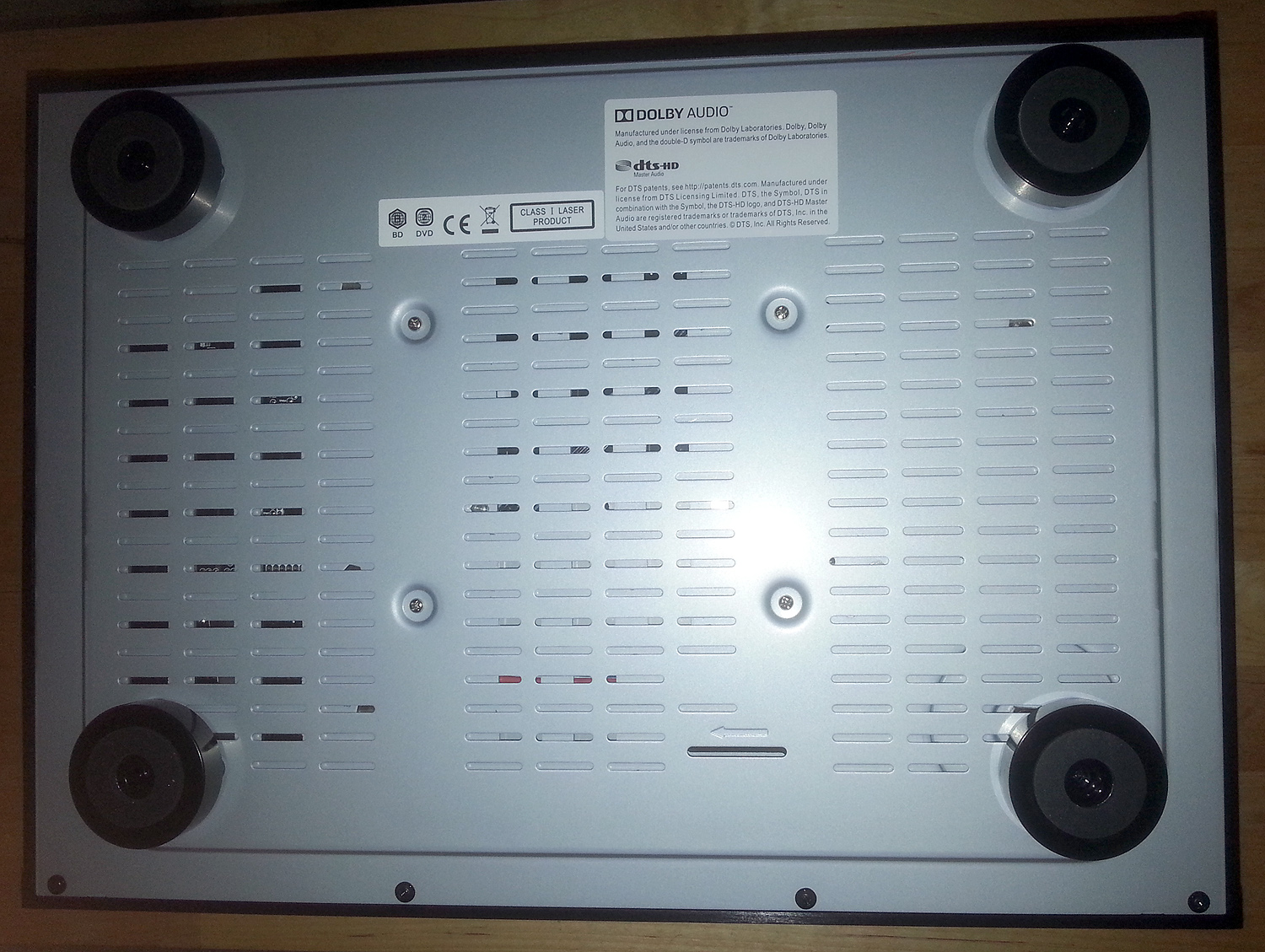

Have you ever wondered how it looks the bottom of the 205 player?
Remembering the expanded 3D picture of the device published by Oppo, I thought that this model it will have indeed a very good passive ventilation, with the whole cover perforated, and the chassis too (as shown in the 3D simulation).
Well, all this is not true at all. Look hereby how few perforations the whole perforated bottom of this model it have, where the air it can in fact get into the enclosure...
Else, the boards inside are perforated a lot, as the cover too. But how the air it can circulate inside and take the heat outside the enclosure, if so little fresh air it can get in? I really can not get it why the designers have perforated a lot one layer of the enclosure`s bottom, if the second layer it not fit
accordingly for the same ventilation holes...😕

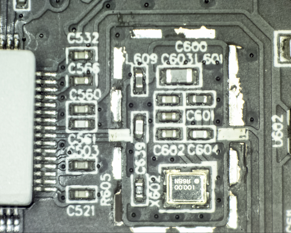

Well, finally the DAC clock is revealed
I have to say that is very difficult to remove that shield. The dissipation through the ground plane of the board is huge. I use 80w soldering iron, and it was not enough. Finally I have to cut the shield in pieces, and then unsoldering the parts...
This clock is for the multi channel DAC, but I presume the stereo one is the same design.
It was really necessary the shield over that already shielded oscillator? I don`t think so actually, for the quite simple clock circuit... However, the design approach it have a nice and more sophisticated aesthetically look from outside....
Fortunately, there is not necessary to take out the shield, but is is only enough cutting the signal trace, injecting so a new clock signal (and maybe cutting the power for the remaining oscillator...).
Dismounting a little bit the device, I could observe that there is a gap of 2 mm in between the two bottom layers of the chassis. So there is enough space for the air to circulate and get inside the enclosure, even thought the perforations of these layers does not coincide. Clever!
I have to modify my previous assertion about bad passive ventilation for this model. The inside bottom layer of the chassis it consist of a 1,5mm thickness steel plate. Very solid indeed!
The optical drive is mounted very close to the bottom. So it is much more easy to mount it on elastic suspensions... But the flat cable of the LPM it will have to be routed over the drive...

Examining closely the clock design for the DAC chip, we can see an extended filtering approach on the power line of the oscillator. Is seems Oppo was very preoccupied (for this model) by the HF noises impact over the player system and functionality of particular stages. Good!
It intrigue my a little bit the choice of Oppo designers when they placed a RC filter on the oscillator output (R605 and C639). It looks like they wanted to minimise/limit the levels of the harmonics coming out of the oscillator, beside the fundamental frequency. I do not know yet the values of these filter components. Also remain a open question about the type of this oscillator... Maybe someone know/recognise the marking on it... It may be this oscillator a SAW type one?

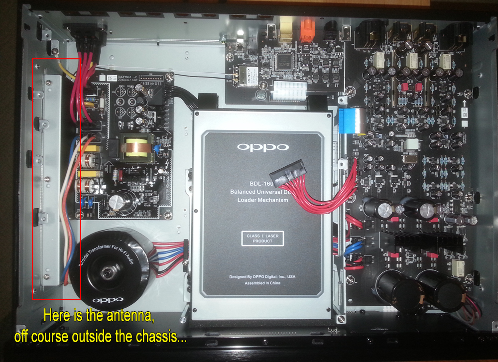

The preoccupation of Oppo designers to minimise the impact of the HF noises inside the enclosure itself, as the one coming from outside, is noticeable also in the chassis design. The two layers bottom with not matching ventilation holes it is one of the solutions to increase the shielding properties of the chassis bottom, while keeping a good ventilation capability for the enclosure.
I could see also that the SMPS section/board is in this model very well shielded, by a strong and large area covering steel case. If this SMPS board it need to be so well shielded for this model, what about the 203 model, where the same board is let it fully uncover inside the enclosure?
The toroid for DAC/analogue audio stage of the player it is shielded (in a cheaper way also, but good enough).
The optical drive it still have a full plastic body, covered by a metal (steel) sheet on its topp. Placing the drive right near the bottom, it also improve the shielding of this device for its down side too.
It may be this preoccupation of the designers for a good HF protection of the inside components and a improved shielding, due to the use of the WiFi emitter`s antennas on a side of the enclosure? We may not forget that we have here a quite strong UHF emission, very near to the enough sensitive parts. Well, the main frequency of this WiFi section is very high, but harmonics it can go enough low to disturb the sensitive stages. Also interference of these very high frequencies with some other EMI perturbations, it can have impact over the particular stages inside the system. This it can explain also the extra shielding for the 100Mhz clock stages for DACs. This it can explain the special care of the designers to shield very well the SMPS board inside the device.
Even thought the very improved shielding for the 205 model, against inside and outside HF disturbances, we still have a harsh sound on XLR output...
What about to just disconnect the WiFi antennas, and use only the cable network interface?
The wireless is very convenient to use, but a quite strong emitting device right on a side of the player, it may be so safe for the also very high frequencies of the digital signals, clocks frequencies, and so on, inside an enough complex digital/analogue system?
I think I will get rid of this WiFi stage (antennas)...
OK so we see a 100 MHz clock, And it is certainly nice to have the clock circuit in a shielded box .
Are the Wi-Fi antennas not outside the chassis?

Yes, the WiFi antenna is outside the chassis, but included into the chassis dimensions. In my opinion, after a first examination of the device, there was taken some extended precaution or measures for minimising the HF/EMI interferences into the player system. These measures are not taken just by chance, but based on some analyses. We do not know the details of what they found out, but I think the existence of a enough strong emitting device included into this system, it may have some important impact or influences.
The shielding box of the WiFi antenna is very carefully sealed inside with some conductive material. The shielding cover for antenna in 205 model is made of a thicker steel than the one in 203 model. There are some aspects here, I think...
