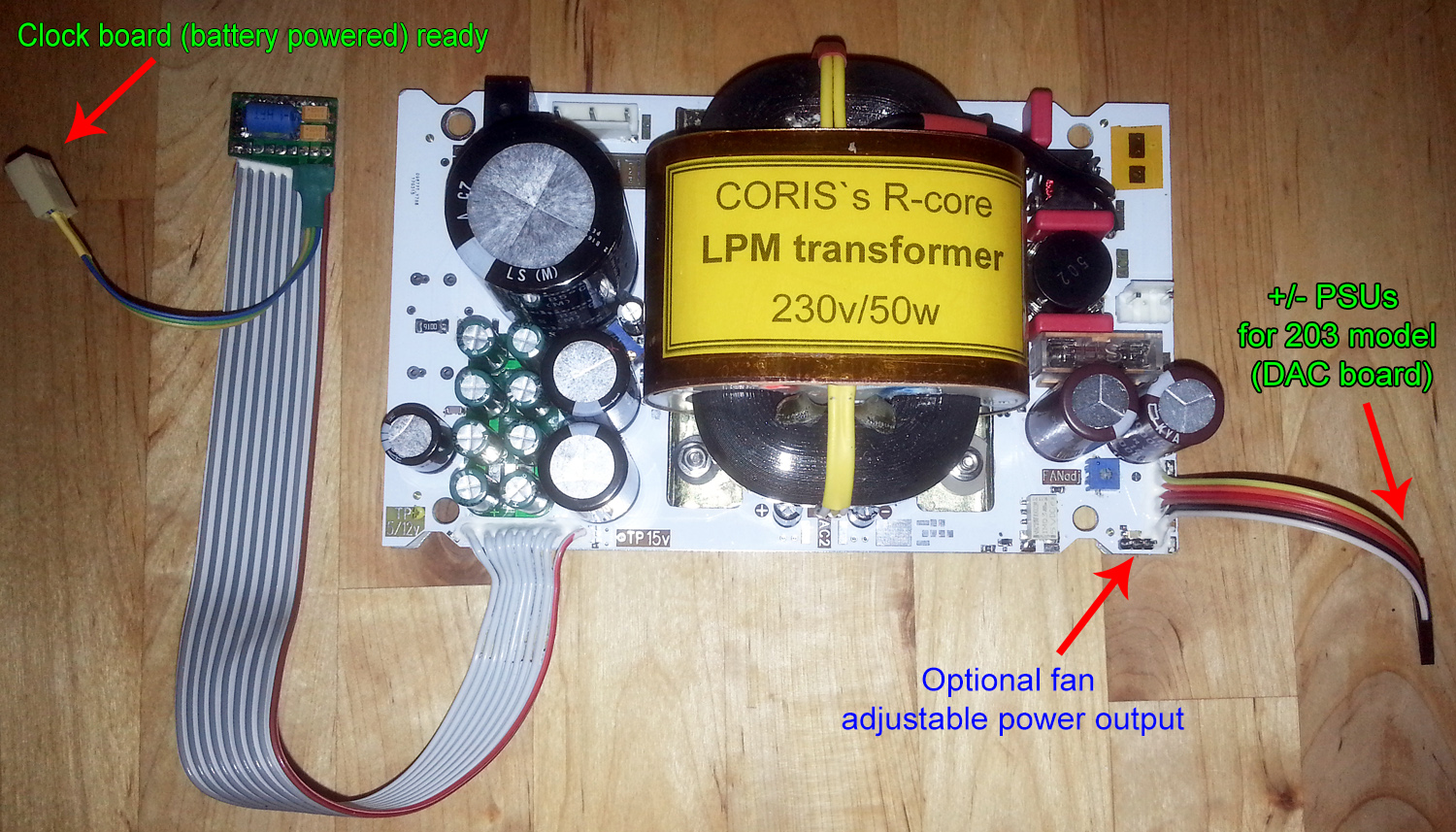

Here is my new model LPM compatible, equipped, and able to function on both 203 and 205 devices.

Easy upgrade for the 203 existing power supply.
Increase the value of the 2 of X caps in the AC line filter - must be X2 caps for safety. I fitted 1 uf between the chokes and 2.2 uf before it.
The electrolytics in the power supply aren't great quality - even though their marked 105 C
I used 10, 000 or 5,000 hour 105 C Panasonics for all of the following:
Main input cap increased from 68 to 150 Uf
Left the 47uf cap as 47 uf , but went to 63V
The 15 volt supply uses 4 of 470uf / 35v caps - i changed to 3300uf/25v , but theres only 14.5 volts on them, you might use the 4700 uf/16 volt caps
The 12 volt supply uses 3 of 1000uf/16v caps. Changed them to 4700uf /16 V
I used .1uf /63v Wima films under the board to bypass each of the 15 and 12 volt caps.
The inductors:
Theres two 3.3 mh/2A which I changed to 100 mh and fit in the same spot.
Theres a .1 mh/6A which i changed to 1 mh, but had to glue it on the board nearby and run new leads back to the holes. The new parts are taller so a little silicon goop for mechanical stability is advised.
Worked perfectly, I'm sure the full linear power supply replacement is better, but for $30 this is an inexpensive upgrade. And the caps will last longer.

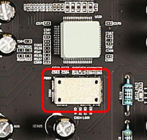

Looks like the advanced clocking is only for the audio HDMI out section according to OPPO.
Yes, indeed. It looks like the clock for the main processor should not be touched (by mods). Let`s see what about the rest, especially about the DACs clocking...

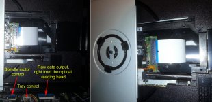

Recently I had to open the drive of mine 105 unit. Hereby is how it looks inside...
There is for sure similar to the one inside 203/205 models. No any electronic inside, except only the servo circuits for the reading head. All the controls are made by external circuit/processor.
The tray and spindle motors are controlled by a dedicated chip, while the outputted raw data stream is processed into the main processor (103/105/105D models), and by a dedicated processor chip for the 203/205 models. This optical drive processor into the last player models it is clocked by the 25Mhz signal. So, the quality of this clock signal it have big impact over the quality of the both sound and picture play backed from discs.
Indeed, the SAW clocking is only for the HDMI. If it wasn't for a truck accident, I would have a '205 before me now.
For me, the big question is, what is under that 'four dots' module. Is that a single surface mount module that can be removed with a heat gun, or is it a 'shield' with components sitting underneath?
