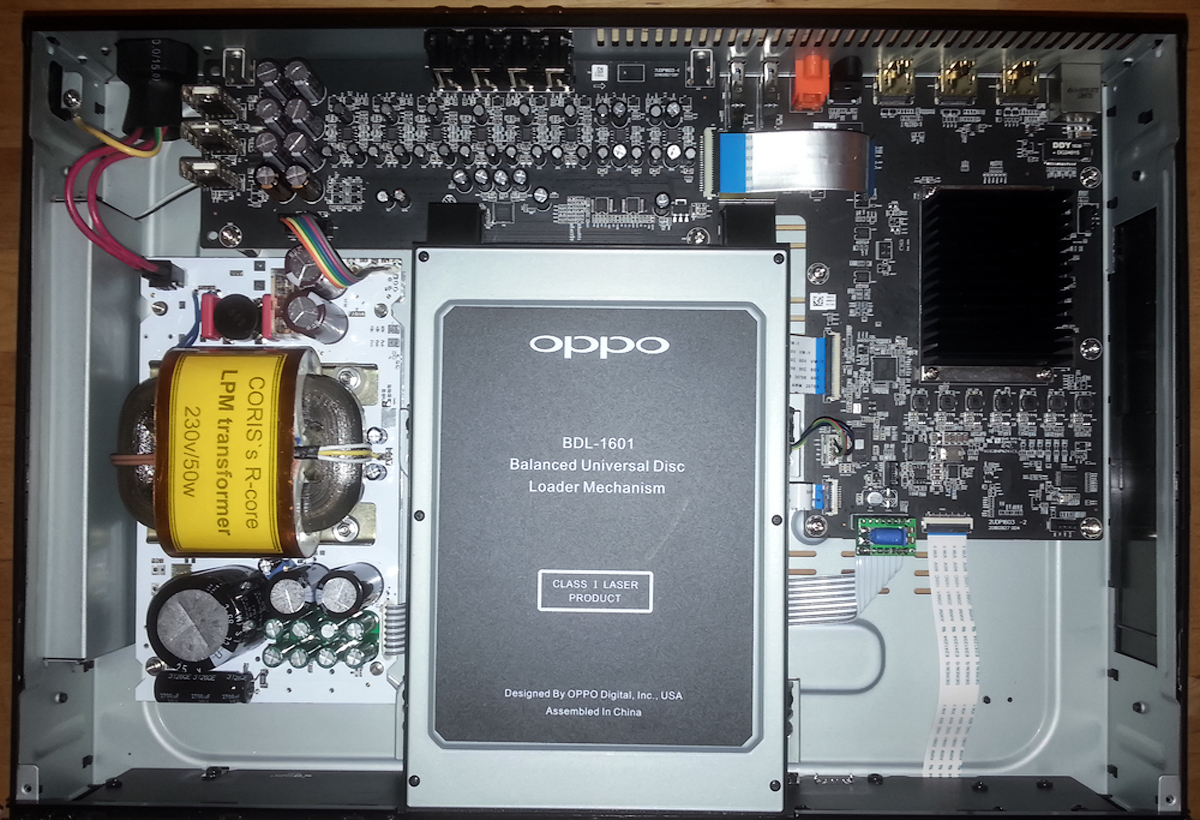

Joined 2009
The power relay signal is active in 203 model...
Quite happy to find out that the relay circuit on the main board of 203 model is active, even thought this is not used. It seems that Oppo chosen to produce the main board for both models 203 and 205 identical and fully populated. This is quite good!
It is about the relay which it have to power on/off the toroid for analogue stage in 205 model. This function does not exist for 203.. In 203 the relay and some other components necessary to realise this function are not populated on the SMPS board, but the signal which it should activate this relay it is active, and it output from the main board.
This is really very fortunate for further modifications/improvements.
Some users of 203 model may want to improve the clock system, by adding some dedicated and better clock approaches or clock boards. The power for these boards it can be now controlled by this relay signal output, already active on main board.
I already adapted my LPM to use this signal for 203 model improvements too.
This LPM is designed to fit into both 203 and 205 models. So the power relay circuit is already on board and it can be populated and used for 203 model too, to control a supplementary PSU for a clock board.
I use also this relay signal to control my battery powered clock board in a more convenient manner (no any modification necessary on the main board).
I decided to provide the LPM from now on, ready for the use of my clock board as an eventual future improvement, which is much more easy now to be installed by the user himself (only coaxes are needed to be soldered in place).
Now my clock board is implemented into a 203 model, and the results are already very impressive. Especially for picture quality. Quite dramatic improvement in reproducing the colours level into the picture, increasing of the tonal richness as the very fine details.
The USB interface quality is also improved as a consequence of this improved clock system, and the sound quality is also lifted up and very noticeable (the audio board it is not yet modified).
My clock board for 203 model it include an high quality 25Mhz oscillator for the UHD drive decoder chip (0,28ppm temperature stability and -130dB phase noise).

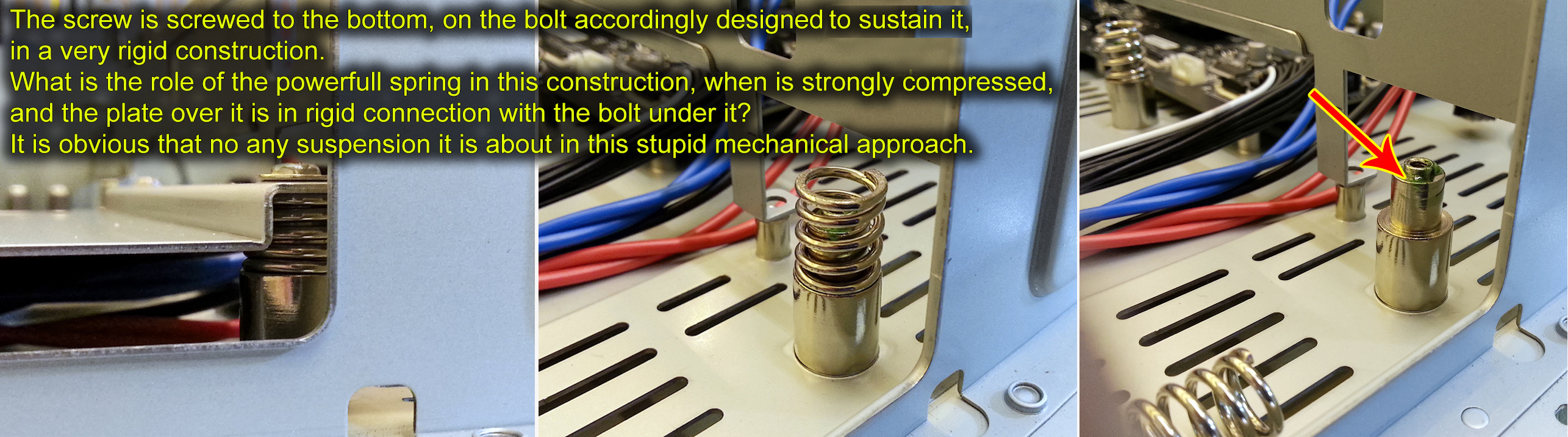

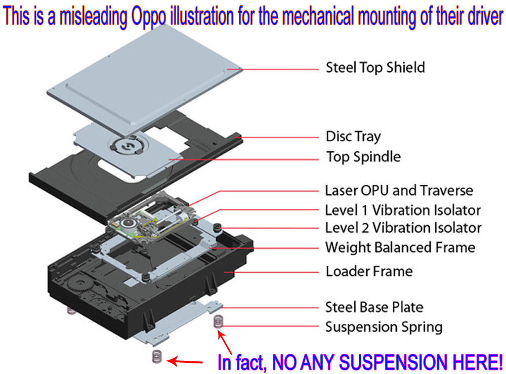

I would like to point once more on the misleading way Oppo it present the mechanical mounting of their driver in all the player models they produced/produce.
Oppo it show in their 3D design of the driver unit, the springs which it suggest about a elastic mounting of the driver into the chassis. In fact (see the pictures hereby) the mechanical mounting of the driver in Oppo all models it is done in a very rigid (and stupid) way, even thought it are used some springs.
I only wonder about the role of these quite powerful it springs used in this approach...
Hereby also my correction for this wrong mounting design...
Joined 2009
You know, there is no need of any adjustment here. If all the parts are screwed in completely (to bottom, and how is actually done), everything it fit perfectly as the mechanical design, and fabrication are enough precisely.
The all four screws are screwed to the bottom and the plate which support the driver is in a very rigid and good mechanical connection with all the four bolts, and chassis. The springs are well compressed, and it press in between the bolts and the screwed in plate over it. These springs it exercise a force which is not necessary at all here, so how it is actually executed the mounting approach. Even thought the screws shouldn`t be screwed in to bottom, the very powerful springs it will exercise a so strong force in between the bolts and the plate, realising a very good and rigid construction.
The only elastic suspension which it could be made using these springs, is to attach the plate on one end of the springs, while the another end of the spring it have to be attached to the chassis (no any mechanical connection in between the driver plate and the chassis, but only through the spring). In such case, the springs it will be in between the plate and the chassis, and the elastic suspension is realised. In such scenario, the springs should be of a much softer type. The force of the actual springs is very strong...
I have to point also here on another aspect. The plate and its mounting approach is designed, having in mind a real elastic suspension mounting. The plate and the bolts planted into the chassis, it realise a limiting, so that the driver should`"float" freely in place, but only in between some limits. For unknown reasons Oppo have chosen a such stupid rigid mechanical mounting, where the springs it have no any function, and most important, not realising any elastic suspension at all...
This mounting it is not changed, corrected or improved since 95 model (I haven`t seen yet myself the 83 model inside)... Always exactly the same mechanical approach and chassis design.
P.S. I just come now on the idea that the springs are planted there in place only as a decoration, to suggest (mislead) that it may be about a suspension approach, so how they show off in the 3D exploded design of the driver. In fact it is not about any suspension!

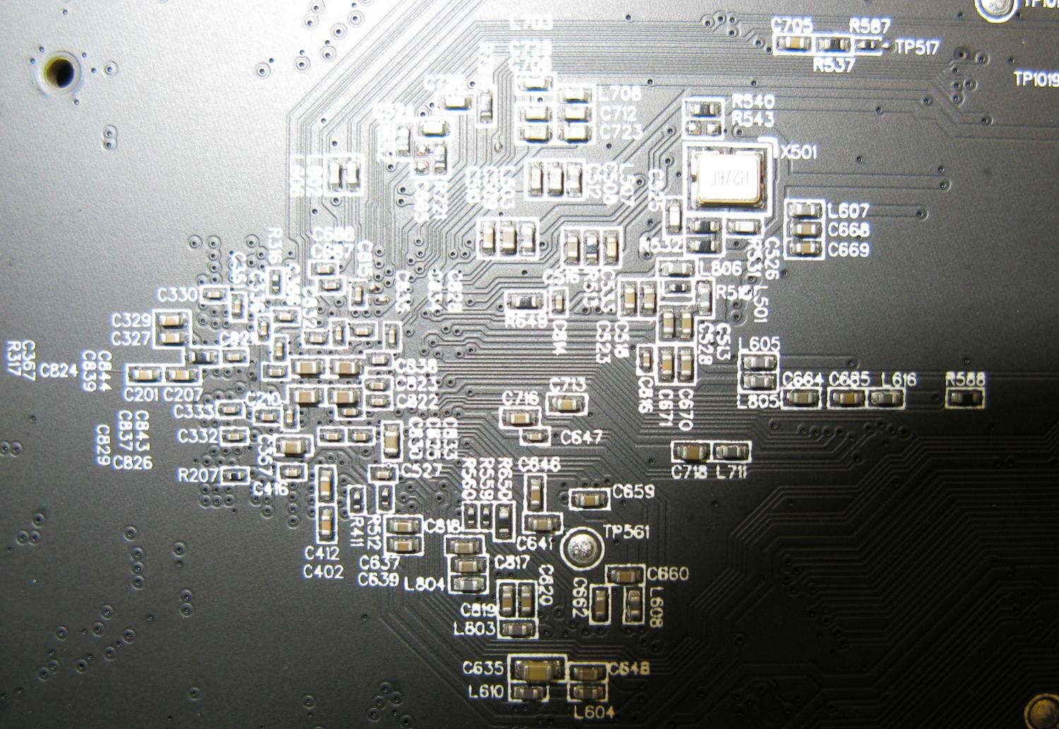

Looks like separate clocks for Stereo and Multi-channel. Rectangular with four black corner dots - that has to be the oscillators. If so, not a bad thing and gets rid of that Texas chip sending a balanced clock signal up to the M-CH via the ribbon.
Go to Oppo's website for full resolution hit "+" on the photo. If they were just slightly more detailed, we could see legends with part numbers, like R530 and C40 etc. It's almost there, but falls just short.
Joined 2009
Hi Joe
Thanks for infos updates and photos. Pretty much the same, but some differences as well...
The clocking device one can see near DACs, is actually a shielded circuit. I suspect inside that shield it may be a PLL circuit, or an oscillator with its own regulator beside. Well, we will find out quite soon (after removing that piece of perforated shielding box).

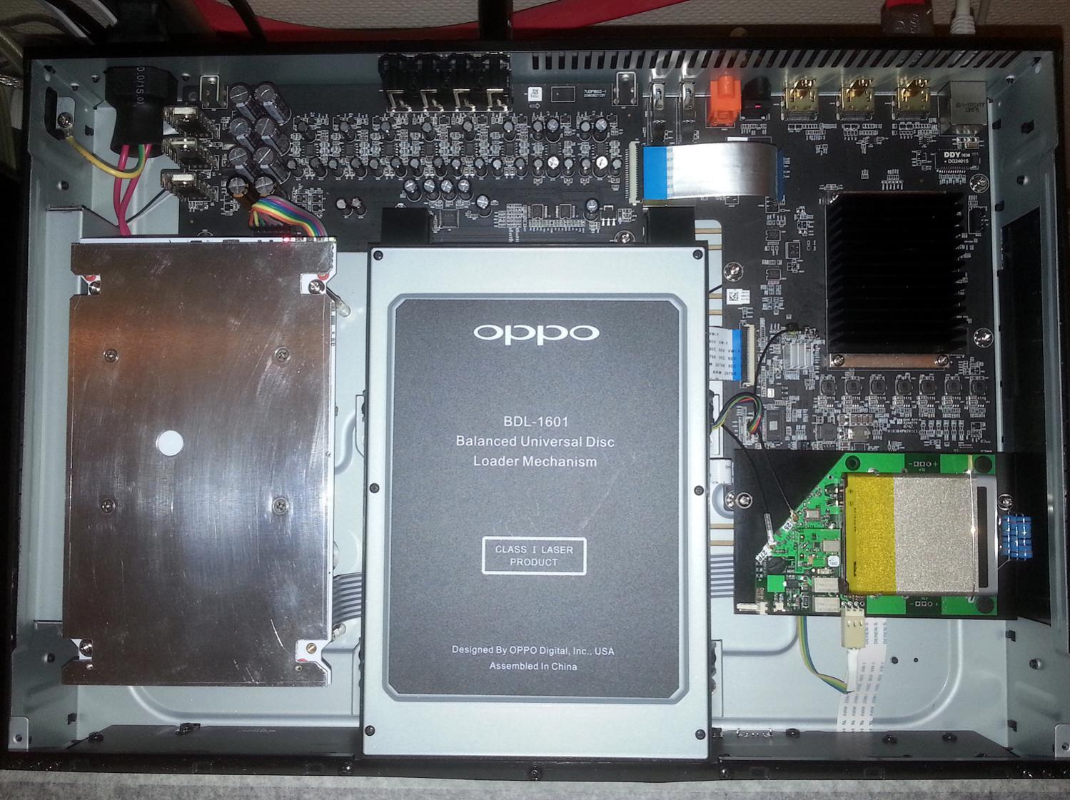

Do you know if the analouge-out/dac-card in BDP-103 and BDP-203 would be interchangeable? Same physical format, same power-feeeding, and same digital-interface?
It looks very much the same, physically.
Is the 32 bits only internal processing in the AKM-dac, or has it another interface than dac in BDP-103 (32 vs 24 bit input)?
I ask because I would like to use my digital-out Audiopraise Vanity103HD-card in a BDP-203, if possible. It is designed to replace the analouge-out card of the BDP-103.
