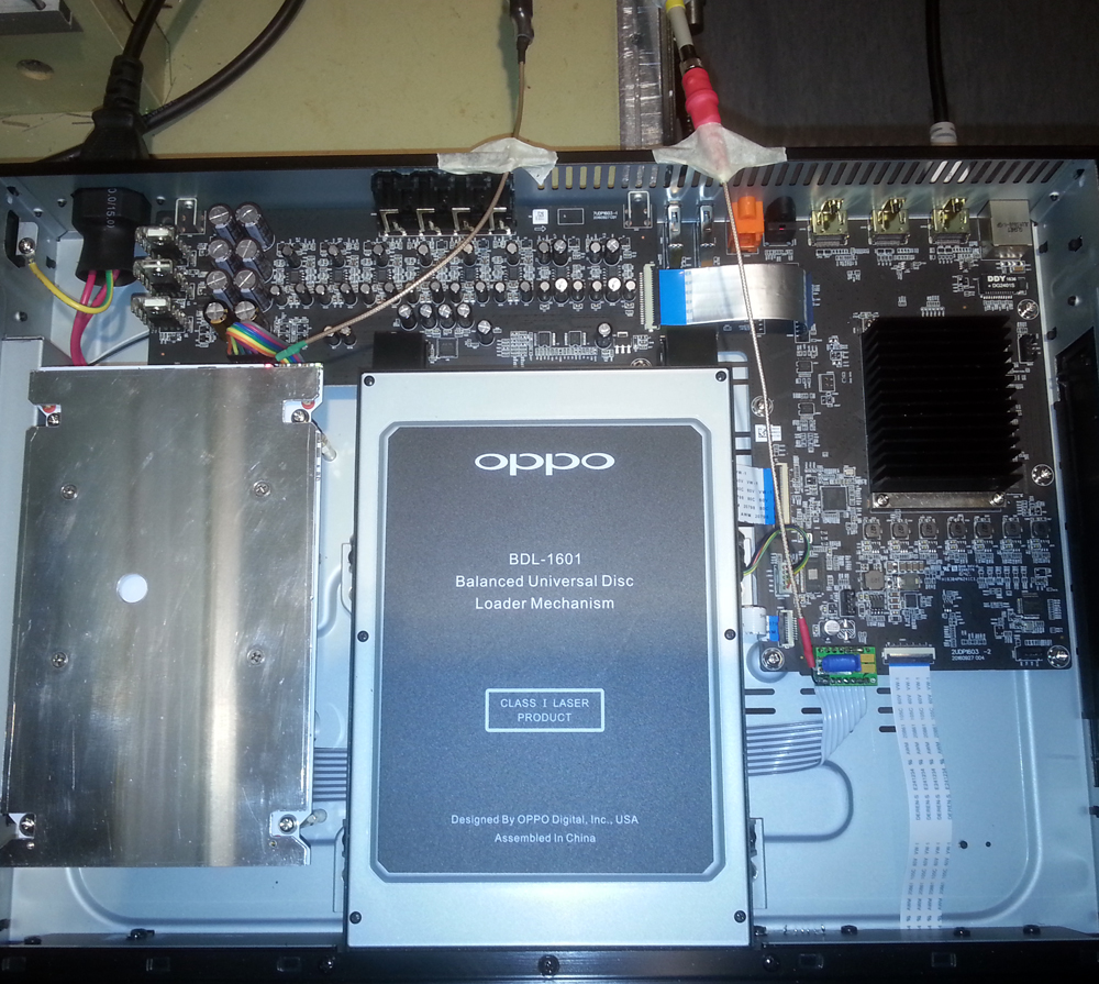

Finally I got in my hands an 203 model. The goal is to install my LPM into it and do some other modifications/improvements...
First, my impressions, are (as also of the rest of the users of this Opo last player model) quite good. The picture (I tested it on a HD monitor) is just excellent (far better than on old models), as the sound also very good in respect to the AKM DAC used in this device. The new generation main processor it have an obvious impact for quality increasing (also expected...)
I would like to point here on something when about the sound quality for this device as for the older ones. The last firmware Oppo issued for the old models as for the new ones, it seems to include an improvement for sound stage. There is improvement in dynamics as for overall quality of the outputted audio signal. They did something about the digital processing in this respect. After installing the new firmware version on an old model as on this 203 one, I noticed quite dramatic improvement for sound on both player generations.

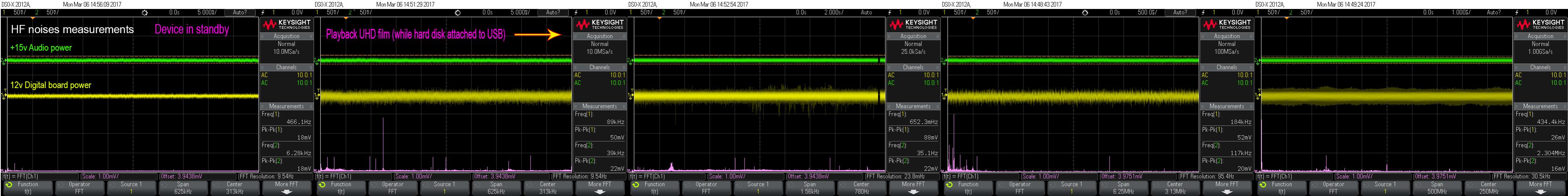

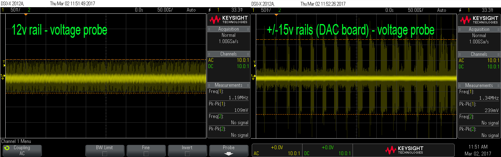

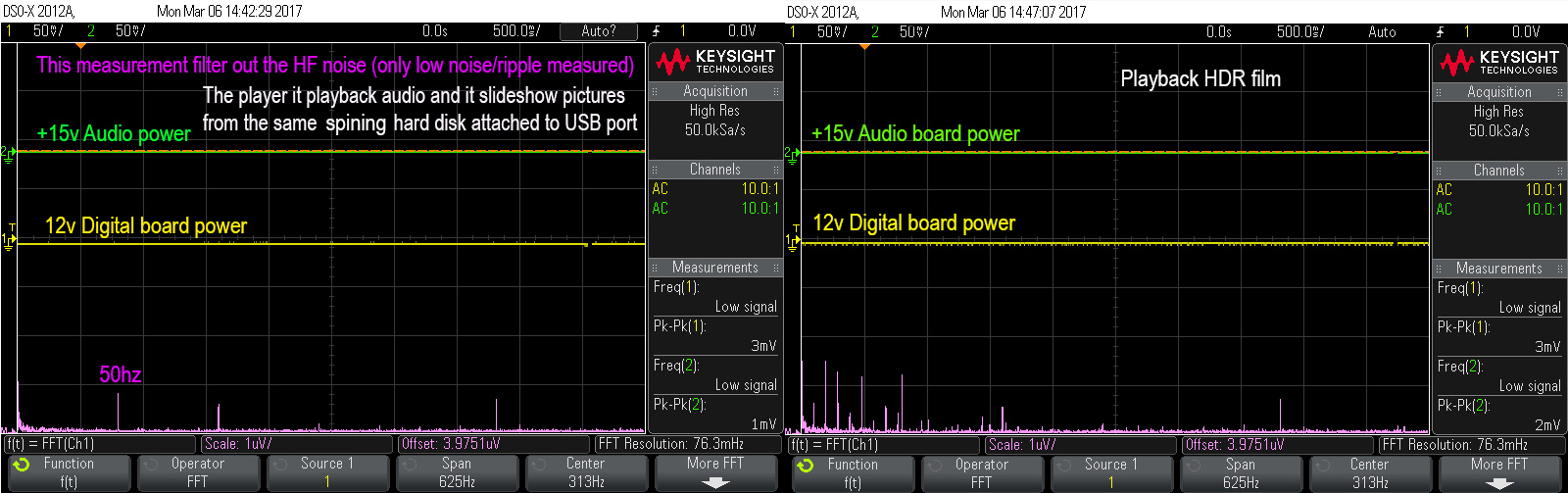

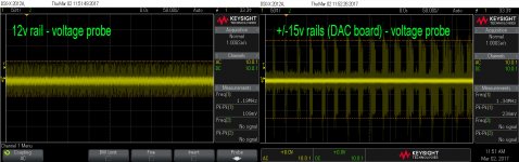

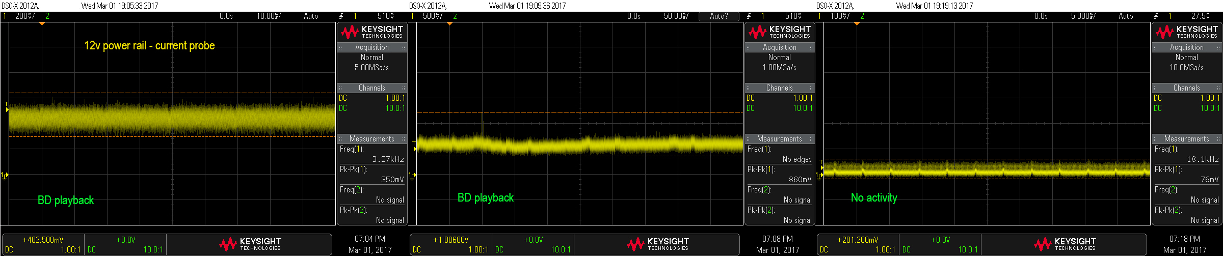

I had also so the opportunity now to measure the power rails of the 203 device, so as it is with Oppo`s SMPS in place. The results you can see it hereby.
Some other comments about this 203 model:
The heatsink for main processor it is soldered now on board and is grounded. It seems to me that Oppo designers may read this thread here... Well, nothing wrong with that...🙂.
The new generation processor it do the whole job now, as no any dedicated video processors are used beside the main processor.

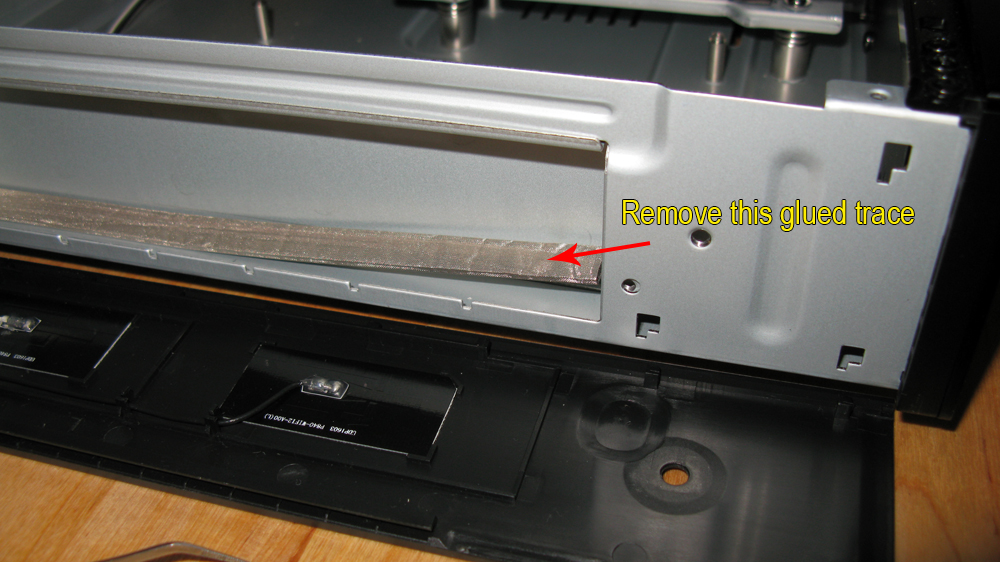

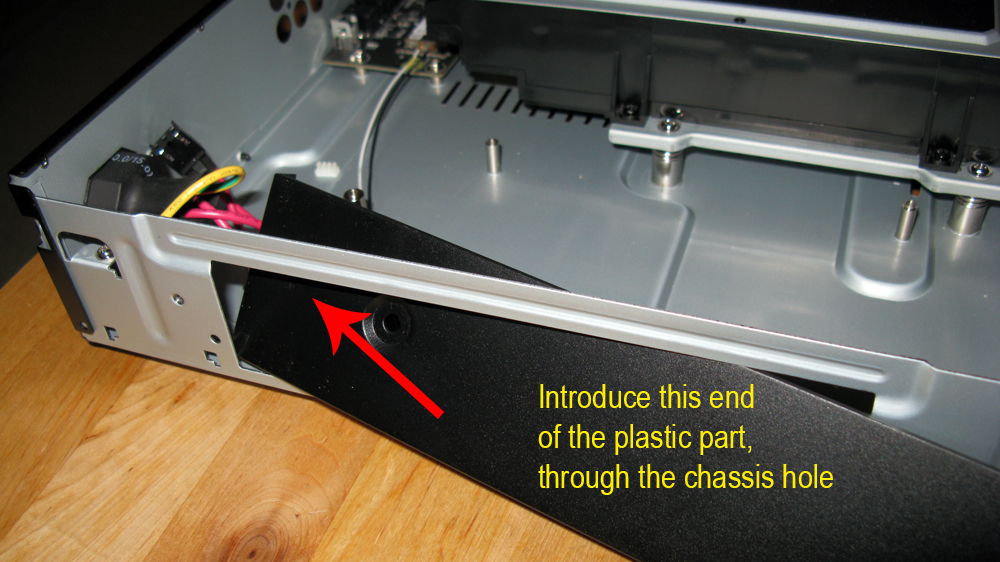

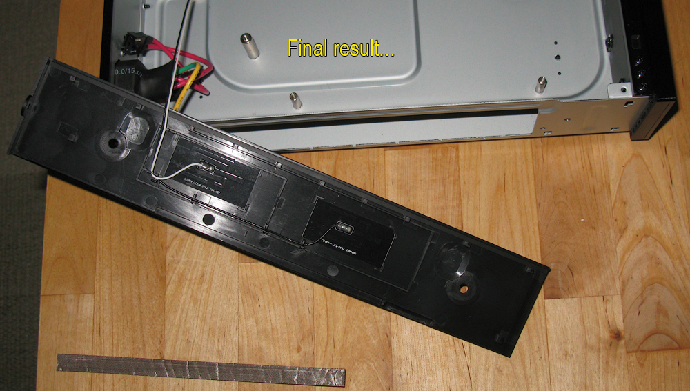

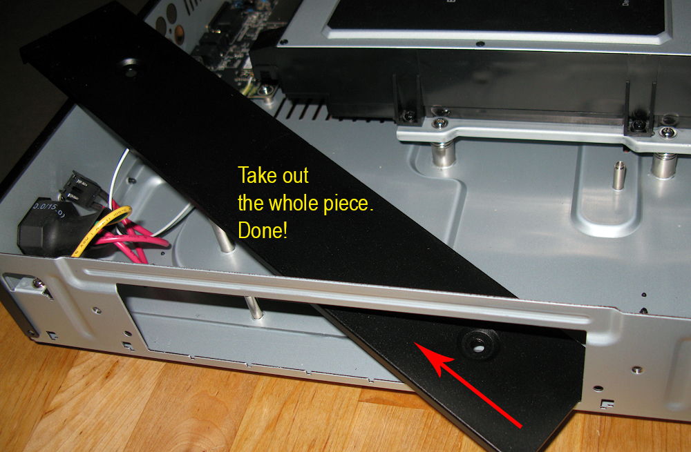

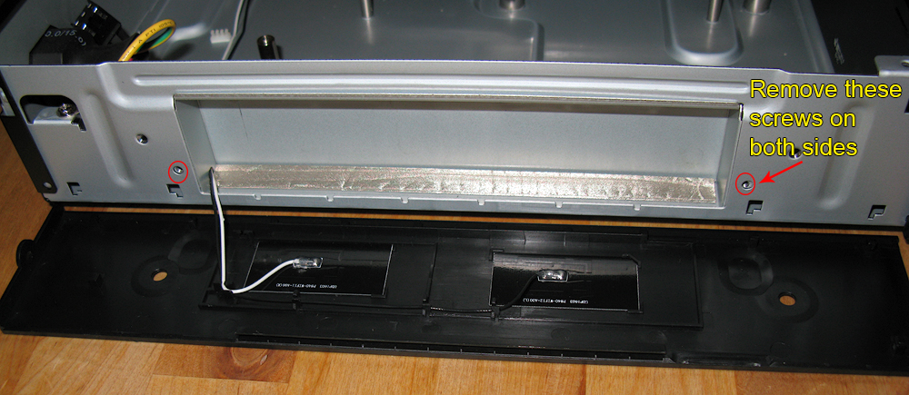

There is a little bit more difficult to take out the main board from this model, as the board is connected to the WiFi antennas on the side of the chassis. Well this antennes it can be disconnected, but they cover it the connectors with some silicone to make difficult the disconnection, and at least there is not recommended such connecting/disconnecting operations on these connectors, as their performances get worse. So, one should keep in place the wifi antennes connectors and remove the whole plastic part with the antennes on it, if the main board should be removed from its place.
I suggest hereby a procedure for a such removal operation. Please take a look at the pictures.
Now I will start to assembly my new LPM version for these new Oppo players models, and I may come back soon with more details about the improvement process as about the the results...

However, the audio section of 203 it perform quite well (so flooded by the SMPS HF noises), especially after the very last firmware upgrade. I did not tried yet the volume control on AKM DAC. I`m not an adept of digital volume either... I prefer to have it on fixed level... I may take a look anyway...
I also expect a dramatic overall improvement after installing the linear PSU on this device, when one look at the enough high HF noise levels spread out by the SMPS... Especially for audio section the power noises are very important (240mV).
Also a 100mV HF noise induced into the whole digital stage (including clocks) is not a good thing either...

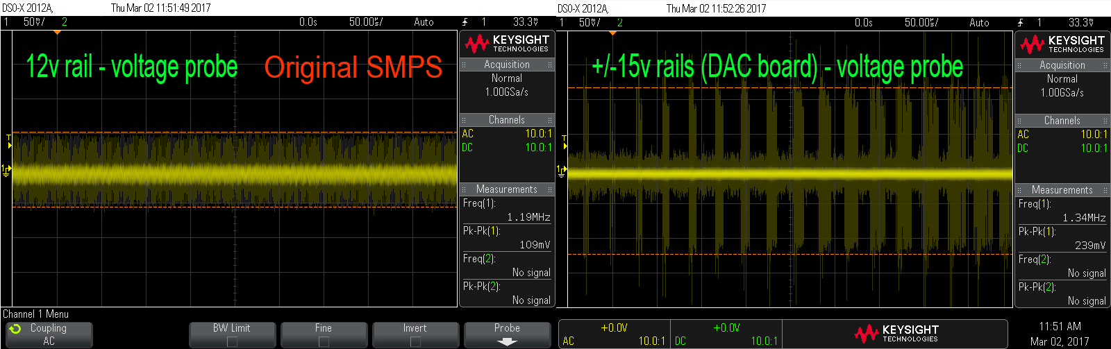

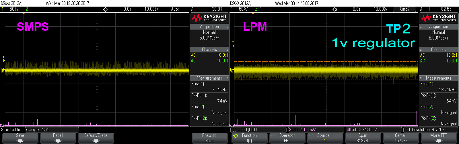

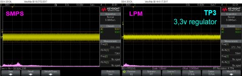

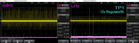

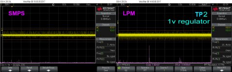

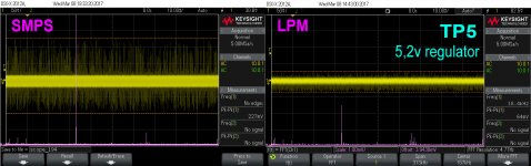

I would like to show here comparative measurements taken on a 203 model, powered by its original SMPS, and by a linear PSU )my LPM).
The measurement setup is also shown in the picture hereby.

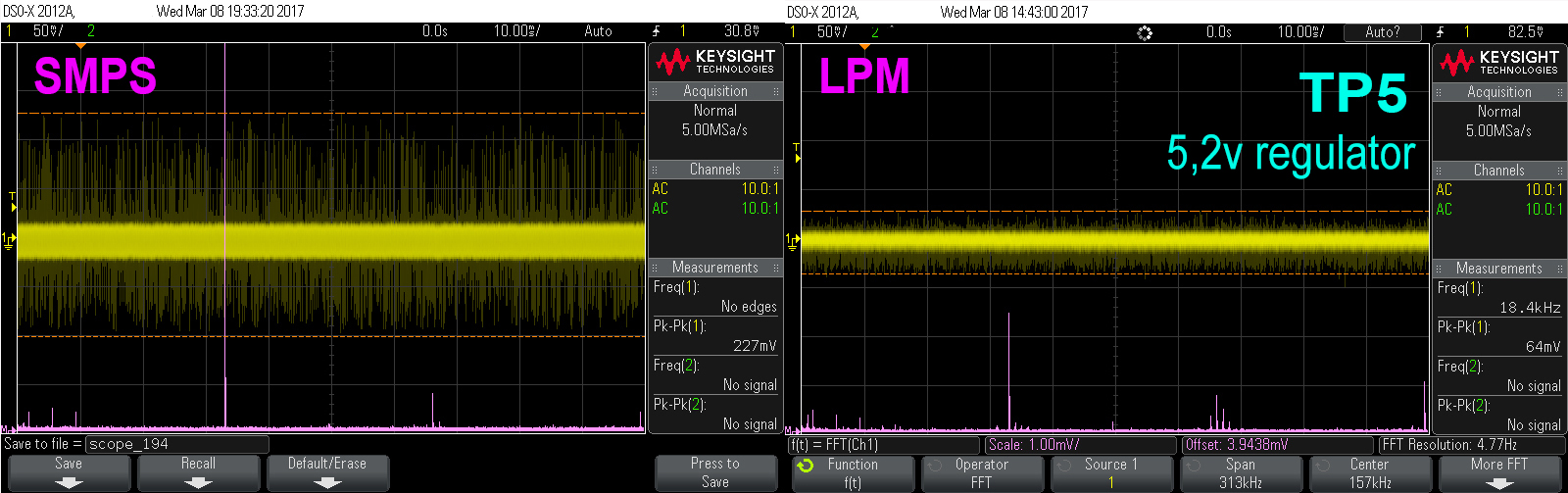

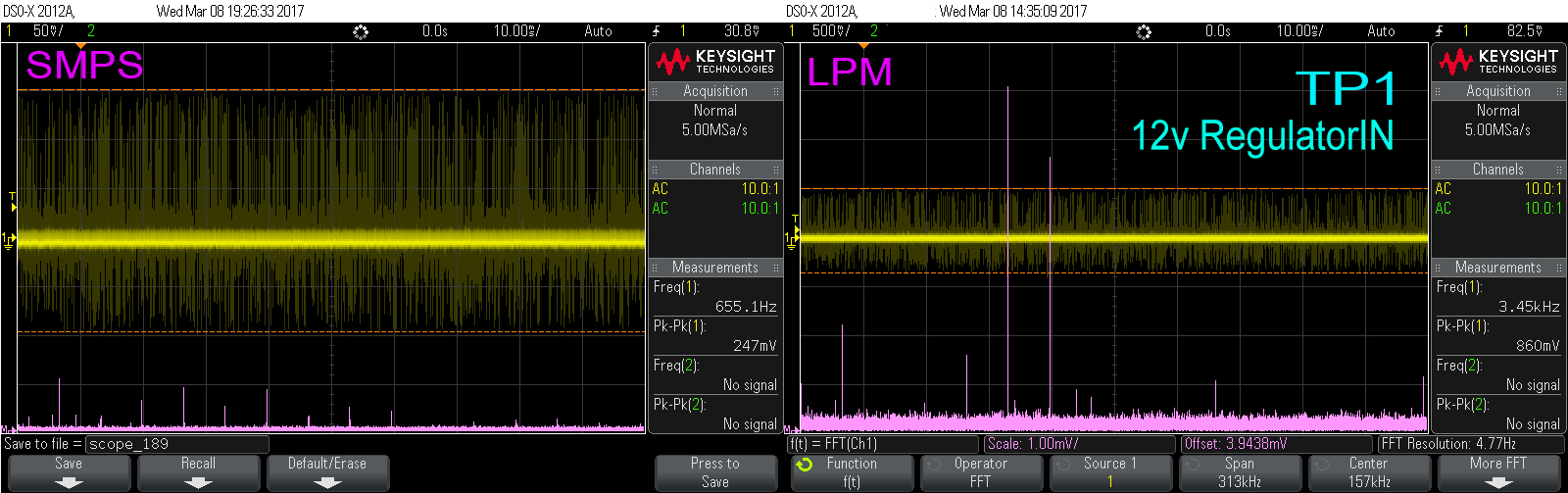

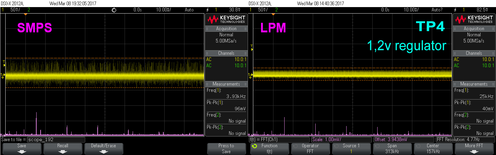

Well, now is done. There are here the comparative results of some measurements on the DC/DC converters on main board of a 203 device, powered by the original SMPS and by my LPM.
The results are obvious...
BTW, a quite demanding work I may only say...
