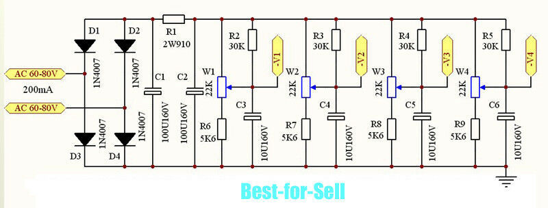

I use this circuit myself...2W multiturn pots...
This is a biasing cct for Class AB fixed bias PP UL 6L6GCs in two monoblocks I built circa 1960. And one of the amps, both still running but not today.
The cct may give you some ideas to work on.🙂
Very nice- and quite similar to the balance pot style that Pete Millet implemented on his PCB.

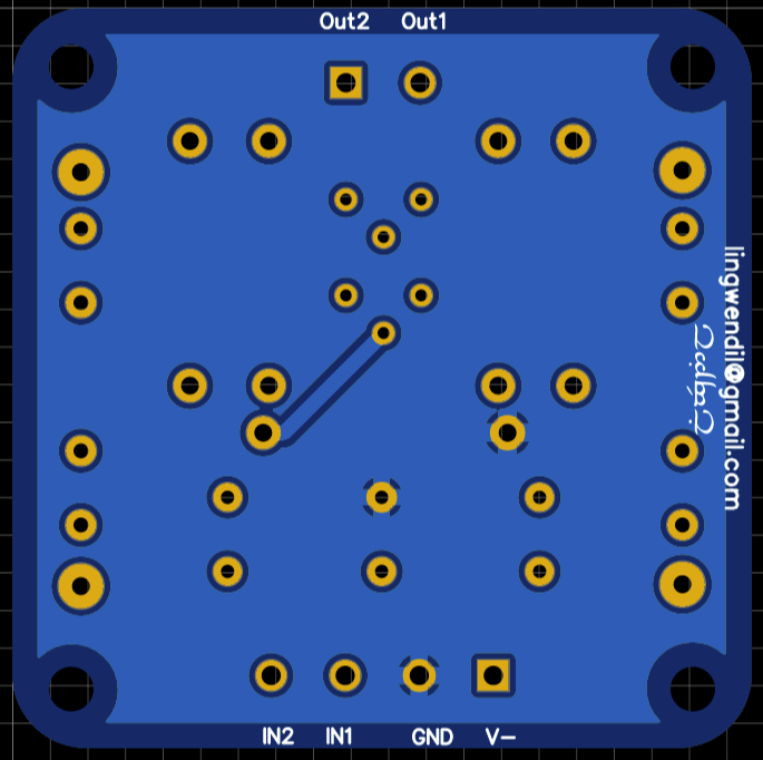

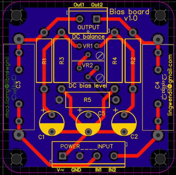

Pretty simple, but this sounds like a job for a custom PCB. I had downtime at work (for once!) so I decided to start implementing one on a 50mm square, and it will also incorporate the input capacitors on board. Should be handy and cheap to have a few made. Going to chew on it a few days, add some extra holes to accommodate multiple capacitor sizes/lead spacing (as it is it's really best for axial lead types) and hopefully have something useful together to make a not-so-fun thing to do on veroboard a bit more pleasant. Currently its set to use Bourn 10-turn trim pots, but I will add a few more holes to accommodate alternate parts as well. the electrolytics have 5mm lead spacing. Swooky round corners this time, and a ground plane since there is so little current here.
I was planning on using 10R cathode resistors to enable easy measurement of idle current, and if I can find a set of cheap panel meters I may throw them in at some point. Looks like this will be just the ticket.

Search SO45 on ebay... Cheap and cheerful. Keep in mind if you pump lots of current through it (like in my designs so) you'll want to make it 5W even though it seems like 1W would be good enough... 1A through 10R is 10W on those peaks 🙂
Went bigger on the resistor footprints to accomadate the larger types some folks like to use, and cleaned it all up a bit. Still need to work on how I'm going to do the silkscreen labels for the inputs and outputs, and think of a clever name for the board. Bias Buddy? Hmmm.

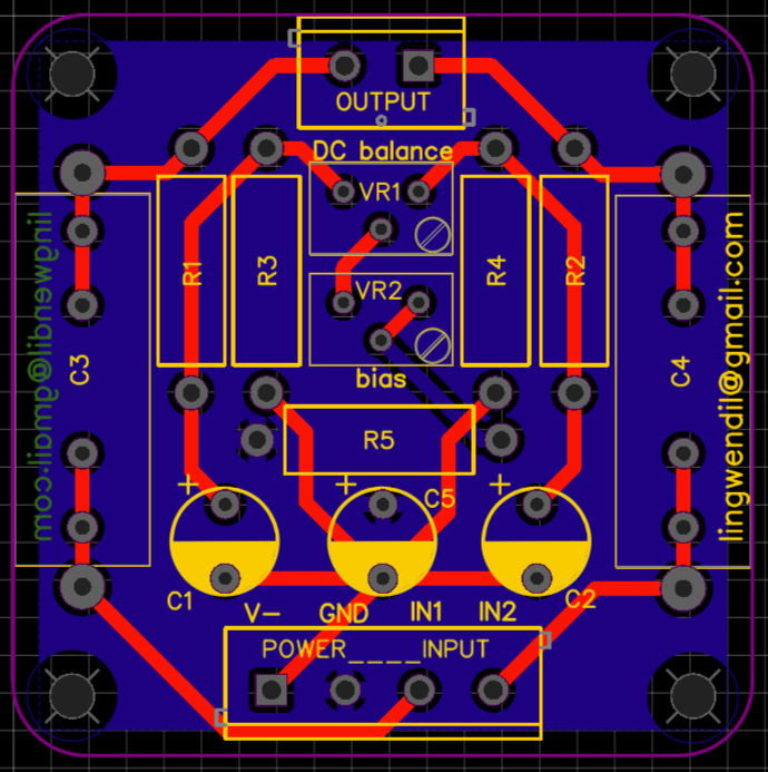

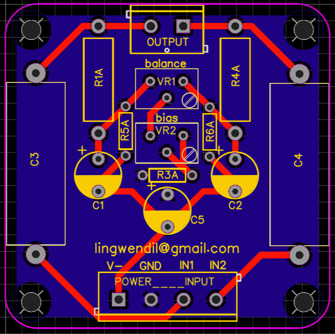

I figure for 25k pots the worst case dissipation will be a 40% of the supply voltage, so assuming something like 100 volt supply you're at .064W dissipation, which should be fine with a quality cermet trimpot. Worst case a larger pot could be wired offboard?
I've attached the semi-final state of the board. Looks pretty self explanatory, but I'll draw up a specific schematic soon, but it's basically the one jhstewart posted, with added capacitors across each end of the balance trimmer to the negative rail, resistors tied to the negative rail rather than ground as in the Millet version, and without the meter circuitry (which, incidentally, is the same as the Millet circuit just with the added resistor inline with the pot, which is a good feature to limit adjustment and pot dissipation.) so that it is easy for most builds. Mostly the Millet version.
Once I get this to a point I'm happy with I'll do a 50x100mm dual version as well.

But you're not using the entire 25k. Maybe you'll only use 5k of it as a rheostat. 170V supply (which is what I get from using an isolation transformer and a bridge) would still be almost 70V across 5k = 1W. Your circuit might be different than mine, too. 😛
that inline resistor with the pot will soak up a lot of the dissipation though, so worse case it should still be in spec. I don't plan on using it for really negative rails over 100 volts or so, the excess will be soaked up in the power supply filtering if needed. If you know of any pots suitable for PCB mounting that are readily available to work at higher dissipation I'm all ears in making them fit the PCB too 🙂

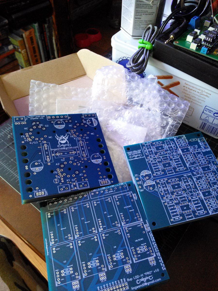

I use the free online EasyEDA editor, and my orders so far have been with JLCPCB. Shipping has been fast, and quality has been excellent. I've used them for a dozen designs (not all of them audio) now. Pretty affordable if you keep your PCBs to 100mm square. five PCBs for $2 special going on currently (yes, $2!) so I want to order some of these pretty soon. DHL express (shipping to your door in several business days) is $16USD if you order 5 or 10 of these boards, pretty affordable.

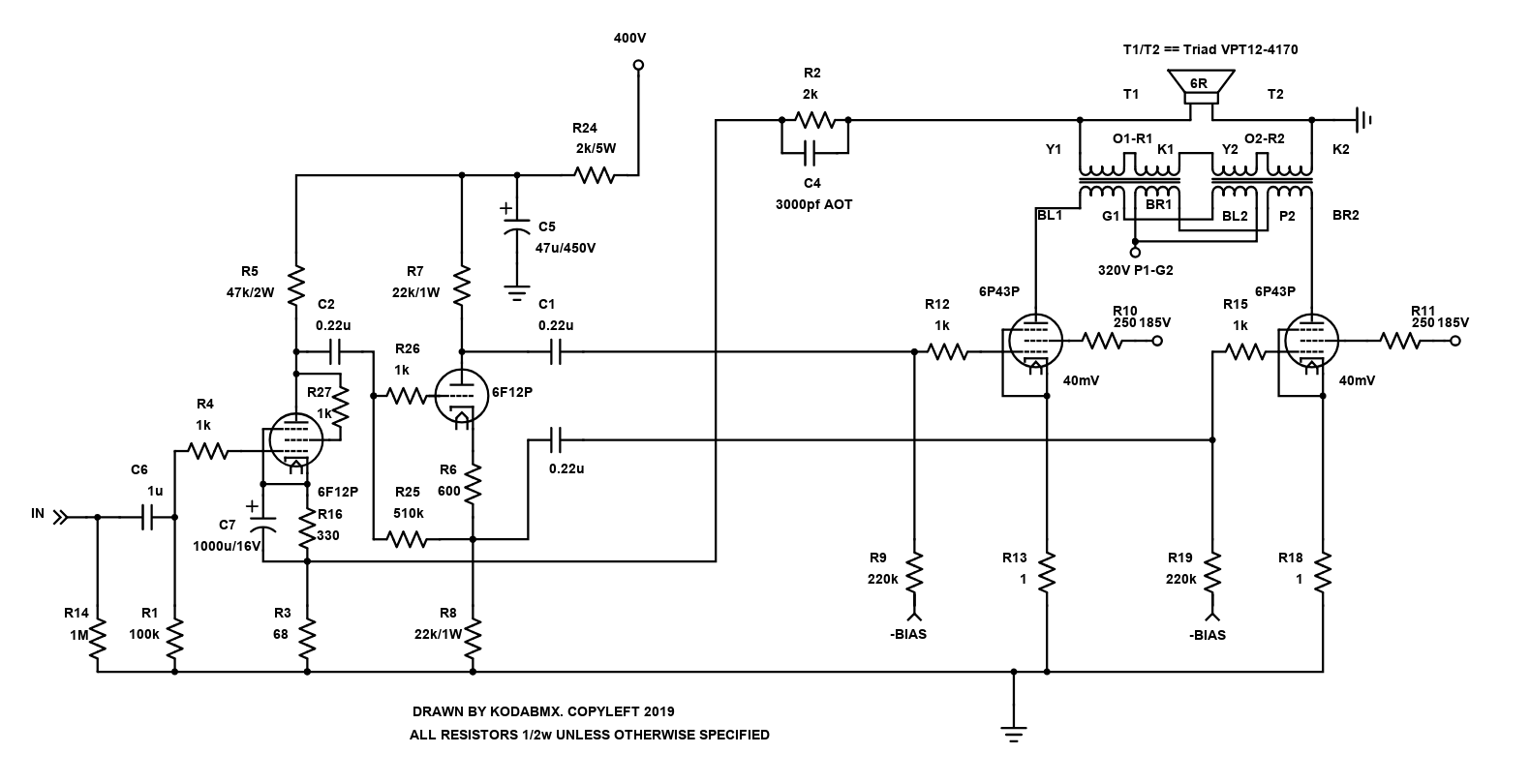

I just finished my 6P34P pentode build.
6F12P VA/PI as per my usual, no driver since it's pentode.
6F12P B+ 400V
6P43P B+ 330V
6P43P Screens 185V (0D3 shunt regulator on top of a 36V zener from a 220V B+)
So far it's not bad, but not much power more than triode mode, and worse output (square waves at 10kHz don't exist, more like a morph of a sin and a square together). Still, it's quiet, and the SMPS starts into the bloody load! Yay me!

Yeah pentode mode of the 6P43P didn't look all that great to me, maybe the curves kinking up near lower voltage are making things wonky? I wonder how they would do in UL or with "schade" plate-to-driver-plate feedback? Would need a differential driver for that to work though. Might be a good experiment, but the 6F12P wouldn't work for that.
Worst case just pop in a set of EL86/6CW5, like my daily driver build uses?

6F12P would work if you move the PI to the driver? Like 6F12P gain into 6F12P gain into 6SN7 LTP or something? Or the 6SN7, one grid driven, the other grounded with a CCS for the cathode and no bypass?
As far as 6CW5, I only have one. I have like 50 6P43P i think. I also realize the audible difference between 10W and 20W is not much, and I have a bloody cold complete with a stuffed sinus cavity.
With the bigger sweep tubes, I can run them with no load so I can switch from one amp to the other to compare, but these ones with the smaller OPTs and the 6P43Ps like to oscillate with no load. You can see it in the 0D3 on the fixed bias pentode amp, and as one red plate on the triode version with electronic auto grid bias. I really think it's a problem with the switch though. Only the right channel has issues.
Actually, I effed up when I built it as follows.
R7 and R8 were supposed to be 47k but I used 22k. When the voltages were wrong, I changed R6 from 1k2 to 600. Maybe the PI can't work into that load? OTOH when i use 47k, I was also using 560V instead of 400V 🙂

The Triad transformers won't do much at 10 KHz, made for line frequencies. They look like competition to the Hammond 182 Series.
But probably OK for listening to background music. Or maybe public address. For your own curiosity did you measure the OP stage total plate current when run at HF, high level? That extra goes to heat the transformer core & coils.🙂
The screens would be running pretty hot too, the loadline would be a large, open ellipse.😱

That's a beautiful construction. Luv the mysterious stacked OPT's. Pentode outputs need output Zobels more than most; maybe some right across the output terminals? 0u1 F and 10R or 15R? Can't hurt; might fix the oscillation too.
