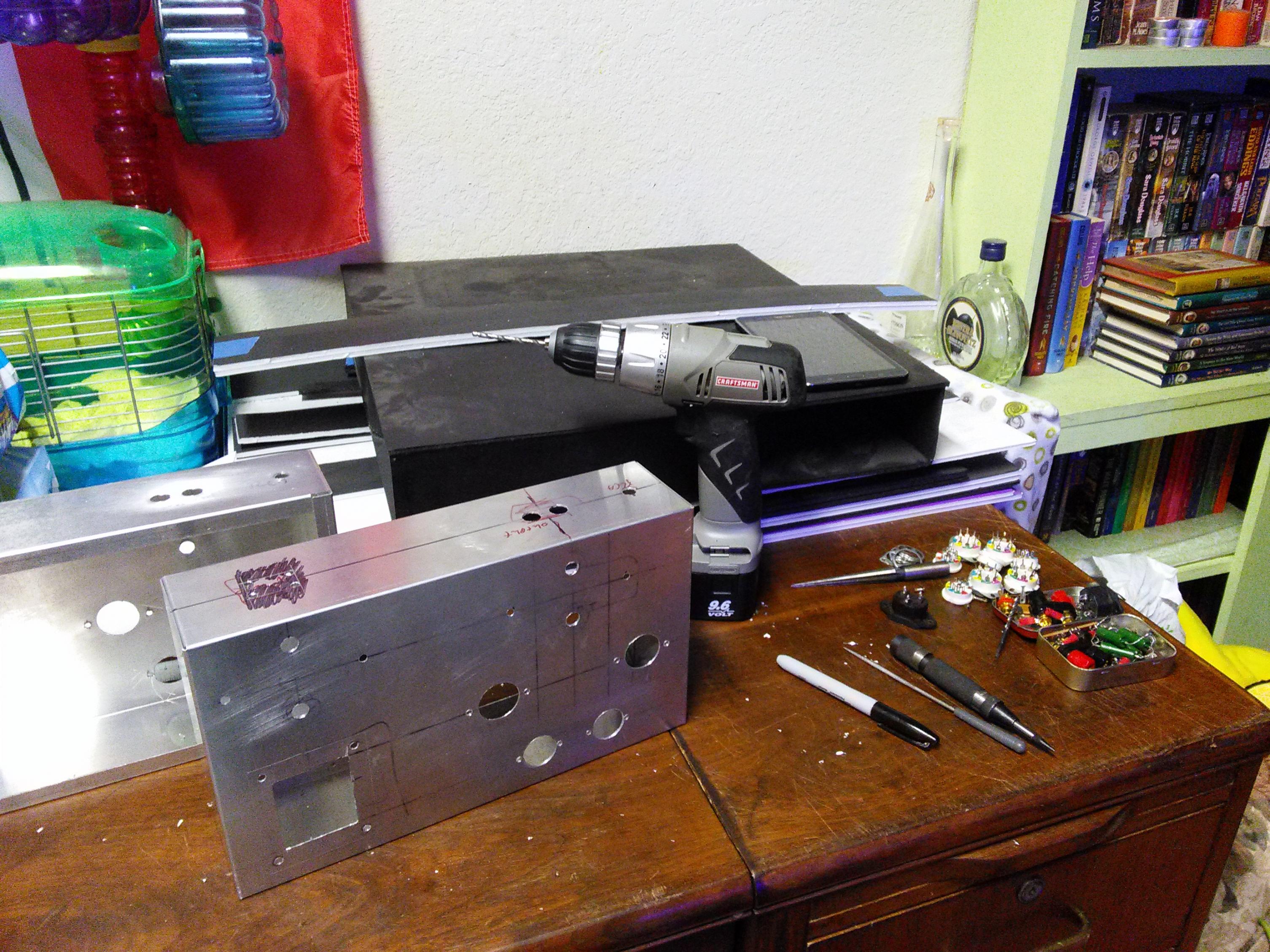

Slowly but surely getting along. Drilled all final screw holes and fit them to size. Went with stainless hardware simply because I could pilfer as much as I needed from work with the lab guys blessing 🙂 I've been doing little bits here and there but haven't made it to the garage to cut out the IEC jack holes, but at least laid them out and drilled out the corners of the openings. I'm working in the living room with a cordless drill and a set of files while my son plays and watches TV. Later tonight or tomorrow morning I'll cut and fit the IEC holes, then start final mockup before I paint everything.
I believe it's 1mm? It's a bud industries aluminum. If I had heavier transformers I think it would be a bit on the light side, but with how everything is fairly close to the edges and corners it seems fine for this project. Worse case I could reinforce it with scrap aluminum angle but I don't think it will be necessary. They were $11 each reduced on Amazon, and I've used a handful in the past with great results, easy to work with and well made.

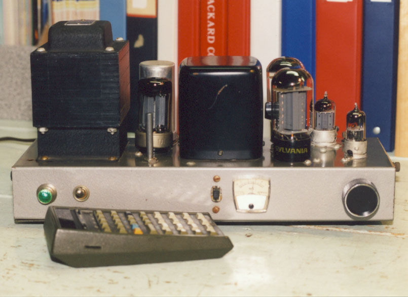

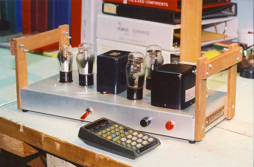

All my stuff for the past 25 yrs has been experimental, so I put a lot more effort into how the underside looks. That also makes it easier to get the measurement data I want. And make the changes when I'd like to get more comparative results.
I usually use some wooden strips available at the hdwr stores to build something the chassis can be inverted on. That is the way the amp spends most of its life, on the test bench. I do some listening tests but not a lot. My hearing is shot. The extensive measurement data tell me when things are good or otherwise. But that is the objective.
This experimental amp, what is possible with 2 volt filament tubes? So PP 33s in triode or UL, can be driven into Class AB2. 33 triode connected as a driver thru a Hammond IT. And a 1B5/25S front end.
I still listen to the Stones, Pink Floyd & lots of rock. I've a rock station on now as I do this. But Bach or some acoustic guitar is great as well.🙂
Should I dare saying 'anything but C&W'?😀

^ that's a cool project, and the wood rails on either end are a good idea. I have some scrap wood I plan to make a pair of frames to support these while working on them upside down. One of my goals this time is to make it look nicer than usual, and I think that won't be terribly difficult given the topology I'm going with and the use of a tag strip or two. I'll be making up a PCB for each to support the bias circuitry, the rest will be point to point.

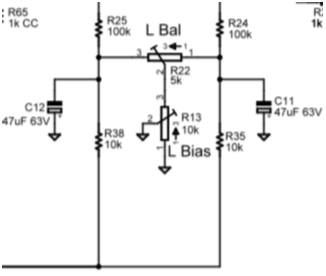

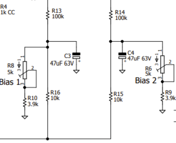

While I have some time at work to think on things, I'm trying to look at bias circuits. It's been quite a while since I built anything with fixed bias, so I'm making sure to do it as simple but effective as possible. For those of you who do this often, do you find a separate bias pot per grid is best, or a single bias pot with a balance pot is easier? I see that on Pete Millet's Engineer Aamplifier he does it with a balance pot for the regular version, and separate pots per tube for the monoblocks. I figured his work is a fine place as any to borrow from here.
Master adjust with balance from stereo PCB-
attachment.php
Individual adjustment from monoblock PCB-
attachment.php
Any input? I almost think the balance pot version would be a bit better, as minor adjustments would be easier after setting the level for both tubes, rather than cranking two pots down independantly, but realistically once the initial level is set at build time it doesn't seem to matter much, and parts count is almost the same.
