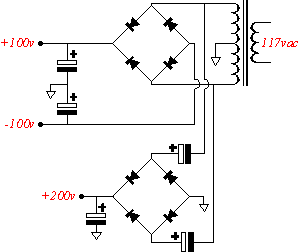

So I did more testing last night, and the 208 winding gives 175VAC under load (well, with the 0,277 volt taps rectified and loaded) and curiously, I'm getting only 280VDC rectified with a 47uF cap, and a 2k resistor array load (140mA draw) from the AC voltage of 240. This sounds way too low!? The transformer runs barely even warm, in fact it doesn't feel more than maybe a couple degrees above ambient at this draw. I tried both with a diode bridge made from 1N4007 and a bridge rectifier (RS405L) and get the same voltages. This seems a little weird to me, as I would expect a bit closer to 320~330VDC starting from 240VAC. Any ideas why it's so low? This is a little weird in my opinion. I could just use a voltage doubler or something to get higher voltage.
Alternative idea- I could do a voltage doubler arrangement- I would ground the 240V tap, put a bridge across the 0,480 taps, and then capacitor-couple a bridge to this, stacking that bridges' voltage on top of the positive output. This would give me a negative rail for bias, and two positive rails (I would only use the higher one, at least for a triode arrangement, but it gives future options for pentode screen supplies, source followers, etc) so should work nicely. Like this-
attachment.php
I have plenty of suitable capacitors for this, and I could easily account for sag with the mosfet filters I'll be using since they work best with a bit of extra headroom to shave off crud anyway. I just want to at least understand the loss of AC during rectification before I get into any exotic/less usual rectification schemes.

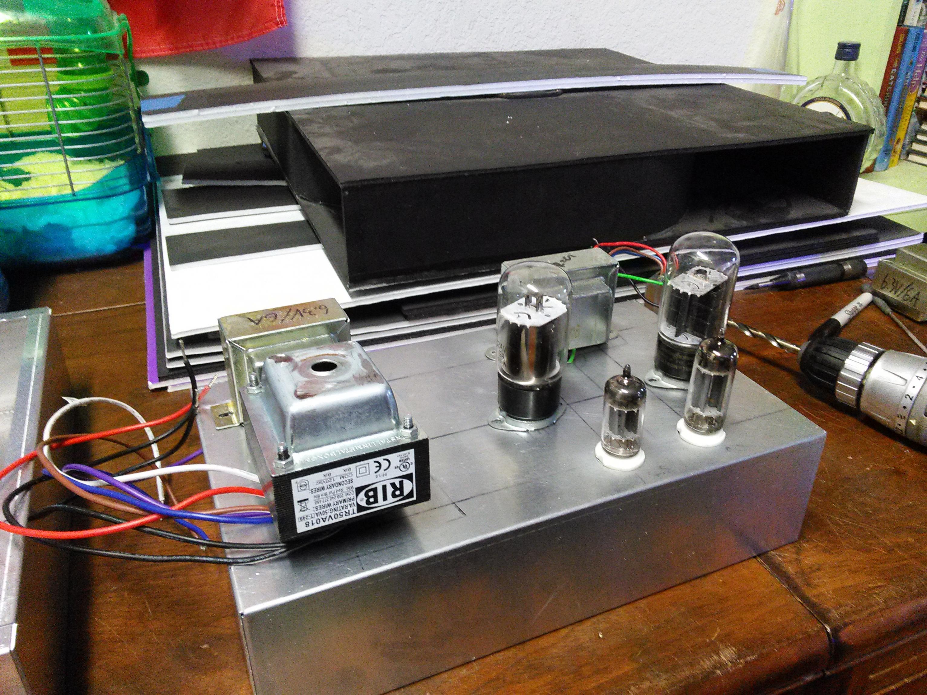

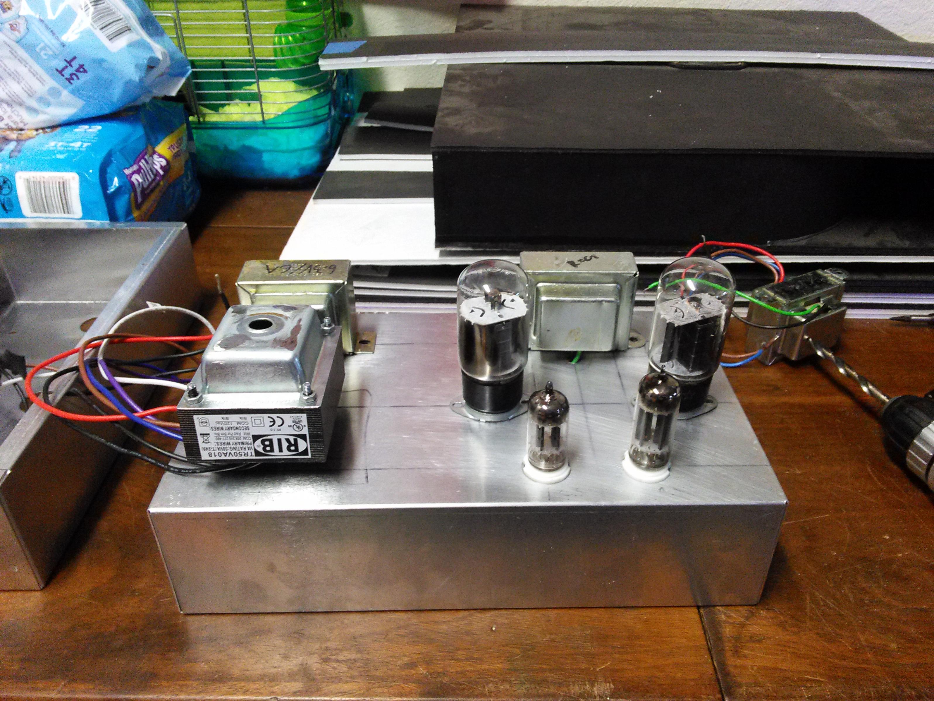

Well, trimmed the excess metal from the power transformers, and started drilling the enclosures, as that's the number one thing that keeps me from finishing projects. Having these ready will make less work for me anyways. Got all the holes drilled except for the power transformers and the IEC jacks. I'll need to grab some grommets for where the wires pass through the top, and I'm thinking stainless screws all around, maybe brass 🙂
