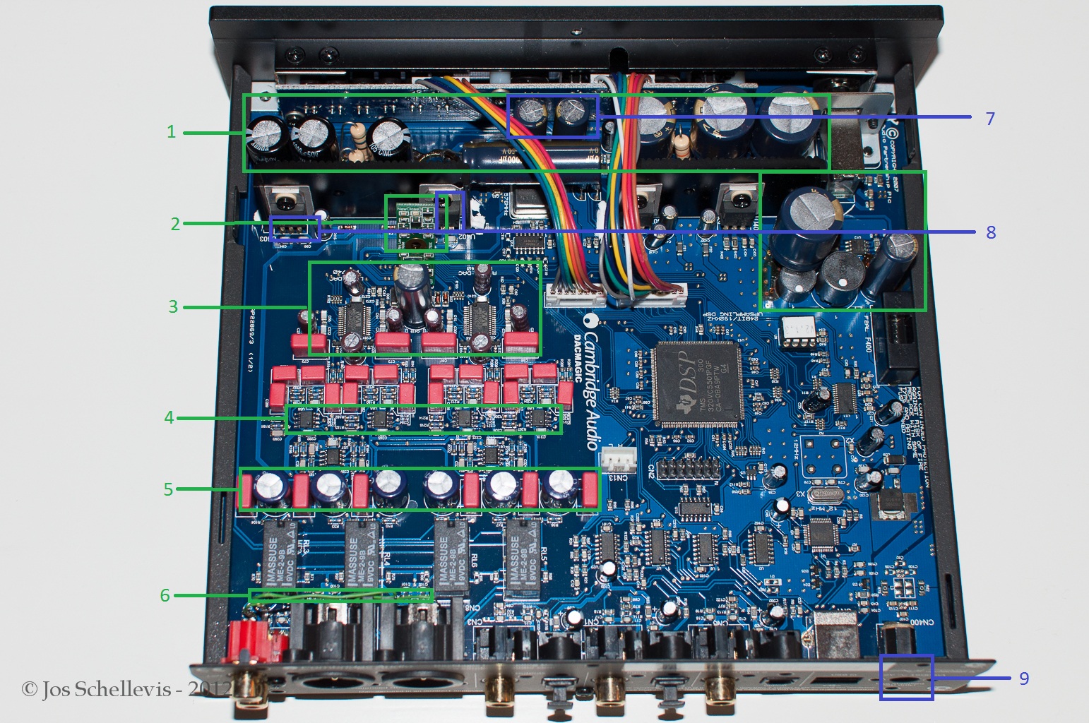

Here is the upgrade I performed on the DACMagic after gathering all info on this forum
1) Replaced all capacitors for Panasonic FC Capacitors
2) Replaced the 7805 for NewClassD UWB power regulator
3) Replaced all NP capacitors for Panasonic NP capacitors (higher voltage)
4) Replaced the unbalanced opamps (4x) for LME 49720
5) Bypassed the output caps (shortened), after measuring the ouput = <3mV
6) Disconnect the RCA outpput and reconnect to balanced +output to bypass the last OPA opamp
7) Higher the capacity of the "Villard" capacitors from 470/220 to 680/470 to allow higher current flow
8) Add additional 220uF capacitors to 15 volt outputs
9) Replaced the power adapter for a 9VAC 36VA to overcome the heat problem (7X15 regulators)
Incredible improvement of sound! Compared to original unit, my sister owns one.

I think what you're hearing is the induction coil, somewhere in power supply, oscillating at high frequencies. It is usually caused by lose ferrite core inside the coil. Determine which one is ringing (do it with a long piece of rubber tube inserted in the ear). You may have to disassemble the coil and put some glue and/or shrink tubing on it.
I had a ringing coil in my DacMagic, i dealt with it by filling it with epoxy - dead silent now.
Is it possible for someone to explain to me where the coils are? I have searched high and low, but sadly I am too much of a beginner.
Love this thread, after receiving my second hand dacmagic, I quickly realised I had a coil whine...
cheers.
You may not be able to open them, the best you could hope for would be to remove them and fill them with epoxy glue from the bottom.
The outer part on those looks like ferrite which is very brittle.
Thanks for the info, I will try all this during coming weekend. Another questions pops to mind. When the coil is removed from the PCB, filled with hot glue/epoxy. how do I attach the coil back again to the PCB. I have read that hot glue would be possible or is soldering a prefered method?
