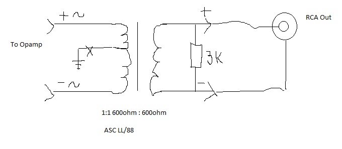

Today I tried running ASC LL/88 transformers on Dacmagic output. LL/88 is BBC transformer 1:1 600ohm primary and secondary, with primary centertapped. I believe they were used to convert unbalanced signals to balanced and vice versa, and believed to be made by Sowter.
Primary was connected to to balanced signal running from U55-U56 and U59-U60 and output was fed to right side of the rca coupling cap (removed). The primary centertap is left unused, although I think it could be grounded...
The sound is GORGEOUS.
I think I am going to remove all coupling caps and disable XLR outputs - a pair of RCA will suffice for now. I had previously removed summing opamps that feed RCA outputs and ran one-sided XLR - hardly an optimum setup. The most important thing - those trafos fit within the box and could be mounted on the pcb.

Could you share a schematic on how the xformers are connected in ?
Mihailov went extreme and bypassed all the opamps, coupling DAC Vout to outputs directly via transformers. I connected my transformers after the first cascade of opamps.

I really like tube output stages, and in this case something like Broskie CF would probably work well. Smallish Dacmagic box makes me explore other options and my current transformer mod seems to be OK.

Is the sound improvement because the xformer does the summing up of the XLR+ and XLR- signals ? When you say sound improvement in what way ?
