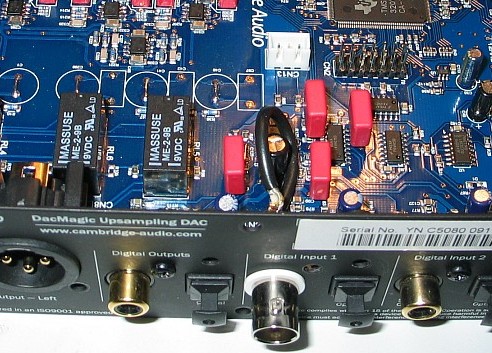

Hi aptsys, any suggestions on fixing the feedback loop would be greatly appreciated. AD797 sounds so good that I am decided to go all the way.
On another topic I reworked the clock supply and now have a) Crystek XO relocated to DAC PCB, b) removed the FBs for both XO & Schmitt inverter and powered both from the flea 3.3Vdc, c) replaced XO & Schmitt inverter ceramic bypass caps with film Panasonic ECHU 0.1nf/50V (0805).
With this change the whole clock chain is in clean supply except of the DSP. The AD797 on the flea PSU gets warm but nothing to worry.
This feels to have added further improvement to the sound stage, definition and bass.

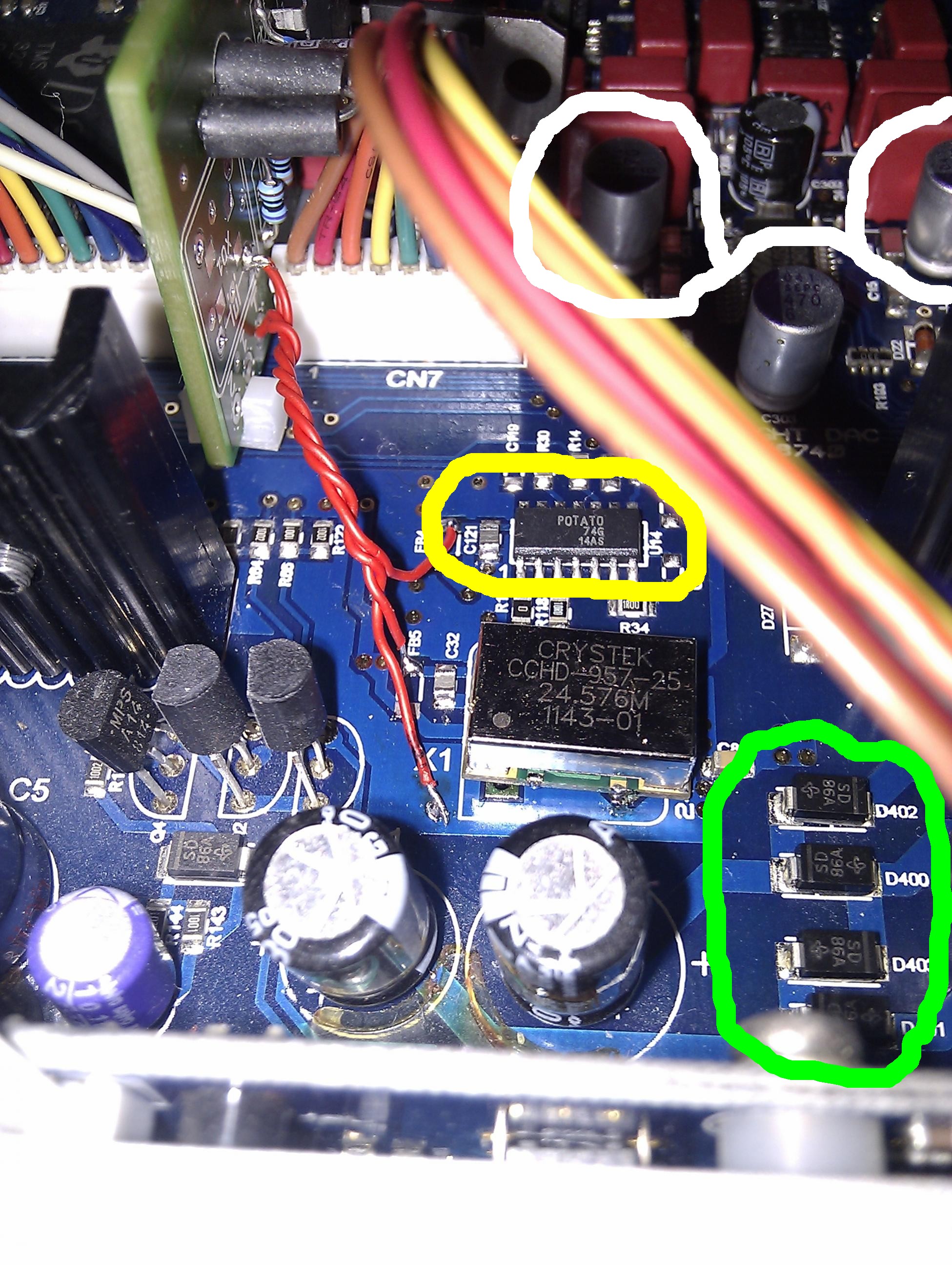

@gvelim
- you can replace regular diodes with schottky diodes (green circle)
- use SP-Cap, glue it on the top of Potato chip and connect to pins 14 in 7 (yellow circle)
- for VMIDL and VMIDR you need low leakage type capacitor and Oscon's are high leakage: http://www.saga-sanyo.co.jp/oscon/cgi-bin/e_sizecode.cgi?id=SEPC. I tried different caps there, including Nichicon KL (lowest leakage). Personally I like Panasonic FC or FM there (white circle). You should try different caps and values in this position and decide for yourself
For AD797, try to lower power supply lines to 12V to minimize power dissipation.

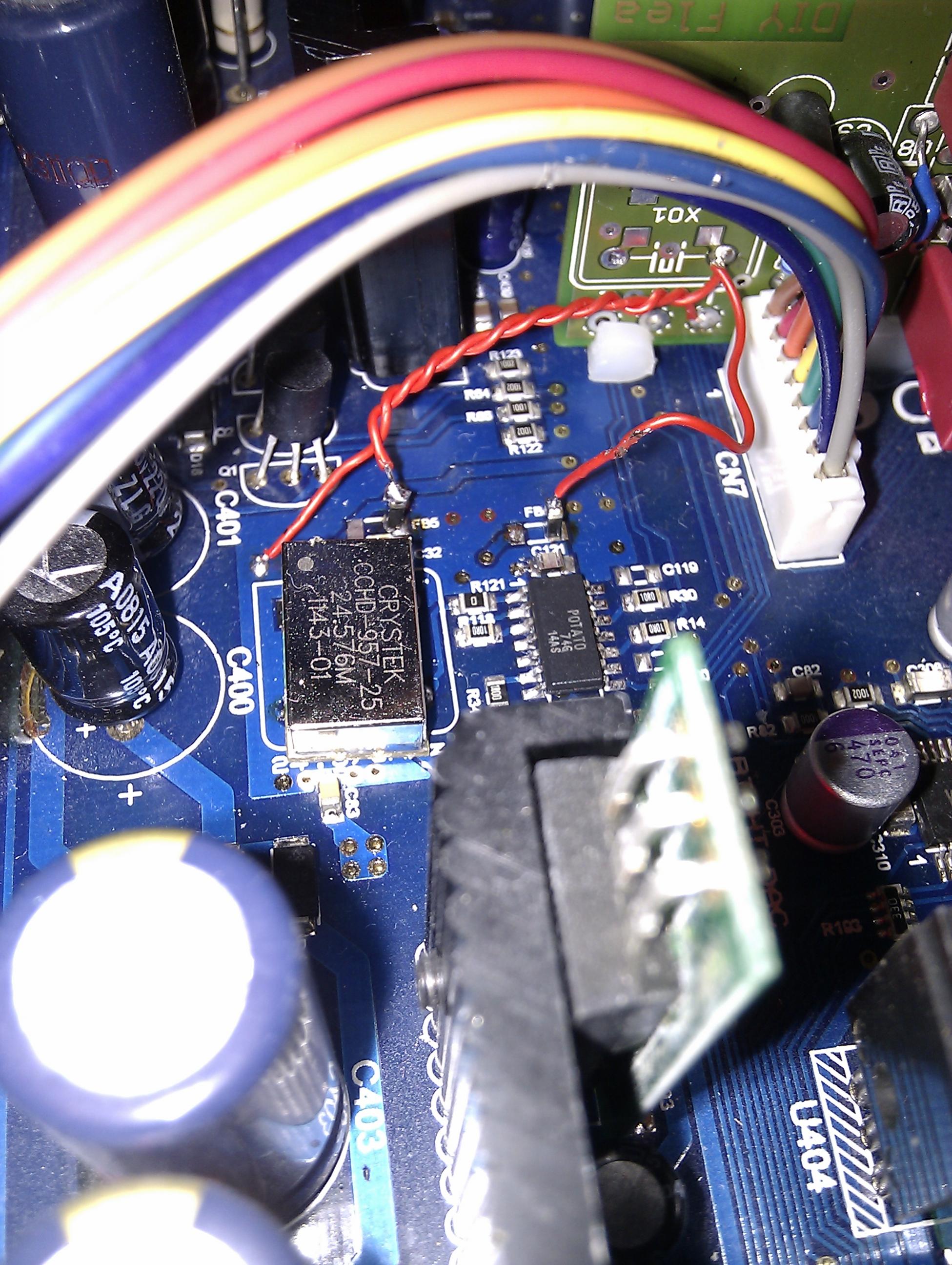

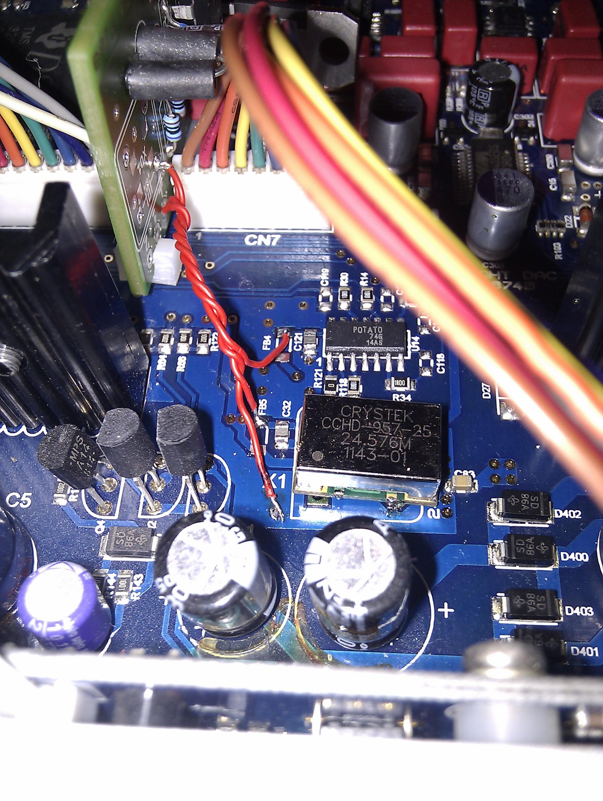

Thanks Stormsonic for the good advise, will try out the rest but AD797 since I am bit stuck on +/- 15Vdc as otherwise I have to change the SuperRegs so not sure whether I have any option here.
My last mod (flea PSU -> XO+HexInv) although it improved on bass and stage detail I noticed that caused the highs to be distorted, particularly the sound of the hi-hat was sounding muddy.
I reworked the mode to add the ferry beads which fixed the problem and made the sound pristine again, "hi hat" sounds as a "hi hat", etc. Seems some HF return spoiling something there, not sure though what happened.
I attached photos of the final change as I hope that I am done with the clock (can't get any better, or is it ?)

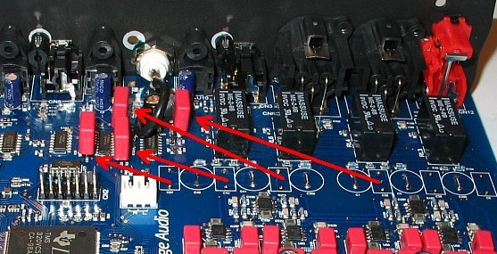

Great, you isolated chip and crystal with ferrite beads. Maybe bigger capacitor after ferrite beads (SP-Cap parallel to C32 and C121).
You can also rework digital input buffer for Coax Digital input 1 and Coax Digital input 2, but you will need 0805 SMD resistors:
R20, R22 = 4.7K
R21, R23 = 68K
R65, R86 = 2.2K
R87, R125 = 10K
While there, please remove capacitors C17 and C18, they are doing a lot of harm in this position.
If you want to improve things further, C126 and C127 should be replaced with piece of wire.
You can also move output film capacitors to new position, solder them across C12, C14, C215, C222. Recycling 😀

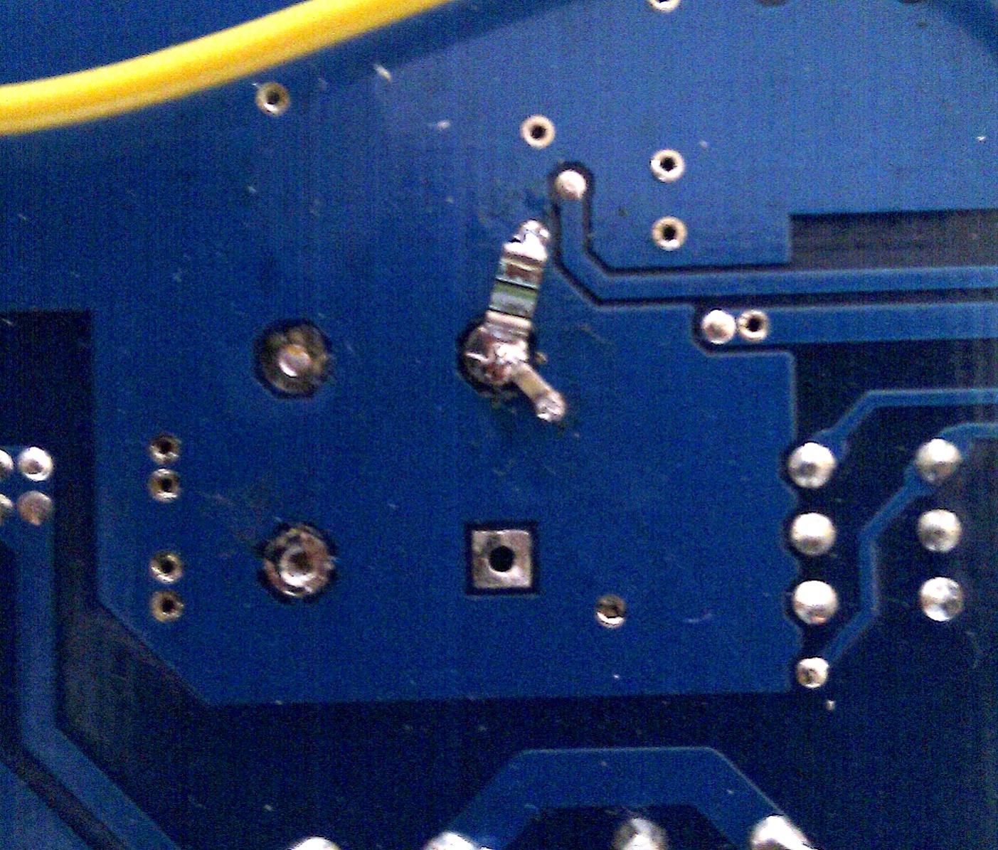

@ Stormsonic, complemented the XO PSU bypassing with a 0603/NPO 470pf and 1206/ECPU 0.15uf in addition to the 0805/ECHU 100pf and which fit very nicely in the +Vss pad and the 2 surrounding little GND holes. The compo of 0603/0805/1206 is highly recommended due to the ESL differences of the packaging.
I confirm this has positive impact to bass and stage clarity.
Changed the Diodes to Schottky however I haven't noticed any improvement with this mod.
