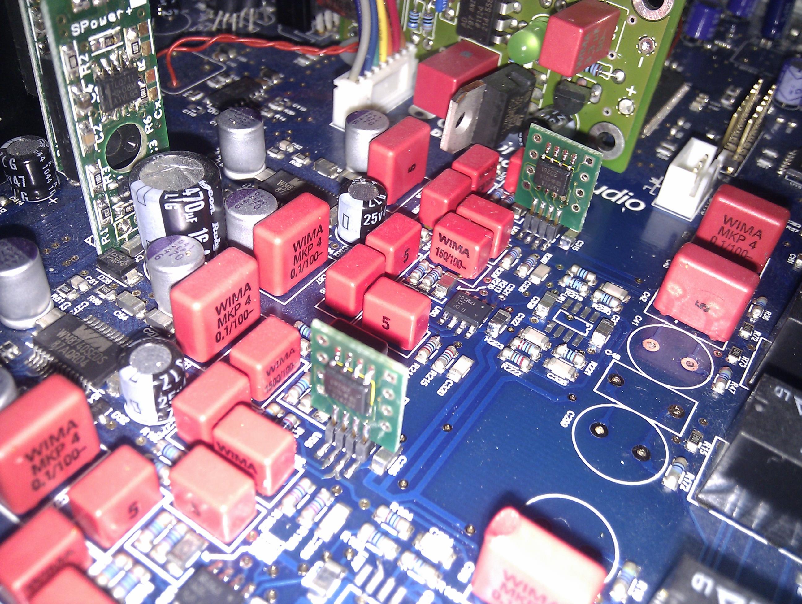

mutil-Opamps trial
Have just finished trialing a number of opamps on the XLR section of the output stage. Bare in mind I have removed the RCA section (OpAmps/Caps) from my setup.
So far and in addition to LM49720 I tried:
OPA2211 - running cool, no oscillations, after 2wks the sound was muddy, with no clarity and distorted highs.
OPA1612 - running cool, no oscillations, sound after 2wks was details but stage feels backwards and sound lucks clarity on busy passages with highs getting distorted.
ISL28118 -no oscillations, running cool, interesting low/mid end giving some nice detail however stage compressed and distorted highs.
MC33078 - this OpAmp used in the application example inside the Wolfson DAC datasheet. Didn't listen as I measured oscillations on its output; negative signal phase was oscillating but not the positive one.
AD797 -burning hot
, same stage and instrument definition as LM49720, forward sound, details are easier to listen and sound is less cluttered on busy passages than any of the above opamps.
So AD797 stays for now, and will let it burn.... literally !! is it normal to be that hot, I mean you cannot touch for more than 5''. Would this do anything ?

The AD797 runs hot on U55/U56, U58/59 position however the highs are very detailed, and music sounds much better than other opamps tried, especially complex passages in classical & rock recordings.
Also running a freq sweep from 10Hz-20Khz didn't point any oscillations when measured with my oscilloscope. I recall LM49720 was also hot but cannot recall a "burned finger".
Should I infer the AD797 is stable on this circuit topology besides running hot ?
Re: bypassing, although datasheet recommends bypassing with 0.1uf + 4.7uf, would there be an issue with only the 47nf ECHU bypass cap already in place ?

About AD 797 : Check their power absorption across R400, if any oscillation is suspected.
Like a guide line, sum the quiescent current ( from data sheet ) and see what you have with no signal ( 50% more or less should be ok ), then try with signal to see if you get an increased value across R400.
ciao.
With my R400 at 68ohm I am getting 5.86Vdc which gives me around 86mA for the 4 AD797 + 2 OPA2120 + SReg current. So assuming 16mA go to the 2 OPA + SReg then it will be 17mA for each AD797.
17mA translates to 0.5W which calculates as 86C on the packaging, which resembles reality. The datasheet reads -40 to 80C as normal operating temperature, so what should I infer ?
Since the browndog adaptors are being toasted from both sides, I have put a clip-on heat sink per channel for regulating the temperature.
Otherwise music is sweet, full in midrange and better than before, even when the LM49720s were on.
AD797 is a bad beast, looks like yours are oscillating.....
IC adaptors are very bad for stability with hight speed op-amps, no heat transfer to large cooper lines too...
The safe option is to put LM49720s back. In my opinion a couple of silmic II ( 100uf/25v ), at the output of Yours regulators, will give You sweeter HF, creamy mids and strong sub bass, like I have in my dacmagic.

I agree browndogs could be the reason for the oscillation so I am planning to fix 2 x 1206 film caps (0.1uf + 0.47uf) per rail on the adaptor to see whether this fixes the problem.
re: Silmic II, I already have super regs installed so would they still make any difference ? also where do you buy them from ?
