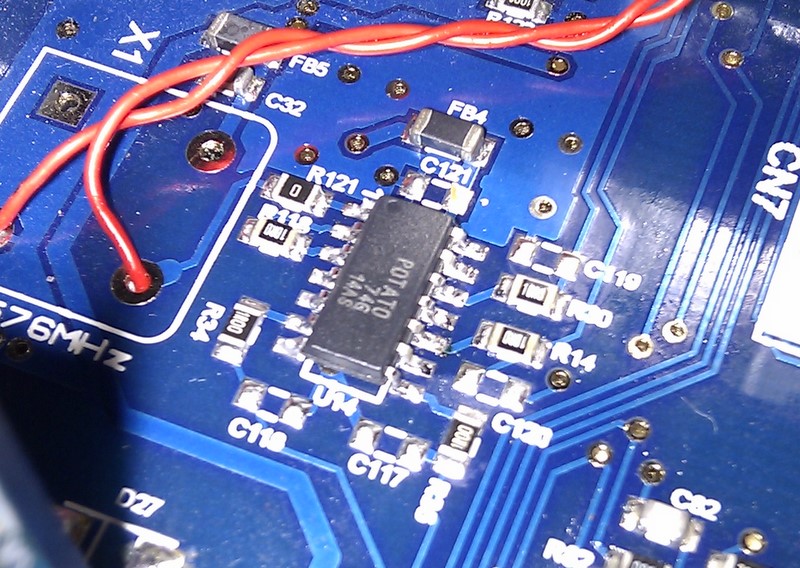

*UPDATE*

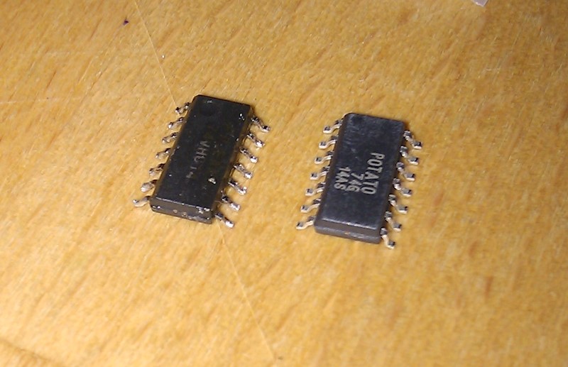

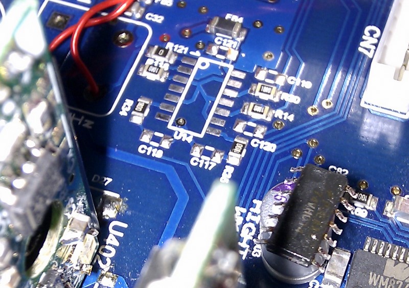

Have further worked on the clock chain and decided to replace the 74HVC14 with a higher speed / ultra low noise equivalent from Potato Semi ...
PO74G04 specs here: http://www.potatosemi.com/potatosemiweb/datasheet/PO74G04A.pdf
The mod also requires the removal of the C121 bypass cap as it affects IC noise performance.
The sound improvement is immediately noticeable especially in microdynamics/sound detail, soundstage and definition. I would definitely say PO74G04A makes the Crystek Oscillator with its -150db noise level, shine!!
re: clock PSU GND isolation, I gave up on the idea to use the digital isolator as this would definitely kill the clock quality between Crystek + PO74G04A.
PS: btw, my first SMD mod 🙂

** CORRECTION **
The bypass cap *IS* required for the IC's internal noise cancellation logic. I got confused with the another clock buffer IC.

I just bought it. Even though I saw that this one i a PO74G14A and not PO74G04A. But they are very close to each other, so I took a chance 😛
Looked closer at the datasheet. And it seems that the difference lies in the following:
Propagation delay = 5,5ns http://www.fairchildsemi.com/ds/74/74VHC14.pdf
Propagation delay = 1,8ns : http://www.potatosemi.com/datasheet/PO74G14A.pdf
Propagation delay = 1,4ns http://www.potatosemi.com/datasheet/PO74G04A.pdf

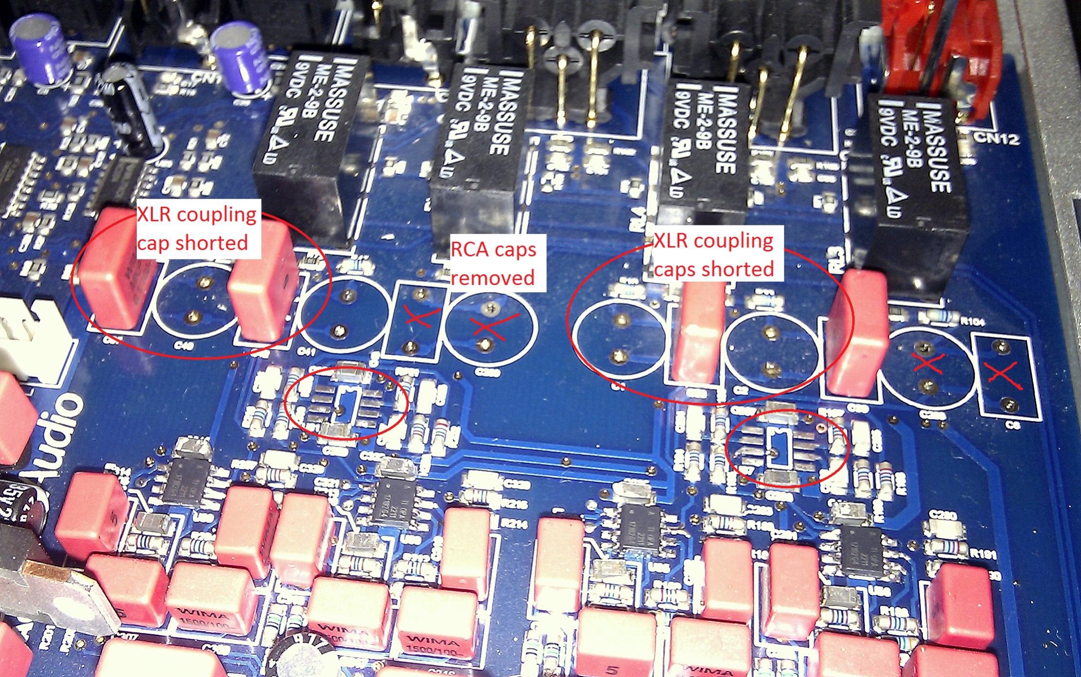

following upon earlier discussions on post-DAC stages and
1) since I am using XLR->RCA using only (R+,GND) & (L+,GND)
2) all 6 x LME49720 were getting too hot
3) had already bypassed the output coupling caps
... I decided to "disconnect" the RCA stage which was implied that increases the Diff filters' output load and subsequently influence THD distortion. Hence I removed U61/U57 and C6/C48. C293 & C299 were already removed.
I played the system with the remaining 49720s on. The sound was felt with increased detail in highs and micro-dynamics, but not a day night/difference.
Then I moved on to replace the 49720 with OPA2211. All well with the SMD job however the sound was coming out distorted on the highs. This revealed that one of the 4 opamps was baking hot. Removed and resoldered and the it was absolute fine. I played some sample tones via USB tones and I did not notice any oscillations on the output, which was quite reassuring. The opamps are running also much cooler. 😉
The sound & stage appears to be on par to 49720 however fatter on base notes... at least it is not worse to my ears, so I'll let it burn for awhile.
A big PLUS of the opamp change is that box temperature has dropped to a point that I can keep my finger on the opamps and regulators' aluminium alloy for more than 15'' without any discomfort... comparing to 5'' before that was already a painfull experience.
