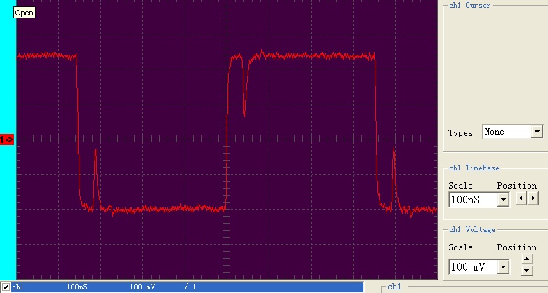

Removed C17 and C18 from digital inputs 1 and 2 (we absolutely don't need capacitance there)
removed C269 and C264, those are HF filtering caps - snip snip.

No offence taken...I know exactly what function those caps perform, they should not be there.

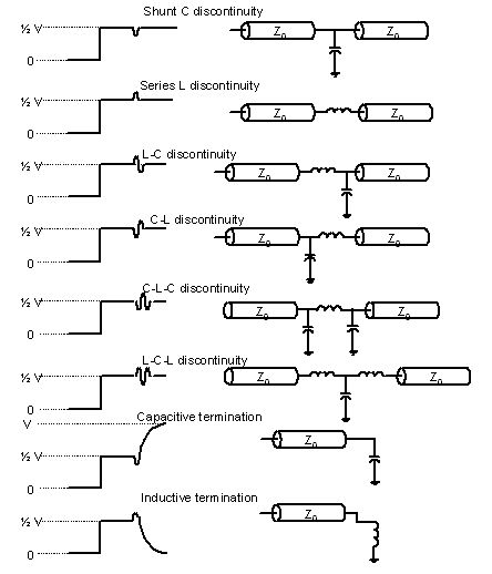

Those caps on digital inputs were probably put to filter out HF noise. Problem is that they also add to cable capacitance that would cause an "overshoot" of square digital signal.
Those caps on analog outputs were put to filter out HF noise as well, that is already done by signal processing components up the signal chain.
Why did you deem it necessary to remove these? Have you thought about what function they perform?
Take a look at the picture. They are screwing up the signal.
Interesting - is that the digital input? Do you have the before and afters? They shouldn't really be affecting the signal like that as the -3dB point is way above any SPDIF frequency, and more intended for radio and mobile phone interference suppression.

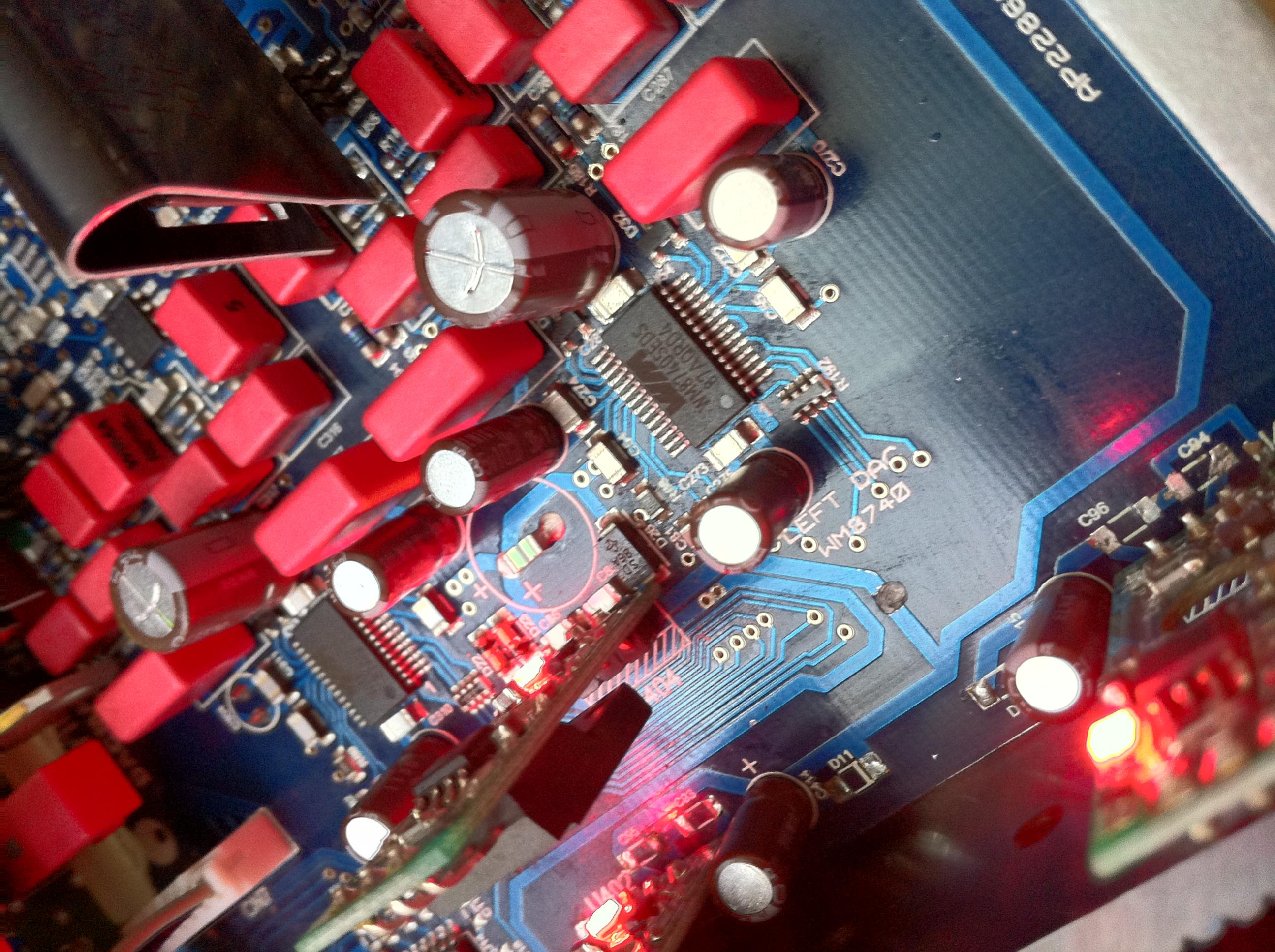

Hi - I was wondering if some of you knowledgeable guys might help me out. I've had my dacmagic a while and have been enjoying it in stock form, but after some recent successful kit builds I thought I'd give these mods a shot.
However, all is not well. It powers up ok, but changing the input (these LEDs light as normal) does not ever light up the 'signal present' LED - but what it does do is move the 'phase' LED randomly.
Cannot figure out what could have caused this...
I've -
1. Snipped away the forest of ariels beneath the board, just above the solder.
2. Bypassed the output caps.
3. Replaced 275 and 303 with 22uF Oscons
4. Replaced 302 and 271 with 33uF Elnas
5. A 10uF tantalum bypass across 419
6. Replaced 414 and 415 with 10uF tantalum
.. and I though that would do fine for me. But now I get the weird light show, and no signal out. Does anyone have any idea what I've messed up?
Note, the rear of 302 has slightly messy soldering now. But I don't think I've shorted anything together.
For troubleshooting, I have a multimeter, no scope. And no idea. lol

There doesn't appear to be anything in your list that would specifically cause the problem you're seeing. Without a scope it might be difficult to diagnose though.
None of your changes should have affected the digital supply, so I would now probably look for any loose bits of wire or balls of solder that may have made their way towards the DSP or SPDIF receiver.

You need to get a scope, even digital (like owon pd series) would work for you. I suspect that "slightly messy soldering" might be the problem. Use isopropyl alcohol and a firm brush for "moping up".
Not sure 414 415 tantalum is a good choice there, I would put them in 426 431 and use larger electrolytics for 414 415. If you are concerned with regulator noise you could additionally bypass C96, C95 with small ero or wima.
Tantalums sometimes are perfect for digital circuitry, I would avoid them in analog, even if it is for supply filtering only.
Thanks for the advice guys. I had sprayed and scrubbed the board around my soldering, but didn't think of the problems my pruning might have caused - so I soaked it in isoproply alcohol and did a thorough scrub and was rewarded with some wayward silver specs at the bottom of the tub after.
Input selection and signal sensing is now back, so the unit is working again. Phase selection still rolls with input - but then phase can be altered after as normal - so I'm not too worried about this.
As for the sound - I rolled some amp tubes while the DAC was down, and this might be having a larger effect. I'll have to wait for the new tubes to burn in, then reverse that change, to gauge the DAC results fairly. Thanks all.
