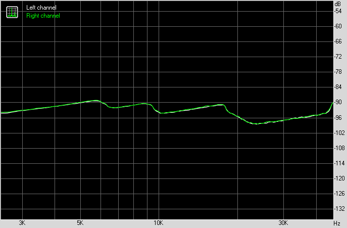

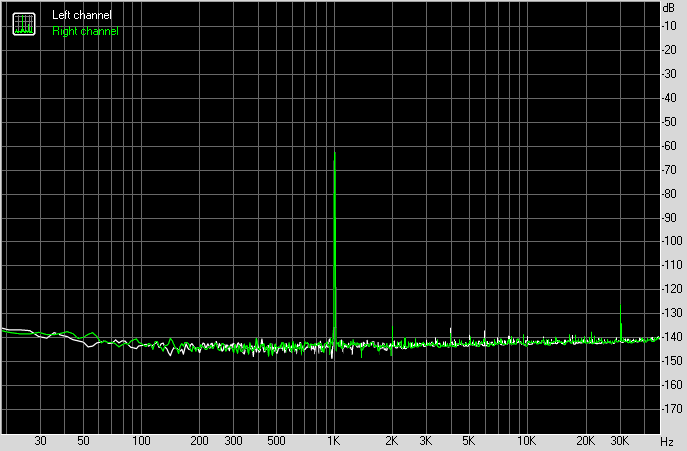

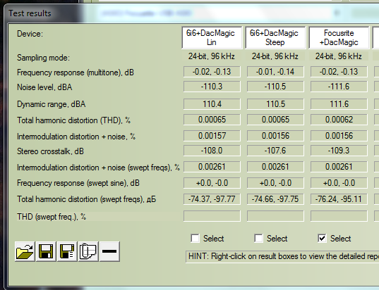

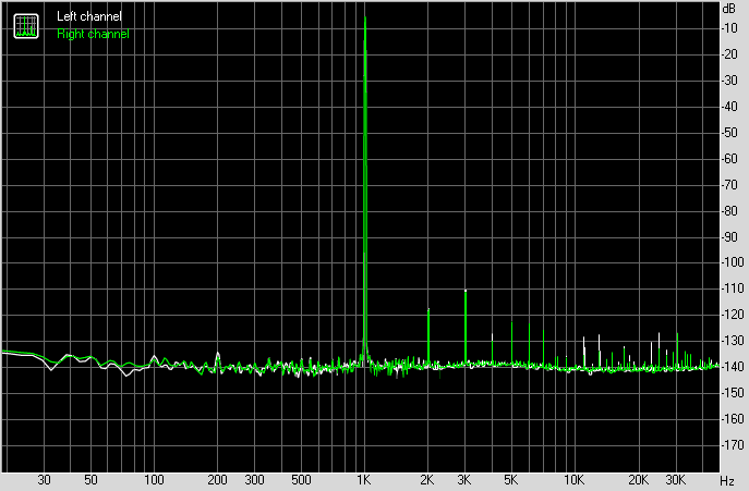

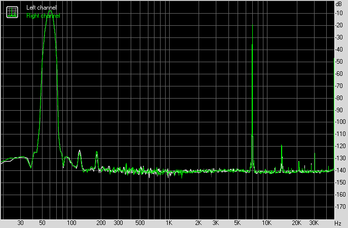

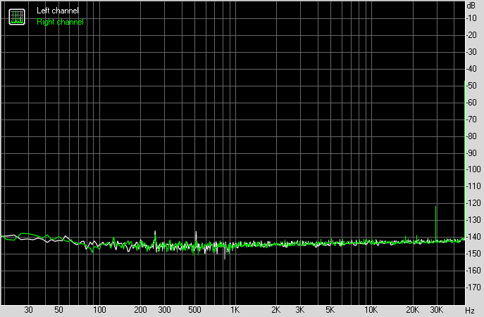

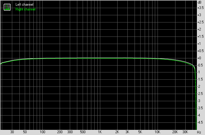

some RMAA results with my modded DacMagic througt a Focusrite 6i6 interface ( digital out > line in ) : 🙂

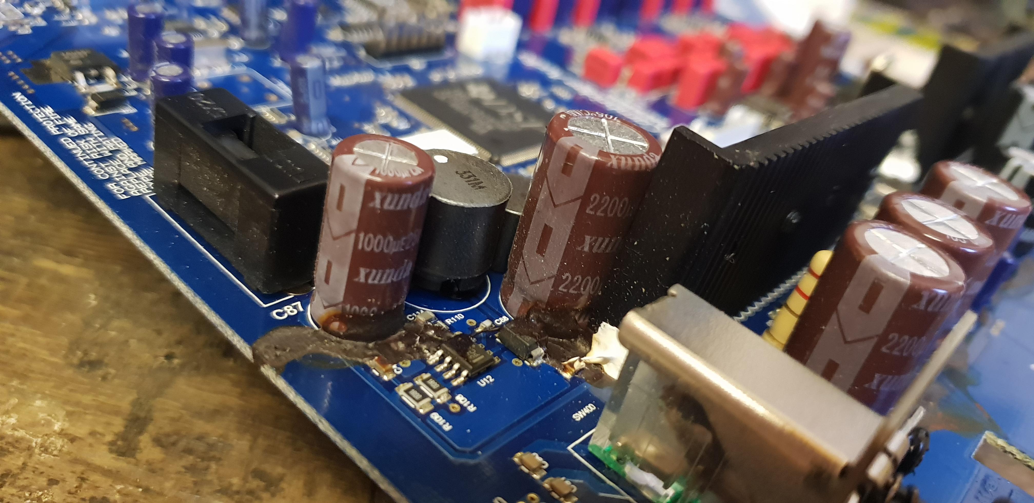

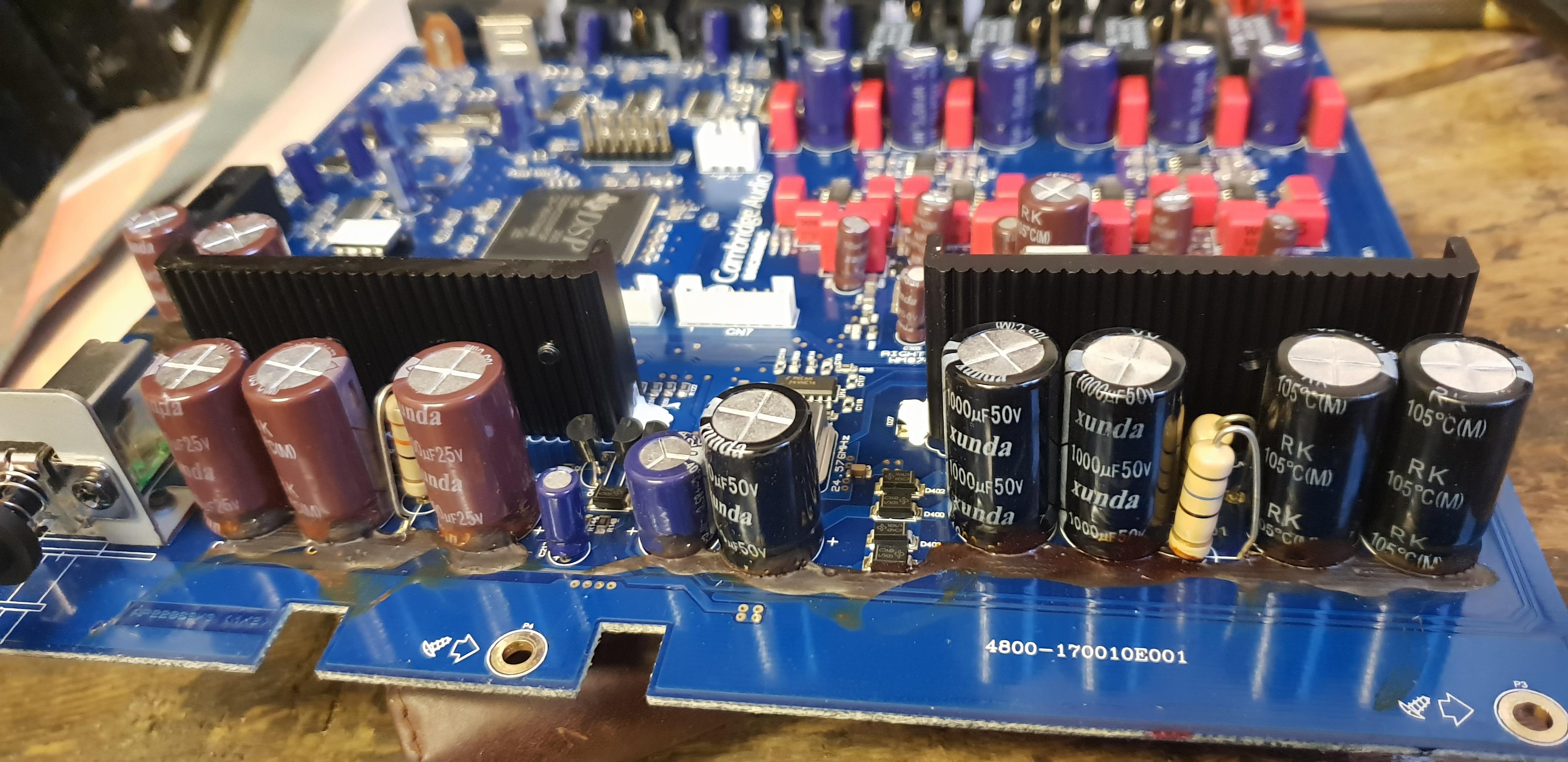

Finally got in the thing.
I take it these caps are leaking?!🙂
All seem to be the Xunda brand that have let go. Still seems to work and sound nice. But hopefully this means my mods will make great gains in SQ!
attachment.php
Yes, flexible and cheap construction adhesive. This is necessary on tall, leaded components to ensure reliable operation after the likely vibration and rough handling during assembly, transport, warehousing etc. I doubt leaking electrolyte would ever look or feel so much like this hasty squirt and smear from a glue gun anyway.
