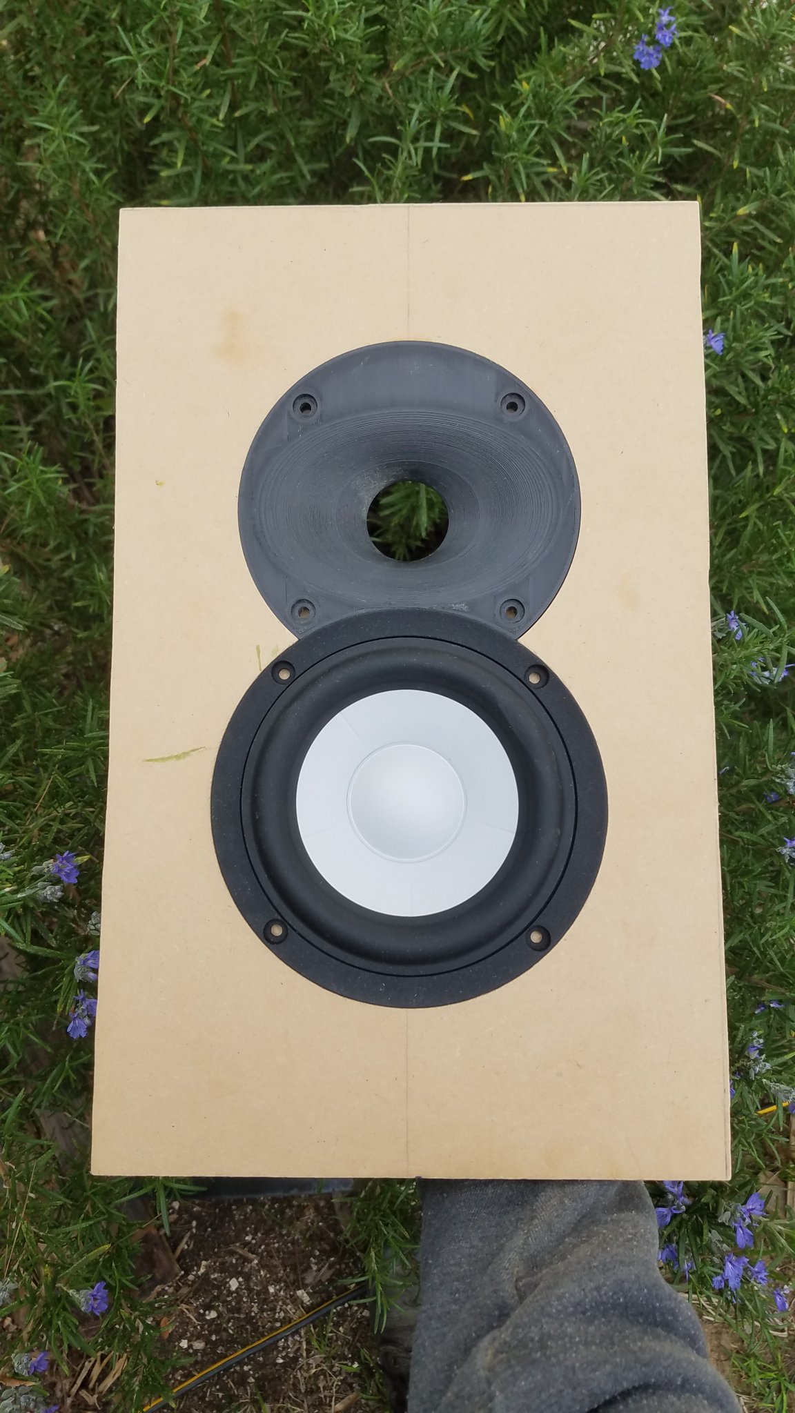

I'm using a 6" (6.78" with the driver flange) with the T25B and MW16TX, and it integrates really well. I'll do one for the T34B also. Since my goal is matching directivity and acoustic center for the intended woofers (nominal 6.5"), I don't design around the aesthetic aspect. You start giving up too much utility.

Brandon. Is it possible to obtain real 6.5" Waveguide for Bliesma T34B? I've downloaded file "6.5x1.1 83 A T34 v2 stl.zip" but unfortunately it's 7.28" waveguide 🙁
You may consider doing something like what I did to get a true 6.5in from the elliptic waveguide. I changed the outer to a circle so that I could route easier and mate as close as possible to my midrange driver. iirc I took the 5in and set my outer to 5.25in, could have easily done 5in.

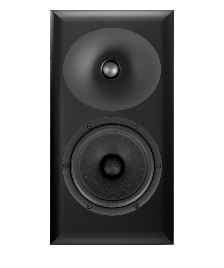

Unfortunately I'm visualizer. And what's worse, speakers have to be accepted by my wife too because speakers will be installed in our sitting-room. I'm thinking about carving your "6.5x1.1 83 A T34 v2" waveguide directly in MDF. It looks good on visualization if driver flange is removed. But I don't know if carpenter will be able to do it on CNC machine using stl/step file. I have to ask him.

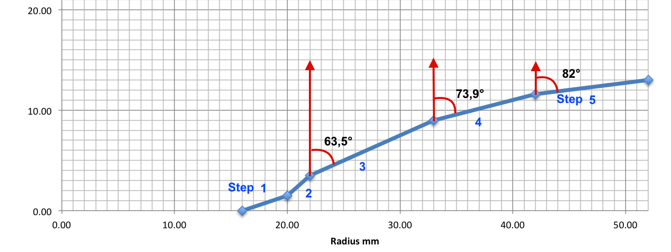

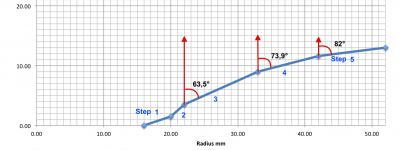

I remember this has been asked before in this thread, but may I once again kindly ask for DXT stepped waveguide simulation and experiments? More practical information provided by member Gaga here:https://www.diyaudio.com/community/threads/dxt-wave-guide-dimensions.334739/
Is the drawing in that post accurate? I could try to make that and see how it measures. You probably won't have much luck simulating a fabric ring radiator, but I do have a Scanspeak ring radiator on hand to measure.
I take it the drawing below is accurate, but do not have the exact opening size for the the XT at hand (some 32 mm??). If you could brew someting on the basis of the Scan Ringradiator diaphragm size , I 'd be very,very grateful Santa Brandon...

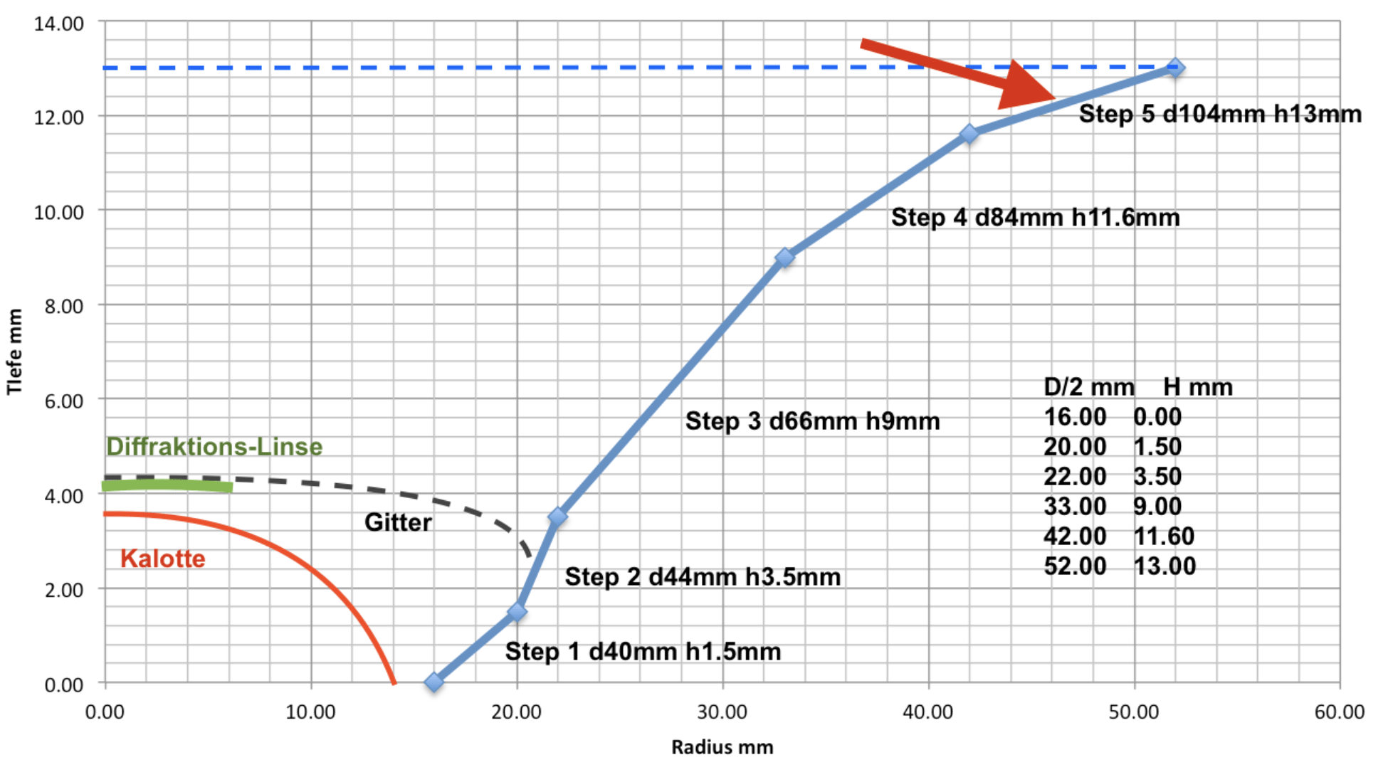

For your convenience the numbers used for the xls-figure:
D/2 = half diameter
H = height
Same numbers as applied for the xls figure you posted above with adjutsed x- and y- axis values.
Please note that the DXT waveguide has been optimized fot the applied dome tweeter (see impact of step 1 on the directivity here).
Using the Vifa XT25 ringradiator for the DXT-profile might change the directivity at high freququnecies. Might be seen by a respective simulation and adaptd accordingly. You'll be on the safe side if you use the dome tweeter used by seas (information available somewhere, just don't have it at hands actually).
Good luck and please post the results in case you proceed with the project....
