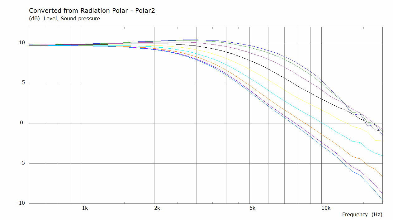

This looks like a pretty great match to me, the fall off at HF and further off axis is the ring radiator

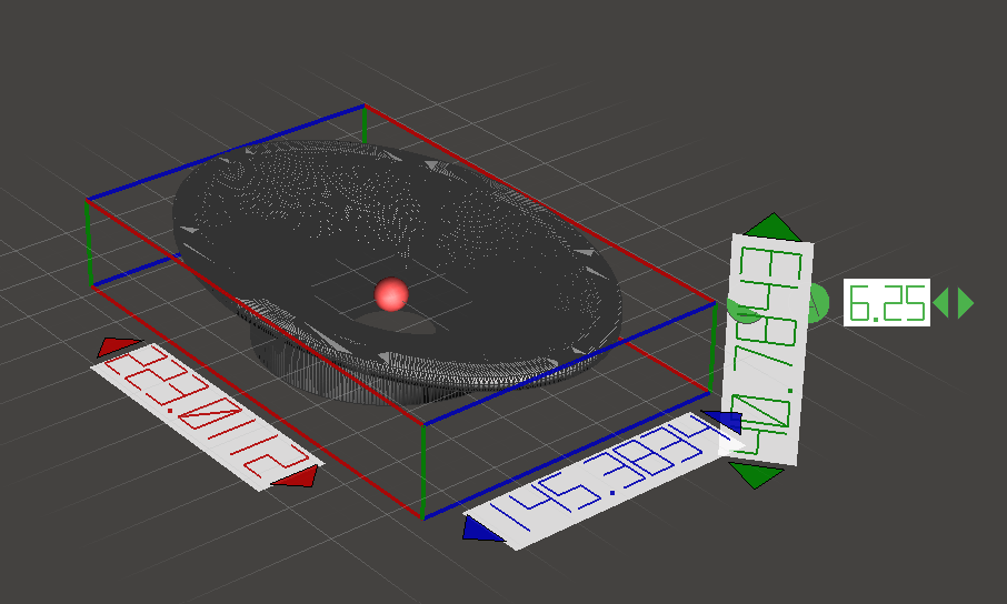

The dimensions for the STL are in inches not cm or mm, you need to specify that somewhere
JLCPCB does not allow you to specify units and expects mm's.

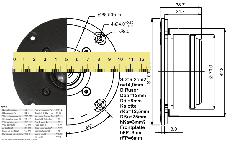

When modelling a tweeter in a waveguide, how does one map the geometry of the tweeter diaphragm and surround? My understanding is that the shape of the dome and surround is pretty critical to the performance of the waveguide.
I am asking as a complete novice.

Once I scale the original (which is some small mm's) by 2540% I get a waveguide 172.2mm x 114mm x 26ish mmJLCPCB does not allow you to specify units and expects mm's.

Yes, the geometry of the tweeter diaphragm and surround is rather critical and the waveguide throat should be adjusted/designed accordingy.
I did quite some simulations using the SB26ADC. To map the dimesions I took data from the datasheet given by the manufacturer (link). In order to confirm and add missing values, I bought the driver and performe mesurements indicated in the thread here (merged an image taken from the driver with the datasheet drawing):
Hope this help...

Odd that they don't let you choose somewhere but I suppose there are less people using imperial units in 3D printing.JLCPCB does not allow you to specify units and expects mm's.
I have attached the RST28 file in a metric size, for anyone who has Fusion 360 open a blank metric project, insert the STL as a mesh and choose inch units on import. Save the mesh in the project and it is now metric.

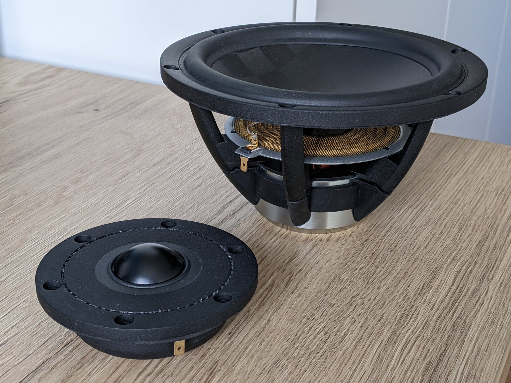

I'm planning to build a two-way with Satori MW19TX woofer and BlieSMa T34A tweeter.
I would like to reuse the T34B elliptical 6.5" waveguide, but hesitant because the domes are shaped different. And earlier tests with T25A in T25B waveguide showed issues at higher frequencies.
My question:
What would it take to adapt the T34B waveguide to better match the T34A tweeter?
Happy to assist with measuring and testing, if that helps!

The T34A is really quite different to the T34B and does not react that well to waveguides that try and gain directivity lower in frequency. The best I have found through simulating the profile is for it to be about 6mm deep with a simple radius profile. It is a better match for slightly smaller drivers though.My question:
I still have to try Pida's waveguide with the profile changed to match the diameter of the T34A, the extra 1mm gap of the original caused a lot of cancellation in the simulations. jcga printed a simple adapter for the T25B I designed for him to get a better directivity match with the M74B mid dome and it was pretty close to the simulation.
fluid> what software are you using for simulation? How are determining the dimensions of the domes?
