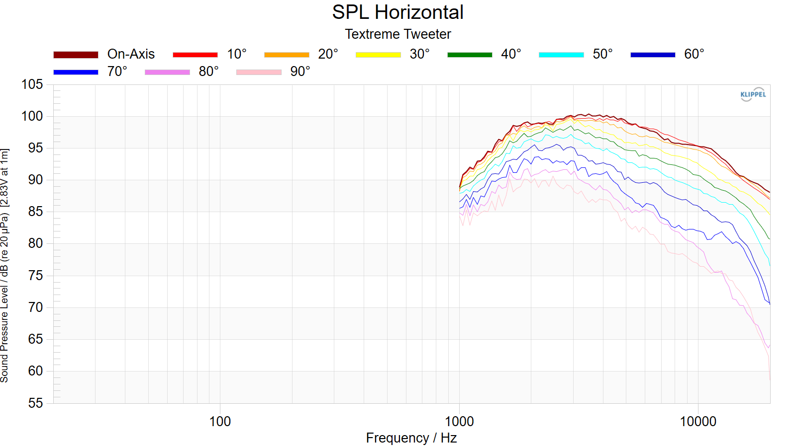

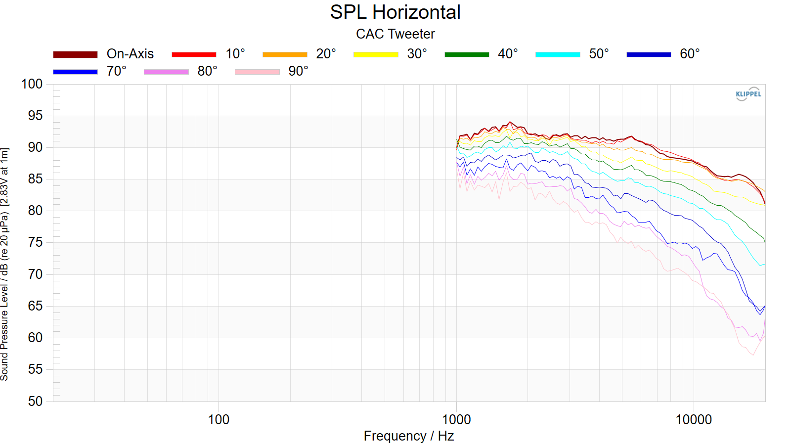

PS: the predicted DI of my waveguide in-box you posted is not what the actual result would be. Here is a Klippel measurement, although I didn't generate the DI from it, you can see it would be quite smooth:
I thinks it's a matter of implémentation, as in the version I modify, it's just a implementation modification, the WG is the same (so thanks to you ^^).

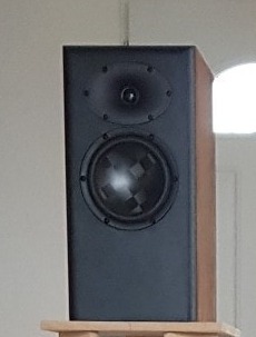

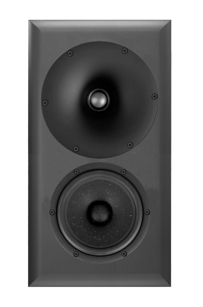

The in-box implementation was this, it's not a predicted one, it's a real measurement and use of Vituix CAD :
It's not mine but it's representative of regular implementation of Somasonus that we see on Facebook groups, there is even a little round on the box, not bad.
oh good ! Do you have a picture ?
It's all a mater of continuous curve, be careful it should be on all part of the WG implementation, hard to explain but if you mentally cut your implementation on this diagonal axis it should be continuous too.
And if you measure it in (all degrees) diagonal axis it will be visible (and reflected by wall, in room).
It's a radiation divergence due to mouth diffraction, it's why my implementation look like this ^^, with a good roundover on a square box it's good to have a rectangle mouth for midrange narrowing/beaming.

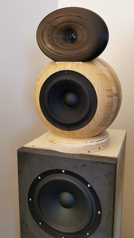

But I like the final result of my bullet lol, it's all in one 😆, and for Azno, with Ikea bol, the elliptic mouth form in "bullet" is better anyway
Ok, here are the 8" waveguides for the T34B. Also included a new 6.5" elliptical mouth with a higher aspect ration (1:.83). Also included a new 6" elliptical waveguide for the T25B (used my new family of speakers). I've decided to revisit the circular mouth on the SB26 family. The first is a 6.5" model, and it looks good, I'll move on to the other sizes when I have time. I've updated my website to include the new designs.

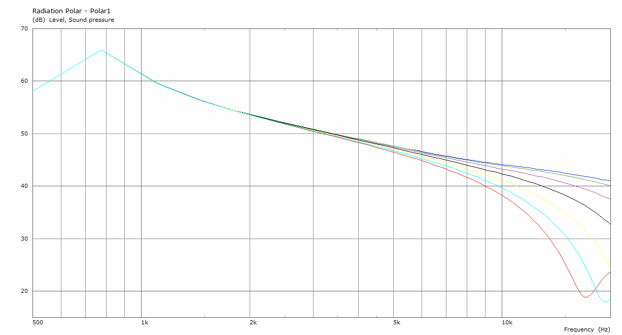

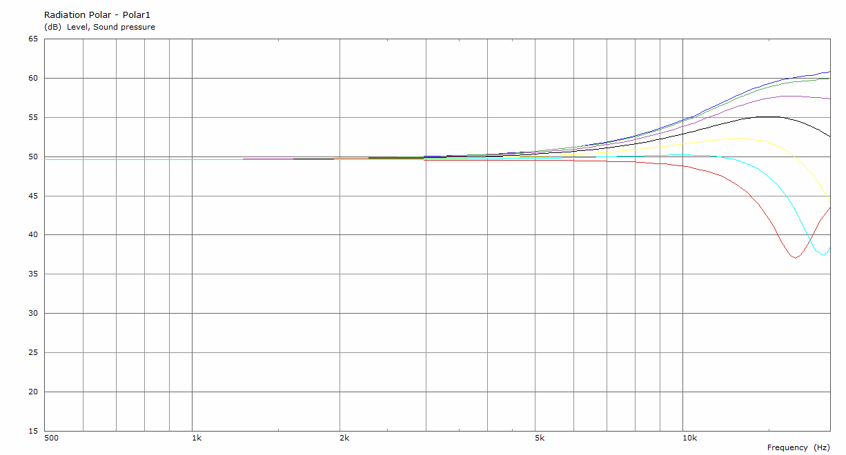

I'm trying to simulate some waveguides with Akabak, following the YT tutorial by Austin. I think my BEM work is OK as the normalized results tend to be very similar to what @Gaga and Brandon have achieved, but the unnormalized results never seem to match so I guess I'm doing something wrong with the LEM part.
Here's the SB26 in an infinite baffle (no wg for simplicity), first with a source directly routed to a radiator linked to the BEM driver and then with a source-resistance-elecdyndriver-radiator model, the elec-dyn driver being grounded, enclosured and filled with SB26 T/S parameters. Comparing the results to those of Gaga here it seems like I should achieve something between my results 😅 Any ideas?

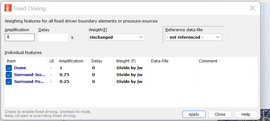

The manual says
LE Diaphragm Parameters
Dome Tweeter​
The dome-tweeter is usually modeled with the front diaphragm only. The rear of the dome is regarded as part of the speaker and its effects are part of the TS-parameters (see also component Speaker).
So I would take out the enclosure and just fill in the Elec-Dyn Driver parts.
Simulating with constant acceleration is usually good enough when you are really looking at the directivity of the diaphragm and waveguide.
AKABAK defaults to constant velocity so it needs to be changed to have a falling not rising response.
This what I have been using to simulate Dome tweeters with constant acceleration.
Different amplification for the different parts and weight as Divide by jw.
Reactions: jaakkopetteri
Thanks! I seem to be unable to assign fixed driving no matter how I try to unreference the feature from any LE stuff. But I removed the enclosure and switched the radiator reference to the lumped Elec-Dyn driver instead of the BEM driver and now things seem in line with Gaga's results, at least for the infinite baffle version. FWIW I'm not trying to simulate only the directivity, but also the frequency response

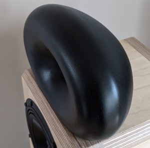

Which plunge router can take a 1.25" or 1.5" round-over bit? Which one do you use?
My old Bosch fixed-base handles a 1.375" (35mm) roundover when the plastic base is removed from the metal frame. The bit vendor was adamant about not running it beyond 8000 rpm and chamfering the work piece beforehand to reduce the material removed, both of which were useful tips. Even then watching the edge carbide flying by the base opening a quarter inch away (6.35 mm for y'all what ain't got Freedom Units) was a sobering experience - definitely a time for triple-checking the chuck was tight.
This profile piqued my interest: the initial radius is quite large so the initial standing wave diffuses cleanly and the radius tightens the further you get from the front panel, but it's okay since less energy is going all the way around to the side of the box. In theory, anyway. Of course you avoid laying down a bead at the front edge -- that would be silly.
Plus, tbh, the profile is prettier than a straight roundover.

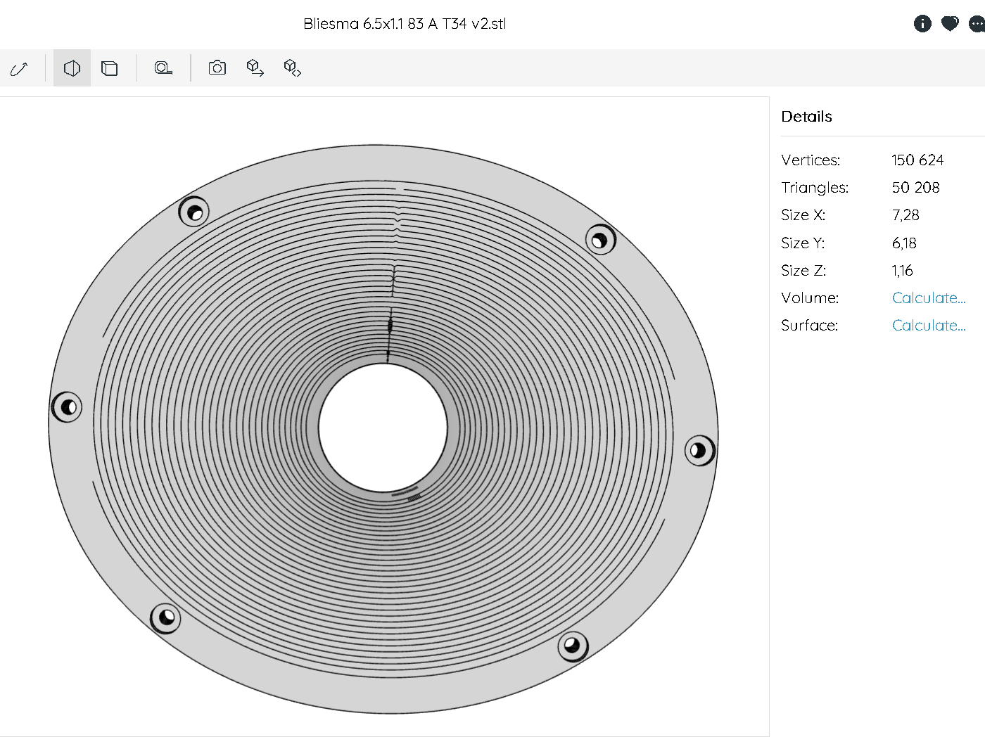

Brandon. Is it possible to obtain real 6.5" Waveguide for Bliesma T34B? I've downloaded file "6.5x1.1 83 A T34 v2 stl.zip" but unfortunately it's 7.28" waveguide 🙁
Ehh, Eltomassito you scared me. I've bought Satori MW16P and Bliesma T34B and was planning to build speakers with 6.5 circular waveguide. I was simulating layout in this post #1101. But I was sure that external width is exactly 6.5". Now you make me aware that my layout will looks like much more ridiculous than I thought and I must abandon my plans 🙁
