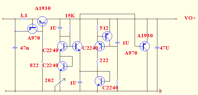

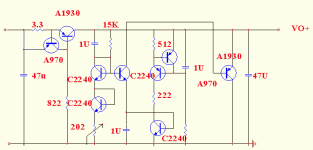

My friend compared the audio-gd shunt with LifePO4 on another ES9023 based on Hiface interface, the difference is like a tube vs SS amplifier, shunt bring in warmth without losing any detail.
Will be interesting to compare SQ between Salas shunt and LiFePO4 🙂
Alex

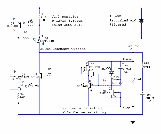

I think one of the benefit of shunt regulator is ultra low impedances comparing to battery. The noise level at 5V is around 30nV according to the Salas shunt forum. With CCS in series, it has very good PSRR as well.
Trident shunt in Buffalo DAC uses the shunt part only without a CCS with good result, now it's a standard in Buffalo III.
Shunt Regulation - diyAudio
I also attached the salas shunt I am using with common mode cap multiplier at the front.
I've always wondered about shunts. Do they work because they have low output impedances to the load? Personally I believe it might be because they only draw DC from the PCU, not signal correlated current.
I definitely second this idea. :yes:
Shunts also allow for hi-impedance between raw PSU and load. I guess the best possible PSU should be made with a simple series CCS (a couple of cascoded depletion MOSFETs...) followed by something like a Salas shunt reg (in parallel with a good and properly dimensioned by-pass C, too!).
The series CCS will completely decouple the load from the raw PSU and force the load AC currents circuit to entirely close within a short, local loop. With only DC currents on ground and supply lines (outside of the local loop).
Every single load in any audio-related circuit should be powered this way! :smash:
Of course also low impedance on the load side is a good thing (and a good regulator is usually better than a naked battery WRT this parameter). But that's not an exclusive feature of shunt regs. Good series regs may also sport very low output impedances...
BTW: regardless of the type and technology used, IMO the regulator "bandwidth" - that is it's ability to remain stable and keep the supply line clean WRT high freq. components of the load current - is paramount.
For instance, many (most?) integrated regulators which use op-amps and lot of NFB shows great numbers "@DC" but actually have a very limited bandwidth. As soon as the frequency rise, their characteristics (output impedance, etc) decay dramatically. IMO, such kind of regulators are basically useless if not detrimental (that's why I prefer simple circuits...).

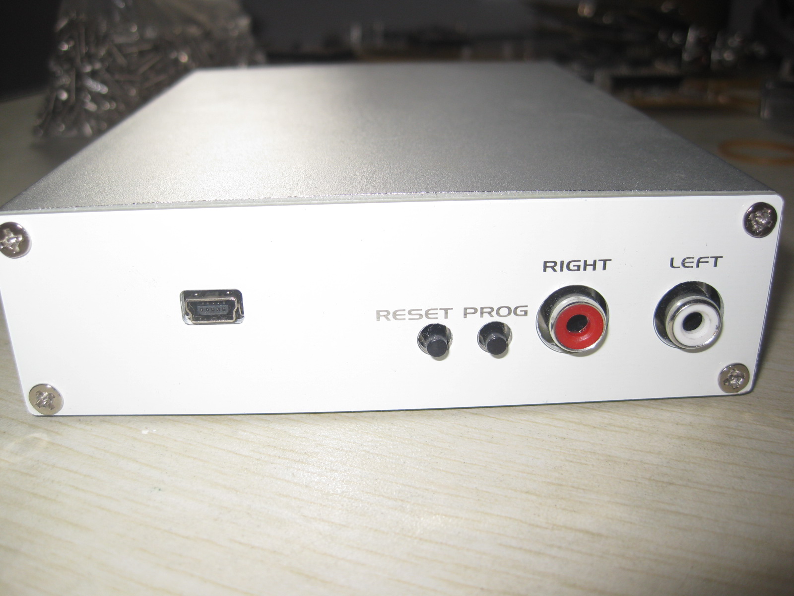

Hi Alex,
Have a look at this picture. When I had the boards made, the USB-I2S module popped out of the void. The outer size of the void is 71x62mm. Minus the 15x15 rectangle. Even outside this area it is possible to expand the opening. The height inside the box is 29mm.
Børge

Hi Borge,
Does the enclosure have enough space to fit the Salas shunt in? Will need to drill another hole in your enclosure for the +9V DC in though 🙂
Alex
