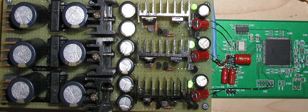

the perhaps easiest way to get galvanic isolation in my latest hardware is to insert optocouplers between the USB-I2S module and the Analog Board it sits on.
To everyone who is new to this project: AB-1.1 is split in two parts. One is a digital module with all the hard-to-solder stuff. It has connectors for USB, I2S and lots of other IO.
The other board is purely for analog things; clocks, power, DAC and audio connectors. We encourage analog hackers to toy with the analog board. Optocouplers and non-VBUS PSU are just some out of many options.

Hi guys,
I agree with Alex, isolating the MCLK is not good jitter-wise. The crystal oscillator and its power supply are IMHO the _most_ important analog component. The analog core of clock, DAC and filters must be made together without any noise sources.
But the digital core with MCU and USB interface may very well be isolated from the analog core. One opto isolator option could send MCLK in one direction and remaining I2S lines the other way.
In our AB-1.1 design the DAC is MCLK master and the MCU is MCLK slave and I2S master.
absolutely... :nod:
is there any chance this solution will be included in a future release of AB?

Salas shunt
Now it's not portable anymore. I also powered the MCU with shunt, a bit softer sound.
