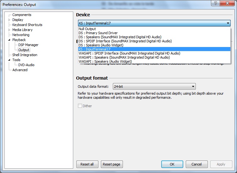

Anyway, latest Pureplay(2.7.1) works with AW in WASAPI mode now(W7 with thesycon 1.18), the best player I've tried (prefer over stealthplayer now).
Has anyone tried AW with KS mode under foobar, sounds better than WASAPI, is there anyway to change the device name, any other speical setting?
