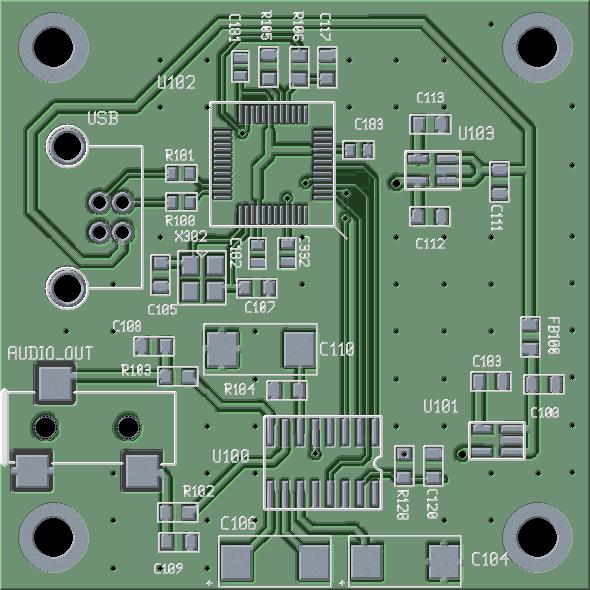

Tenor 7022L + ES9023 MiniDAC
I don't think either the AB-1.1 or my USB9023 would be a low cost fit to your hpa design. However, I was bored a few weeks ago and turned out quick board, 5cm x 5cm, using the Tenor 7022L and the ES9023 DAC. (I have attached a rendering of the pcb) I expect the circuit boards to arrive this week and will see this layout sounds.
The layout is standalone but there would be no problem adapting the design to take the supply from your HPA and feed the audio back to you.
Regards
George Boudreau
Yoyodyne Consulting
