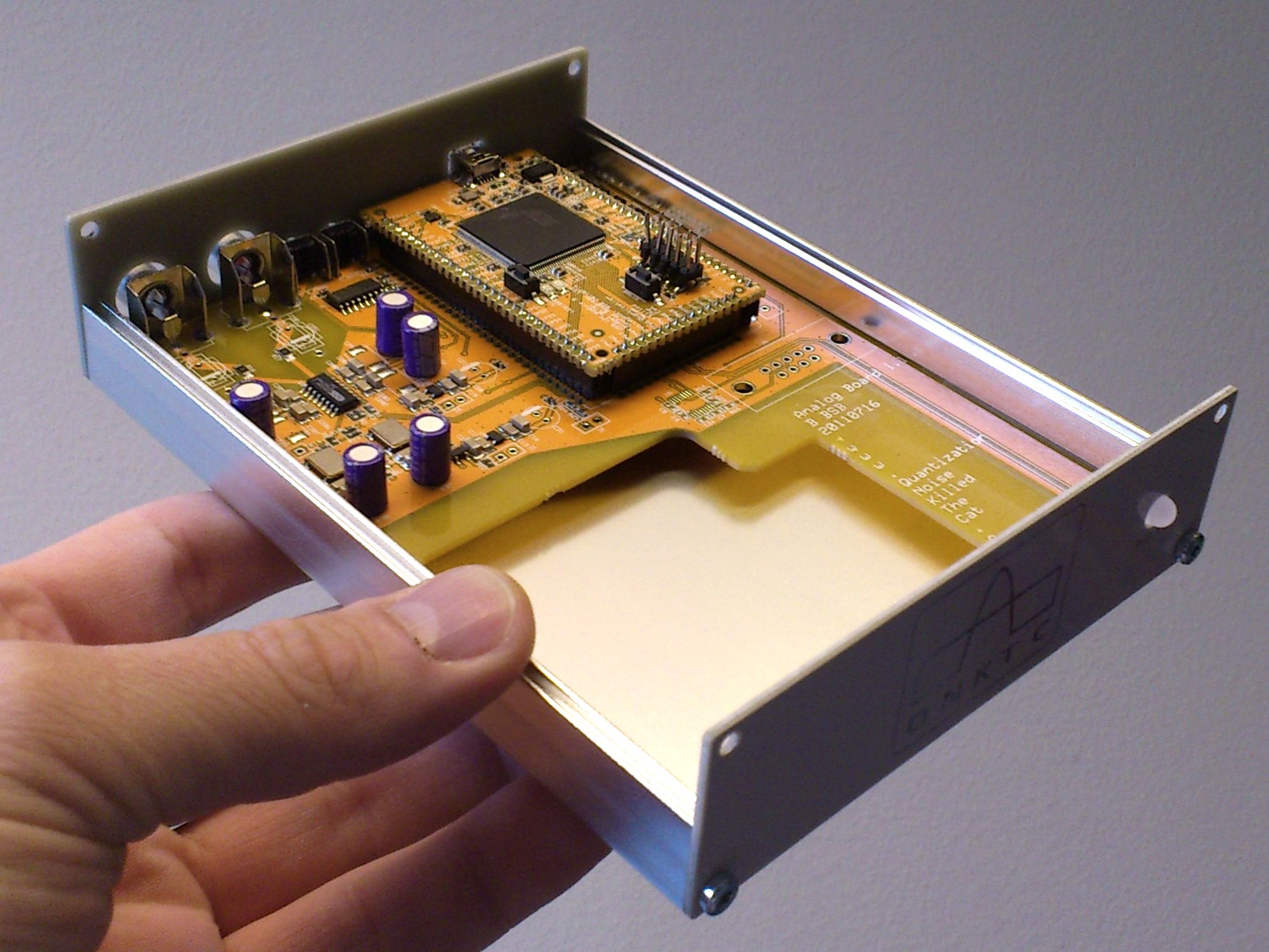

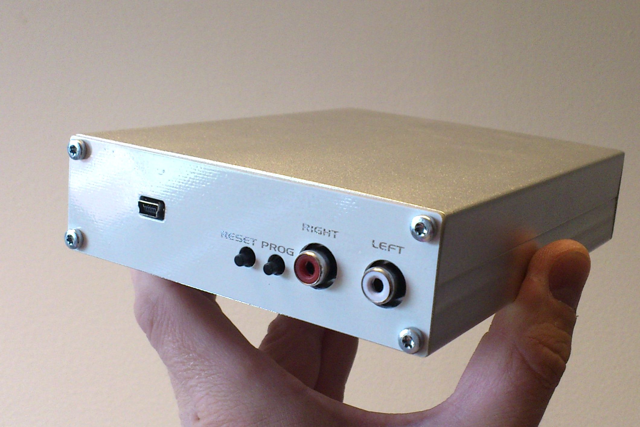

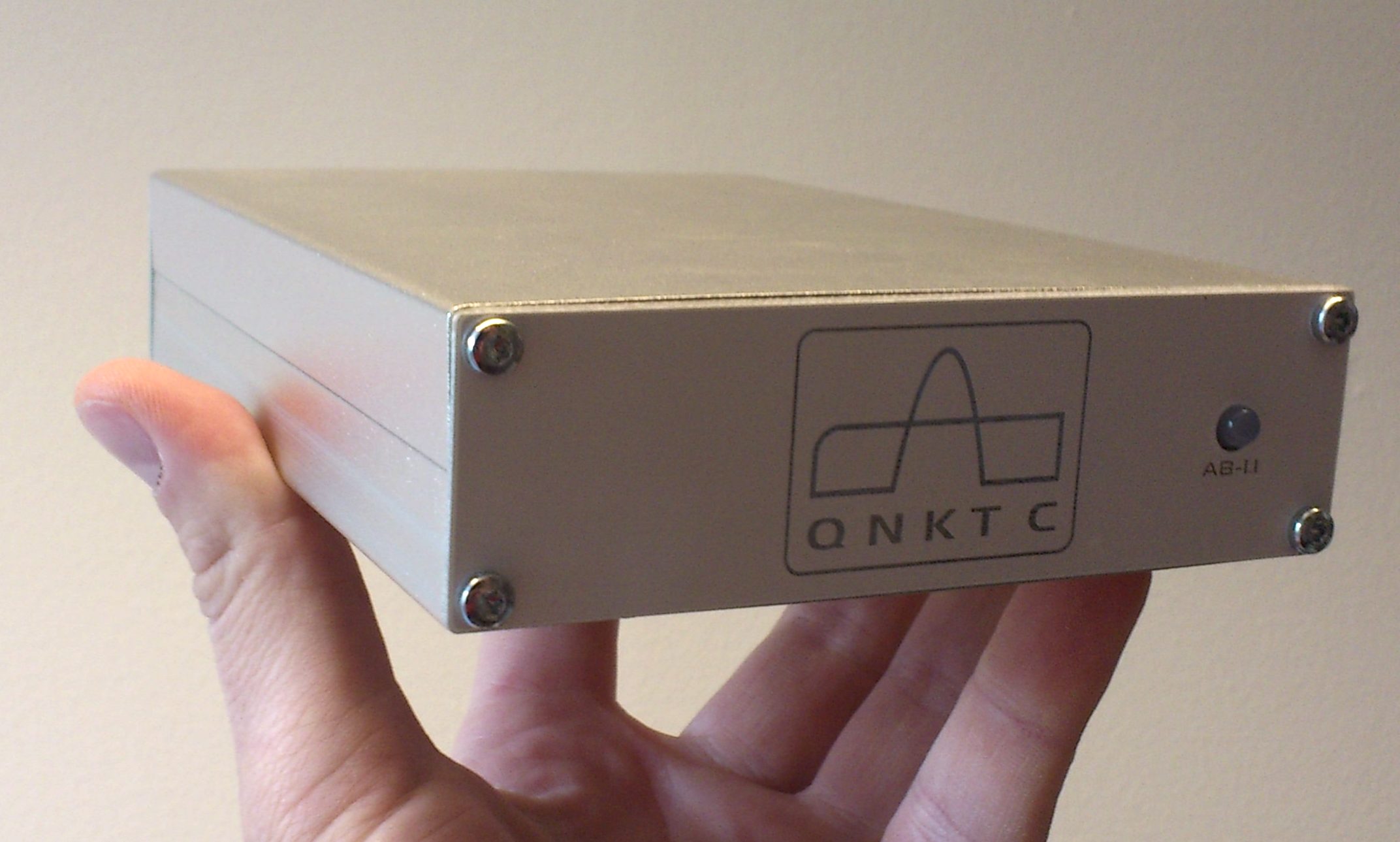

Hardware available now
Hi guys,
the full batch of AB-1.1 boards just arrived with me. That means I'll start shipping out complete units very soon, probably Monday. Here are some pictures.
I'll install a firmware image which is performing well with UAC1 (44.1 and 48) on Windows. UAC2 (44.1-192 on Linux and Mac) is in the image, but you'll need drivers and the WidgetConfig program to set it. Join the sdr-widget and audio-widget mailing lists for details.
The price is still $120 plus shipping 🙂 ($31 international, $18 Europe)
