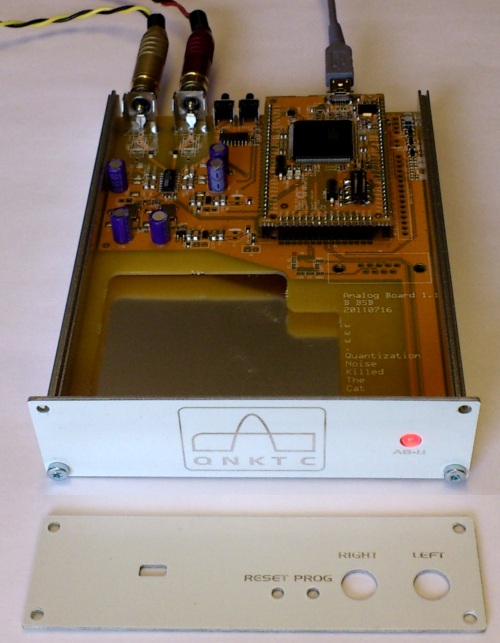

New hardware: AB-1.1
Hi guys,
Finally, the first 10 working AB-1.1 units have arrived with me. More
are on their way. Pictures and schematics are attached.
The boards have been tested with 24bit 44.1 and 48ksps asynchronous USB audio on driverless Win7/64. The boards will do 24bit 176.4 and 192ksps on Linux (native) and Mac (native) and Windows (experimental drivers).
So what sets this kit apart from the existing AB-1?
* It now comes in a pretty case. It even has a nice logo on it 🙂
* There are OS-CONs at important power loads.
* The DAC is now ES9023.
* There are headers to easily put in alternative power supplies.
* The front has a programmable R+G LED.
* Output filter caps not mounted, feel free to experiment with your own!
* Clocks have much improved MUXing, power and layout.
AB-1.1 uses Golledge precision XOs for good clock quality.
I'm _almost_ ready to ship them out. Unfortunately, my design for the
rear panel was a bit off. I'm redesigning it now for a better fit. It
will probably be a couple weeks before the rear panel and remaining
kits arrive. Let me know if you want to start playing with it ASAP,
and I'll send the rear panel when they arrive with me.
In the meantime, don't hesitate to place your orders! The price is
still USD120 + shipping. With a tracking number shipping is USD63(52)
international(Europe). Without a tracking number it is 14(9). Please
paypal to borge.strand@gmail.com.
USB-I2S module only is USD70 plus shipping. For each AB-1 you may have
bought from me before there is a USD30 discount.
Børge

Looks great!
What players can you use for 192k? Does it get messed up with pulseaudio on a normal ubuntu box?
Thanks!
I've used various players on Windows, little experience with the various Linux solutions out there. Playing Wimp with one of them right now 🙂
Børge
Børge
On Linux u need to set up pulseaudio properly if u want 192khz/24 playback. Setup .pulse/daemon.conf correctly.
you can use any playback program that is compatible with alsa, pulse, or jack. Banshee works. But the best sound quality comes from MPD.
Alex

I'm sorry if this has been mentioned earlier, but can we get the DAC without the pretty casing?
Nick
Nick
Sure Nick.
Actually, you can have one of the initial kits where the back cover doesn't quite fit. I don't save much by skipping the box, but you can have the assembled and tested boards for $115 plus shipping.
Børge
Børge
Thanks for the prompt reply!
I was actually hoping to save on shipping cost by buying the DAC without the case.
Any idea how much the shipping cost would be if we drop the case?
Regards
Nick
Regards
Nick
