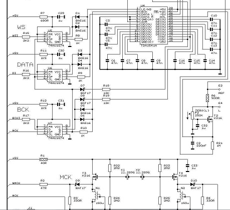

Audio-widget is using dual rate XO (22.5792/24.576M) to feed ES9023 directly, with FF to feed 1/2 rate clock to Atmel chip. I am wondering if it worth to use higher rate XO 45.1584/49.152M, with lower jitter FF (SN74AUP1G7) to get 1/4 clock.
Best solution, I believe, is a local clock at the DAC synchronised back to the transport
I guess the I2S output from Atmel is not 100% aligned with the XO clock, so it may benefit by reclocking them using idea from John's design at "ultimate TDA1541 DAC", maybe ES9023 has similar function built in already.
