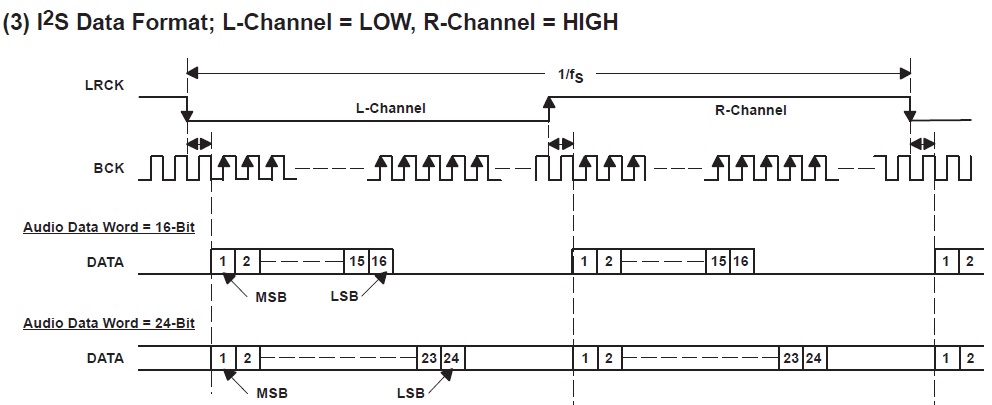

Hi 2A3SET,
All the ADC and DAC we are interested in with the USB-I2S module are 24 bit or 32 bit capable devices. It is technically possible to have a version of the firmware to support 16 bit I2S, but we have no plans to use any 16 bit ADC/DAC's 🙂
To play back 16bit music, the PC host software should be able to convert the samples to 24 bit easily, with dithering and/or other noise shaping techniques to reduce quantization error. The resulting quality of music should be better than playback on a 16bit DAC.
Alex

zero padding/shift 16 bit to 24 bit
I am not impressed with external upconverting+oversampling (still stick with NOS DAC). Most of DAC chip these days has oversampling built in already for jitter reduction like ES90xx.
I assume the MCU is generating standard I2S data format (64 bits left+right total with 0 padding) since DIF pin in ES9022/3(audio-widget design) is grounded. Can I just do a simple zero padding 16bit WAV file to 24 bit to let the MCU play 16 bit audio correctly?

To increase the number of bits, just zero-pad. Dithering must be used when you reduce the number of bits in use.

Borge has designed the USB-I2S module for this purpose 🙂
U can mate the middle with a DAC of yout own liking and design !!!
As Borge mentioned, u can just pad zeros to 16 bit sources to make up 24 bits.

Come to think of it, 16 bit DAC's might just ignore the extra bits even with the USB-i2S module sending out 24 bits - so no firmware mods needed. This is bacause the i2s protocol has the MSB coming out first 🙂
It then boils down to whether the DAC can take the high SCLK freq used to clock up to 32 bit data. In the module, for 48khz sampling, the SCLK or SICk is at 6.144mhz. At 96/192 kHz sampling the SICK is at 12.288Mhz.

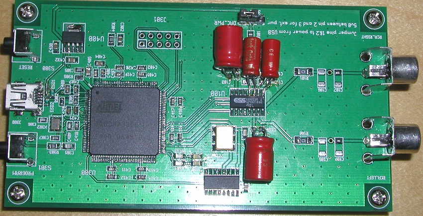

Audio-widget with Black Gate capacitor
Audio-widget with UAC2 driver runs pretty good, a big step up from UAC1 with same 16/44.1 material. Very interesting, even with async mode under windows 7 comparison between the minimalist(andy) audio player and foobar player showed minimalist better, it shares same quality of sound with ecasound under ubuntu studio.
I just upgraded the capacitors around ES9023 to BlackGate N, first tried the VREG (10u) and Pump capacitor (4.7u) to bring SQ to a higher level with silk smooth sound and quieter background, then the bypass for 3.3V (10u) and -3V (4.7u) of ES9023. The onboard regulator ADP-151 sounds pretty good already, although personally I think it worth a try to replace it with Salas shunt (run as external modules). Anyway I am still pretty happy runing with USB bus power so far.
