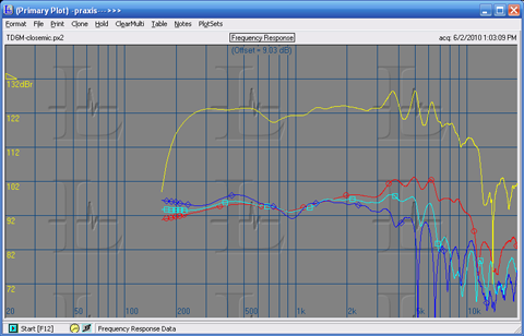

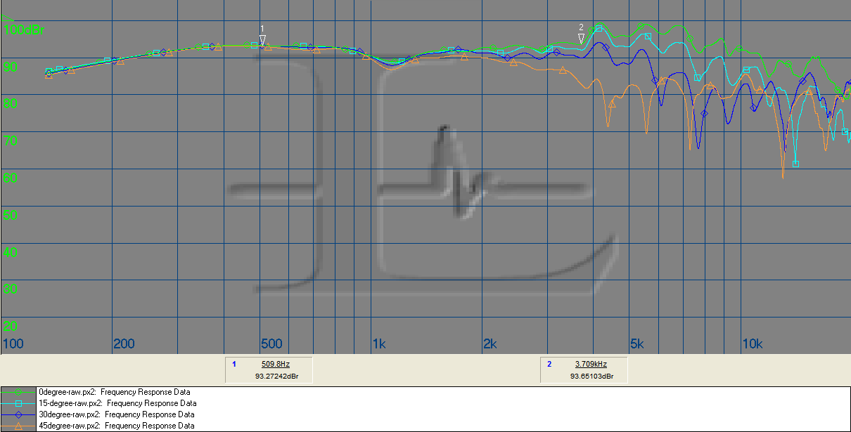

AE TD6M reportedly has some unusual dip around 900-1K Hz range, AE stock FR pic shows some dip in that area but apparently people are experiencing even deeper dip, looks like there are some fixes around this but not sure if this changes things or not.

About that dip around 700Hz, spider/frame reflections was suspected. I wouldn't trust Cousin Billy's sorbothane result too much though...
Most likely measuring a 6" driver with large plug at 3" distance is the main reason for the bad dip in first link. Even plug shape makes differences! Still, there is dip even in AE's owm data. This is partly compensated with typical baffle step hump.
Notice the difference in response nearfield (yellow)/1m (red)! TD6M - the Lambda Series Little Brother - AE Speakers

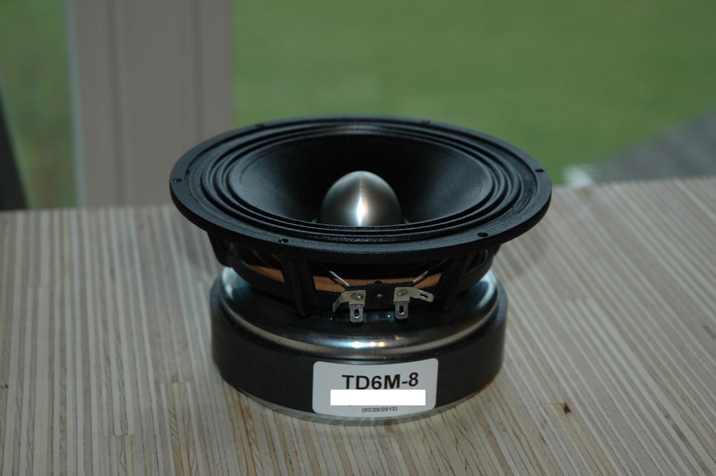

I did some research on the TD6M, if the dip is caused by basket (or frame) as AE and some other users claimed (pic 1), all the measurements including the one I posted in #125 and Juhazi in #129 is from the old basket, the old basket had 6 pols (or legs or posts...) connecting the magnet to front part and the new one has 4 with slightly different shape (pic 2). so hoping that was it, but weirdly there are no reports or feedback for newer basket since. if we don't hear back from AE, we may have to look for another mid. what is the minimum sensitivity required for the mid to go with TD15X (if) ?

In different posts and forums AE claims that the dip issue was from the cab and not the driver same as mbrennwa suggested, and they said that they couldn't measure the dip in their test baffle.
